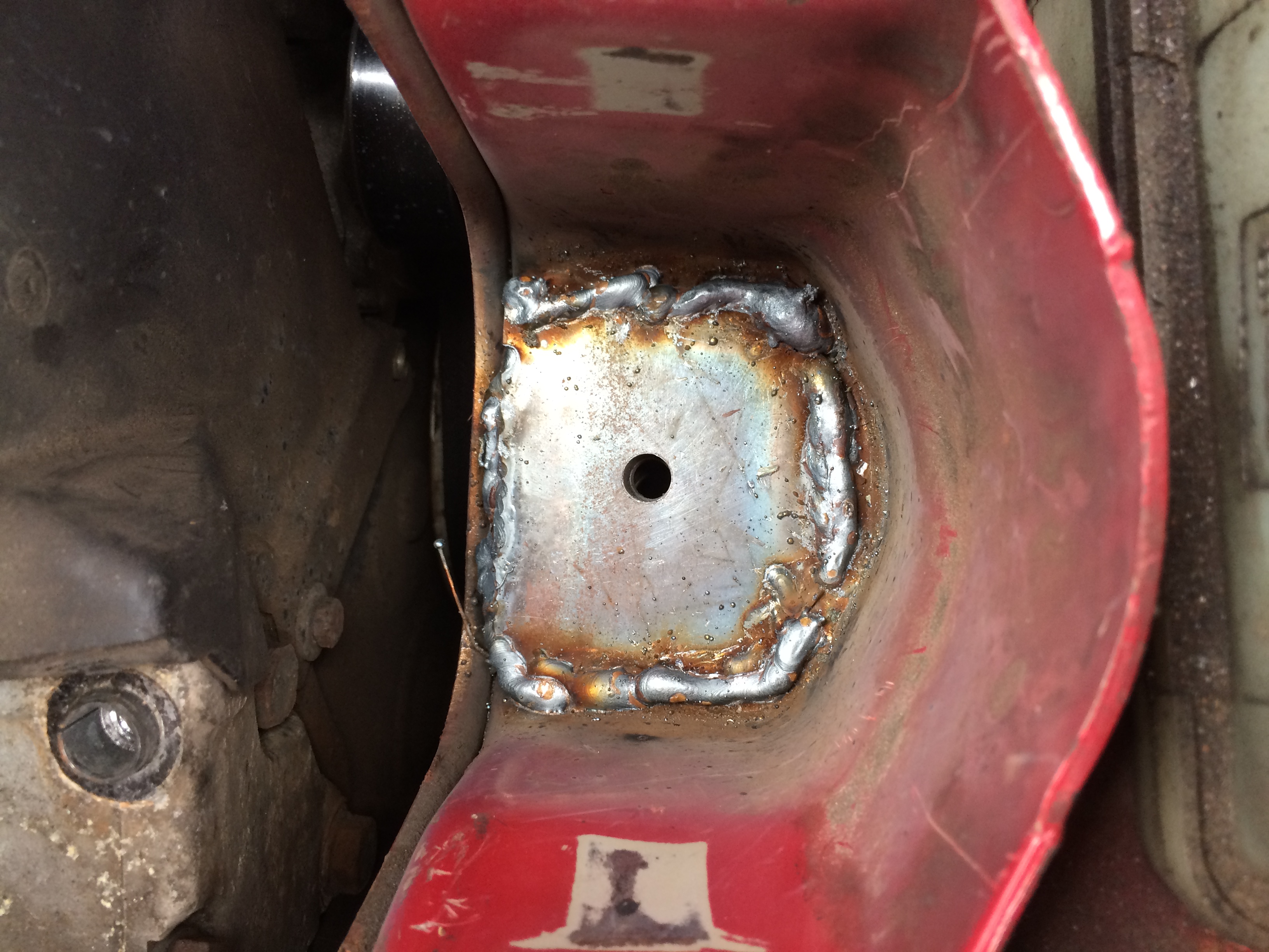

Whilst having use of the college workshop facilities that I'm allowed to use along side my course I thought I would change the drivers side engine mount, removed the cylinder head bracket and everything in the way and it just came out in my hand.. Ended up having to weld in a new plate. Was
Not expecting that. Didn't need to patch up what was was there, just welded the nut a peice of 6mm thick plate cut to the outline of the mounting housing and welded that in place and used that as a new skin. Much stronger than what was already there 3 hour job providing you have everything you need there with you
And here is when I finished
Attached Files Thumbnail(s)

Can't believe Peugeot designed something that would hold the weight of an engine and used only 1mm think steel, no wonder it fractured Smile
I had this problem too. Fixed with a steel plate welded in just the same Smile Was perfect after that.

in design it was fine.. the issue was with fatigue over 15 years,
to my knowledge none of these happened on new cars or to a point after.. and were a result of repeated use, corrosion and water deposition
the weight of the engine is supported by the subframe side mounts and torque mount on the gearbox, the top mount was merely a torque control mount to stop the engine rotating forward and back.
interestingly the engine on the vitara did not have this on the XUD but I suppose the mounting of the gearbox and lower mounts was enough to deal with the torsional stresses imposed when accelerating and decelerating.
