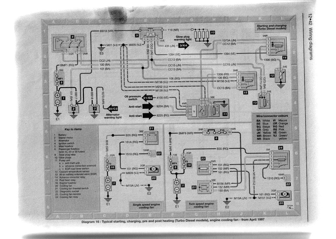

Hey, does anyone know the pin out for the 3 pin temp sensor in the rad please?
Want to wire my slim line fans to cone on without switch and I've removed the original loom.
Thanks in advance

Single speed (2 pin switch) or twin speed (3 pin switch)?
Single speed:
Pin 1 = +12v feed
Pin 3 = Fan output
Twin speed:
Pin 1 = +12v feed
Pin 2 = High speed fan output
Pin 3 = Slow speed fan output
That's going by the post-97 306 Haynes manual (see attached)

(09-05-2016, 03:09 PM)powerandtorque Wrote: Single speed (2 pin switch) or twin speed (3 pin switch)?
Single speed:
Pin 1 = +12v feed
Pin 3 = Fan output
Twin speed:
Pin 1 = +12v feed
