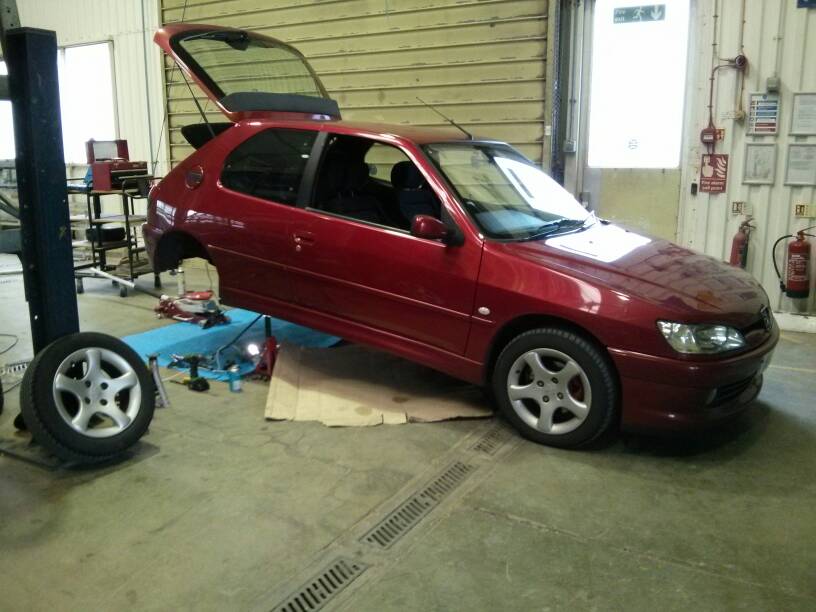

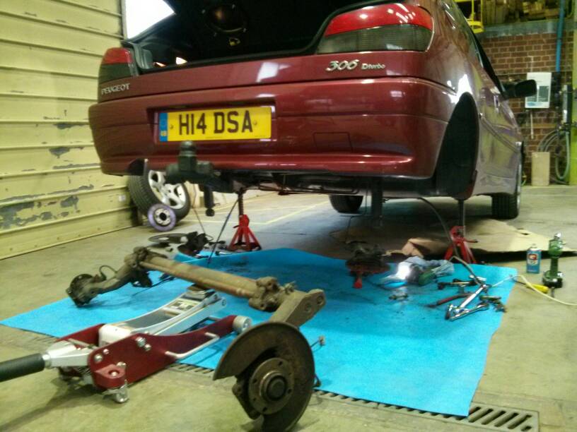

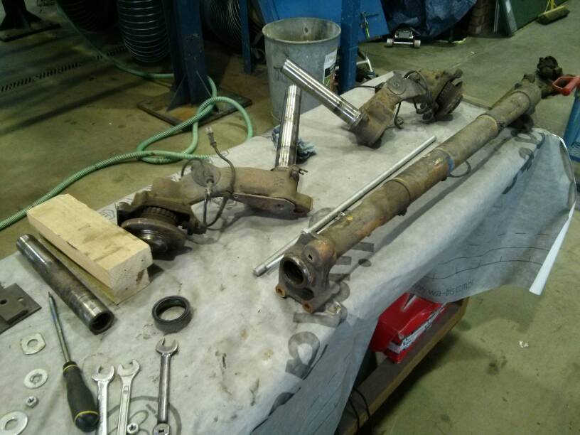

P bushes, I did Tue rear axle on the car and it improved the situation about 75% and now have a new set of wishbones and balljoints to go on.

I did the rear axle on my hatchback this weekend. Massive pain in the arse rebuilding the fucker.
