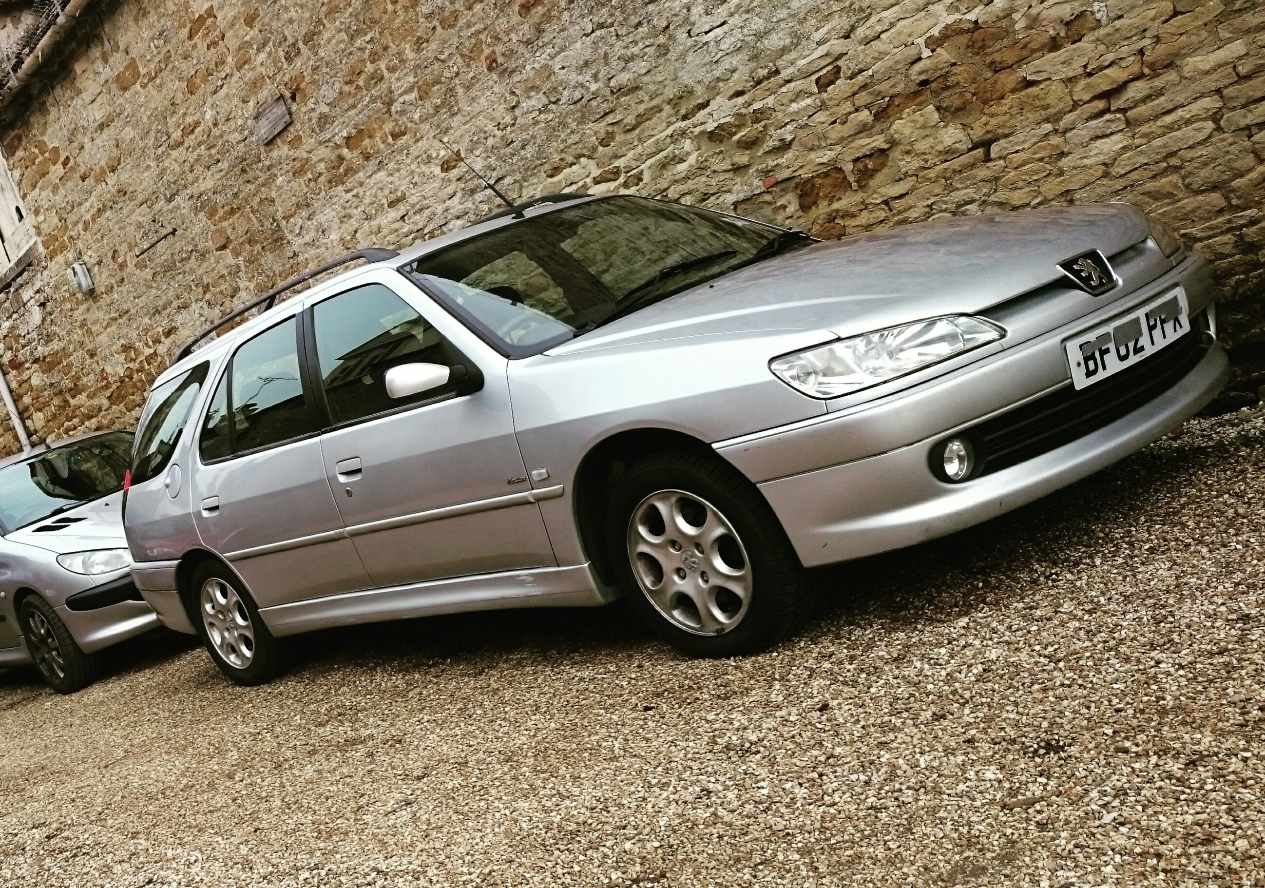

For some time a good friend has been running 1.5nad 106-saxo on veg as per my advice on cheap motoring...even makes his own now.
When someone side swiped his saxo...it was time to upgrade.... Obviously its a 306...he wanted an estate...so...
Ph3 Meridian with a xud9te from a ZX. £600. 12mths ticket. Bamm. Has a bosch so ready to go on veg
Gave me £250 to play with to see what I could do....

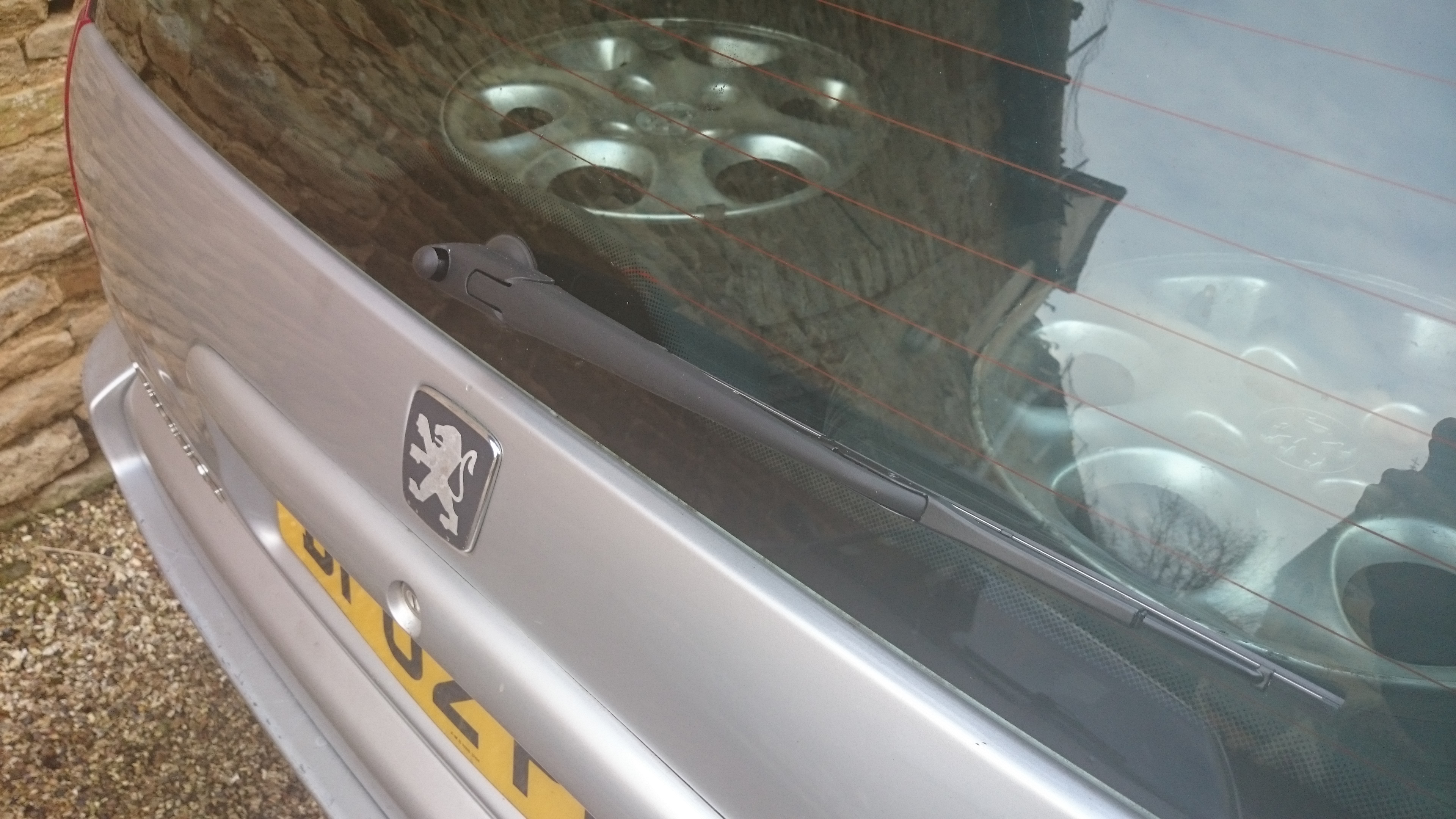

Today managed to fit new wheels, gti6 front brakes, new rear wiper and arm/blade. Change all brake fluid, serivce and correctly adjust rear brakes.

I love it! I really want an estate still! This ticks all the boxes!
Think the lasaaars make it look so much better...best oem 15" wheel for the estate imho.
Anyone has a 195/55/15 cheap but good nick...I'll have it
Not a lasers fan sadly Sad
Looks alright tbf, car looks reasonably clean. I think it looks ok on the lasers but i reckon clones would look better.
