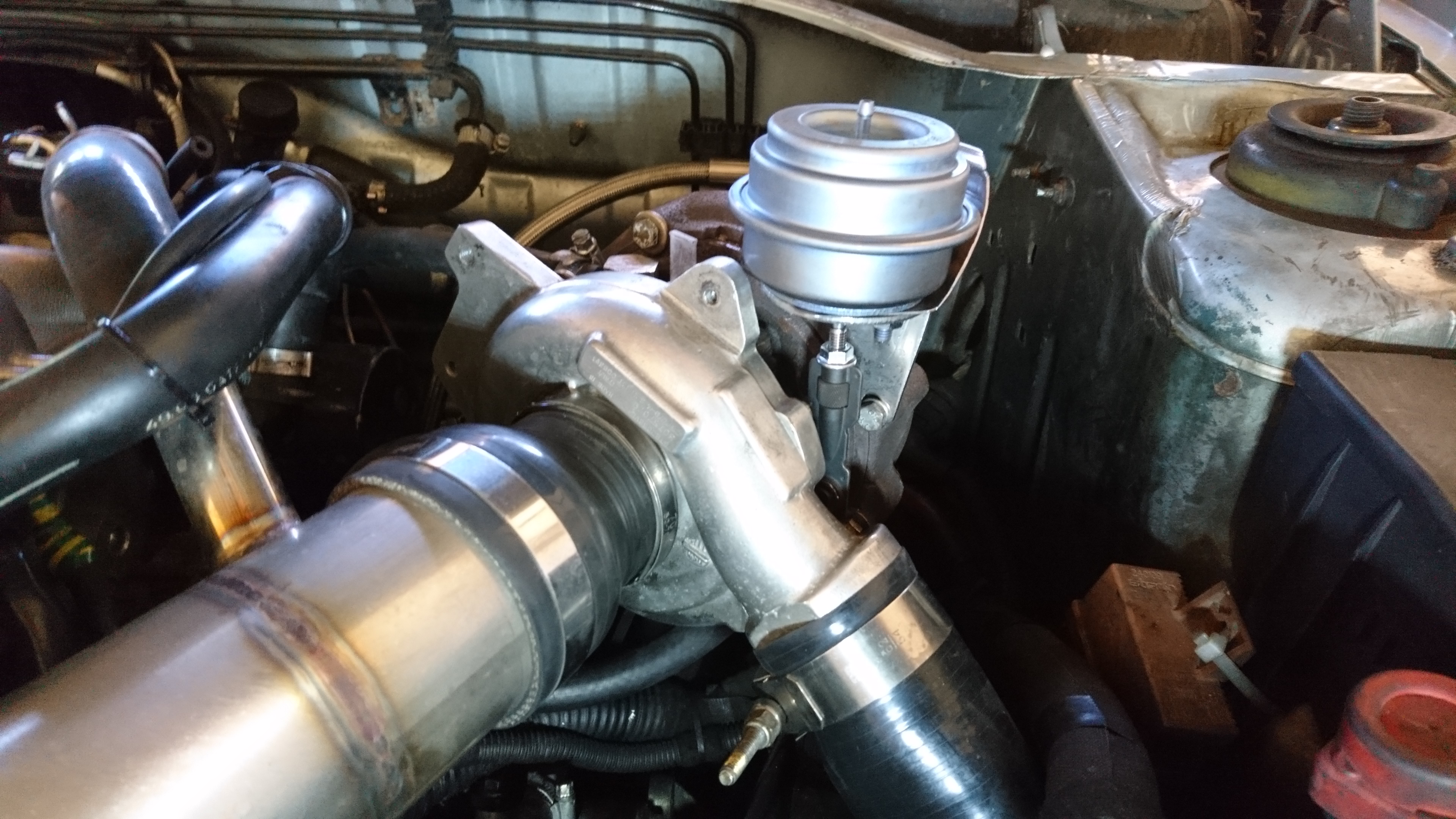

As its garage bound, whipped off the old multi link vnt control, fitted a shorter stubby one, hopefully to reduce movement in the joints. Looks bit tidier.
Will be adding a vac res' too.
