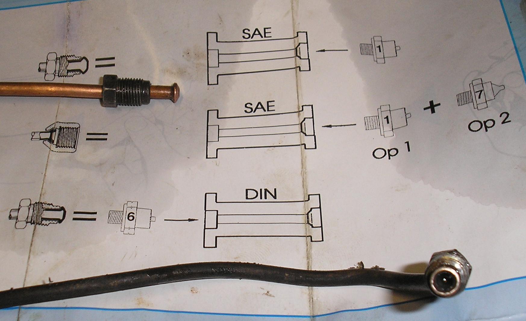

The pipe that came out didnt have any proper flare on it at all, lucky it didnt blow off!! will post a picture of that tomorrow.

have you bendix disc brakes on yours? could you take a picture of the bendix caliper if fitted, the metal brake pipe in the caliper is the interest. if the metal brake pipe is off the caliper, what flare does the pipe at the caliper end does it have, same as the flexy end??

Welsh pug, would you know if the metal pipe going into the bendix caliper has the OP1 flare, or does it have a converter that screws into the caliper with a copper washer, and the op1 flare metal pipe screws into the adapter please??
will post some pictures of the metal [pipe that came out of that caliper with the "flare" ( or lack of one ) that was on the end.

I was in ecp half hour ago getting the klarius rear exhaust box ( needs must will post a picture of the old one and the new one this evening ) and saw the padgid caliper, the metal pipe union holes is a tapered seal face inside for the OP1 type flare, just like the ends of the flexy pipe union flares.
will post a picture this evening of the "flare" or lack of one that was on the end of the pipe I took out, it didn't leak or blow off, but I consider an accident waiting to happen, the b%^$£"&^d that sold me this car is gunna get a black eye!!

the picture shows what an OP1 flare should look like, the type of flare thats supposed to be on the black pipe, the pipe taken from the caliper. |No proper flare what so ever, meerly a splayed end which didnt leak or blow out thankfully.
