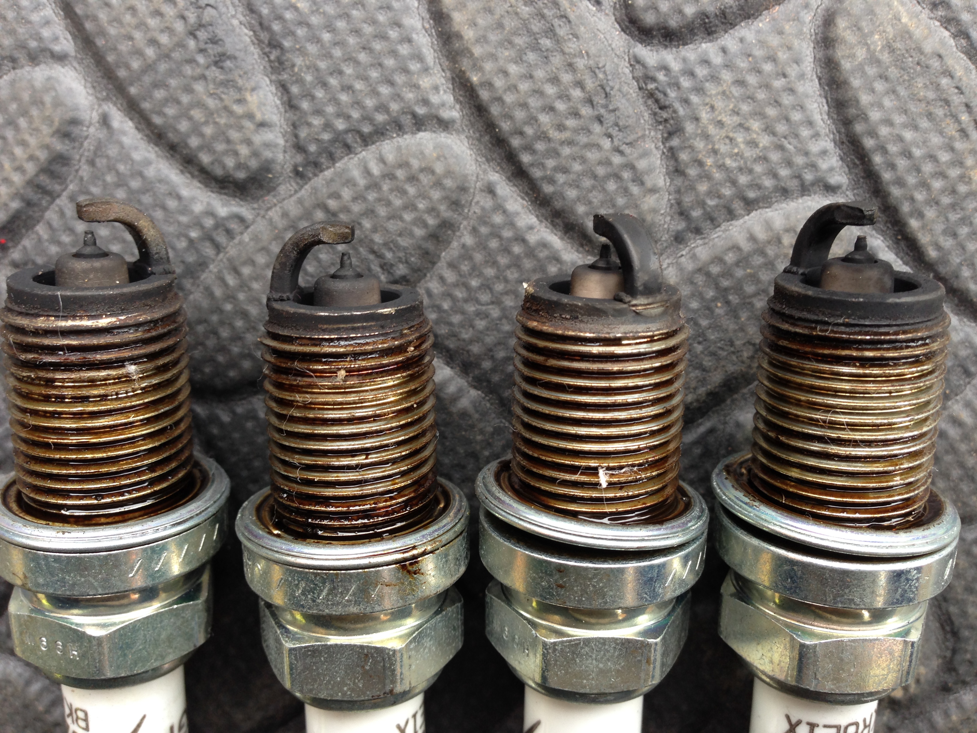

These are the state of the plugs:
Would say they have about 3000 miles on them by now.

Them plugs dont look bad at all tbh. The electrodes have been a bit damaged suggesting its not been running right. Your initial issue is going to be a fuel mixture issue but we can deal with that once you've found the issue with the high revs.

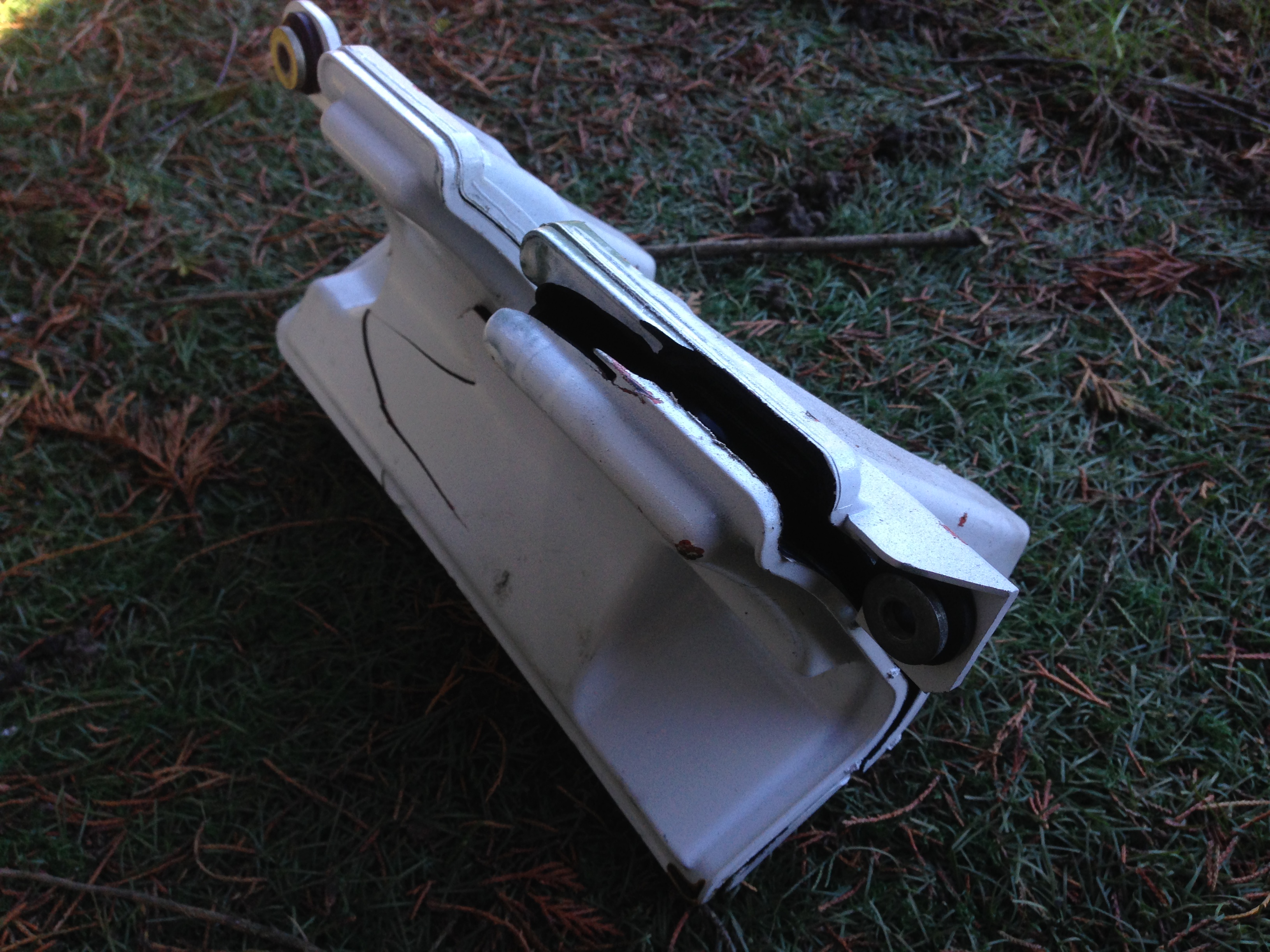

This morning I've managed to get more light into the engine compartment without taking the manifold off.
And Chaps, you're all right! The resonator has split down it's join and a nice hole blown off the corner.
Question now is, do I buy another resonator or do I buy a bung?

I thought it was a small hole in the res, apparently not:

wow that is really broken haha. the box not the sound!
