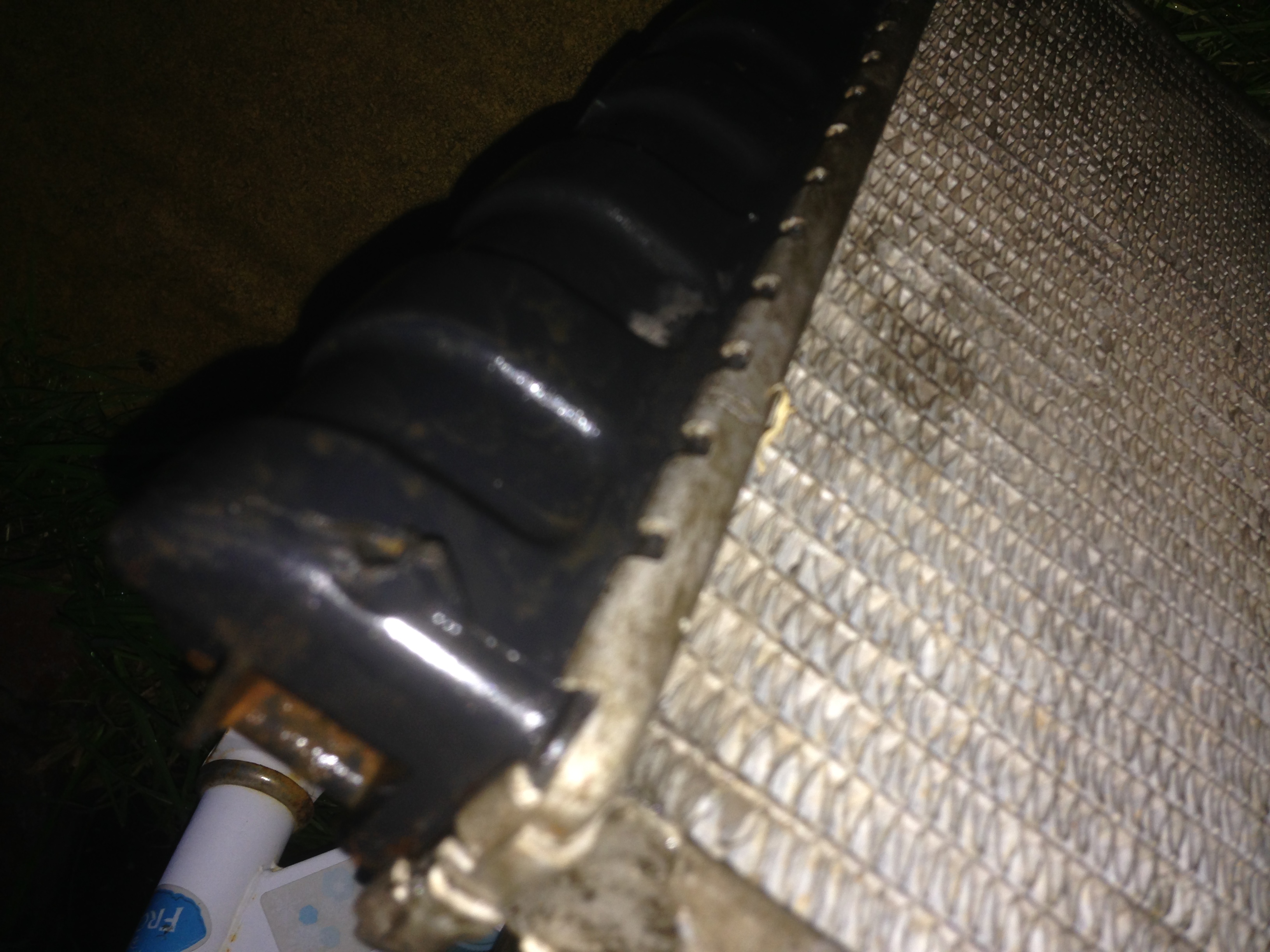

Got the fans out ok but leaning over on my hand on the rad accidentally snapped this ?. Rad on its way with single 12inch slim line fan and paint to re do front bumper grill and bonnet.

Yeah it's already out. I also noticed the bottom coolant pipe the one with the metal thing round it was leaking from the rad the a little would that have been the rad or the pipe?

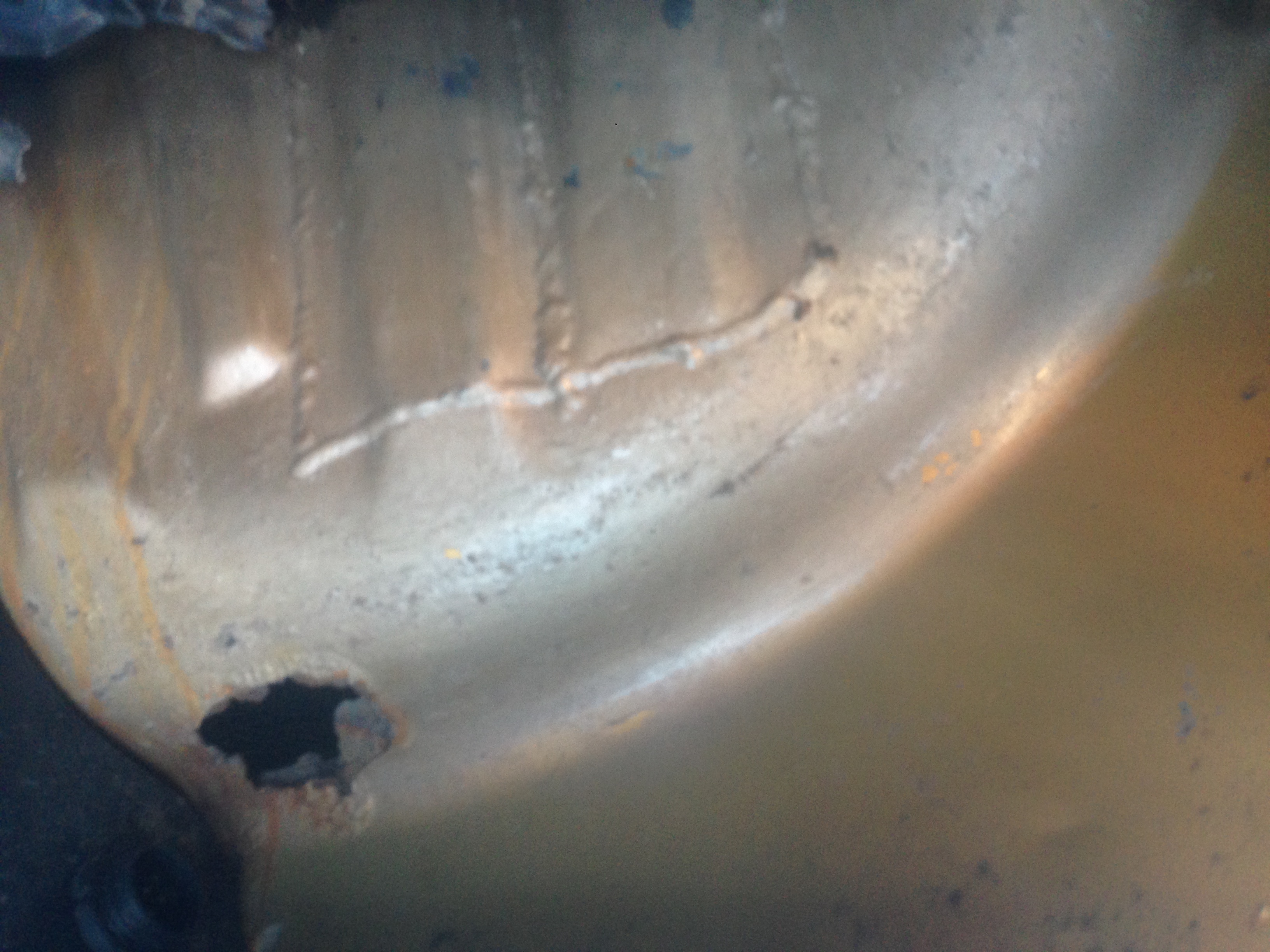

Just a quick one in the boot there's a small hole on the wheel arch it's already had a patch done but I've had a little look behind the plastic trim and there's quite a bit of bubbling wondered if there known for that or if I've got a leak
Known for it mate, drivers side rear I'm guessing, fix it then get a plastic liner out a later model to stop it happening again. Smile
Yeah it's alread had one patch done but the hole is at the top of the arch and having peeled the plastic trim just behind the drivers seat although it's blaze yellow it's quite orange and could quite a bit of welding. Seeing as the car was so cheap going to leave the welding till last as throwing money into it will stop me breaking it if it is pretty serious
(22-11-2015, 09:50 PM)ashdturb Wrote: Yeah it's alread had one patch done but the hole is at the top of the arch and having peeled the plastic trim just behind the drivers seat although it's blaze yellow it's quite orange and could quite a bit of welding. Seeing as the car was so cheap going to leave the welding till last as throwing money into it will stop me breaking it if it is pretty serious
(20-11-2015, 08:54 PM)Mattcheese31 Wrote: Known for it mate, drivers side rear I'm guessing, fix it then get a plastic liner out a later model to stop it happening again. Smile
