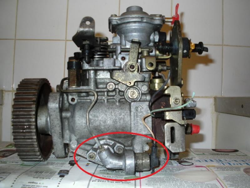

This is the pump u will be needing

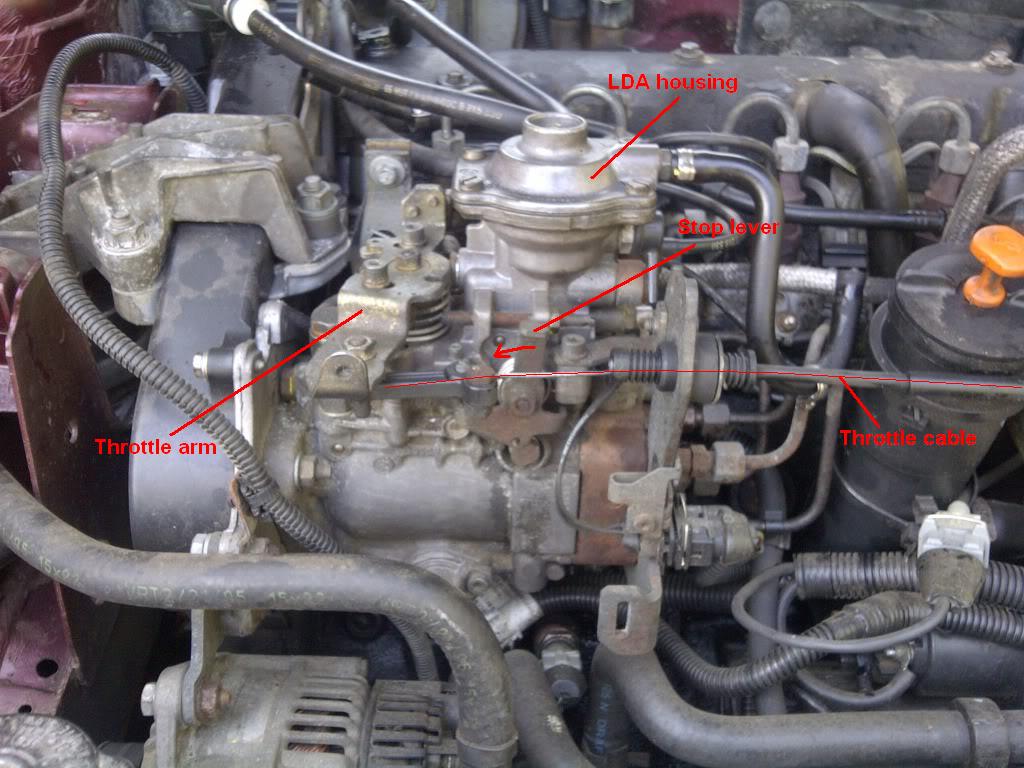

sorry to hijack but im doing the swap as well and the bit circled in the second picture does that need power what is it?
