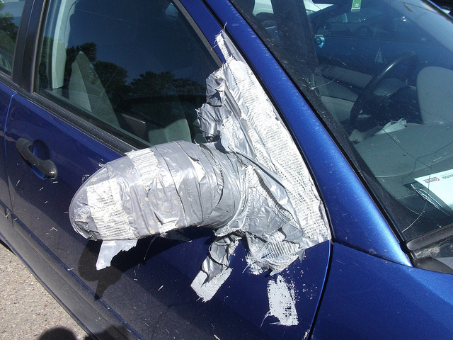

DUCT TAPE

I just don't understand people....why go to the time, effort and cost of a whole roll of duct tape when you could spend a tenner on a mirror and change it in 10 minutes! lol
