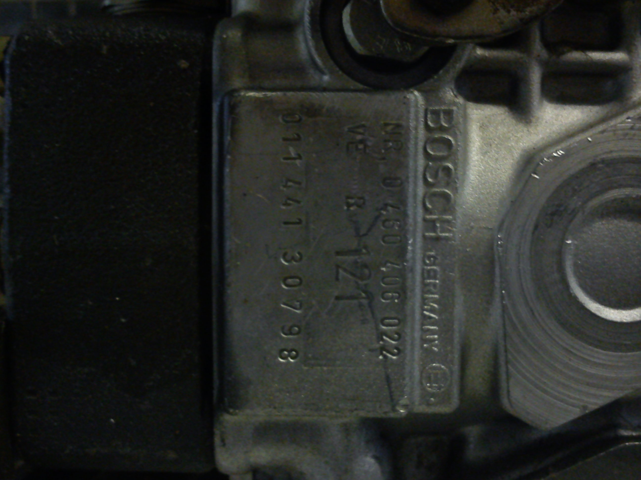

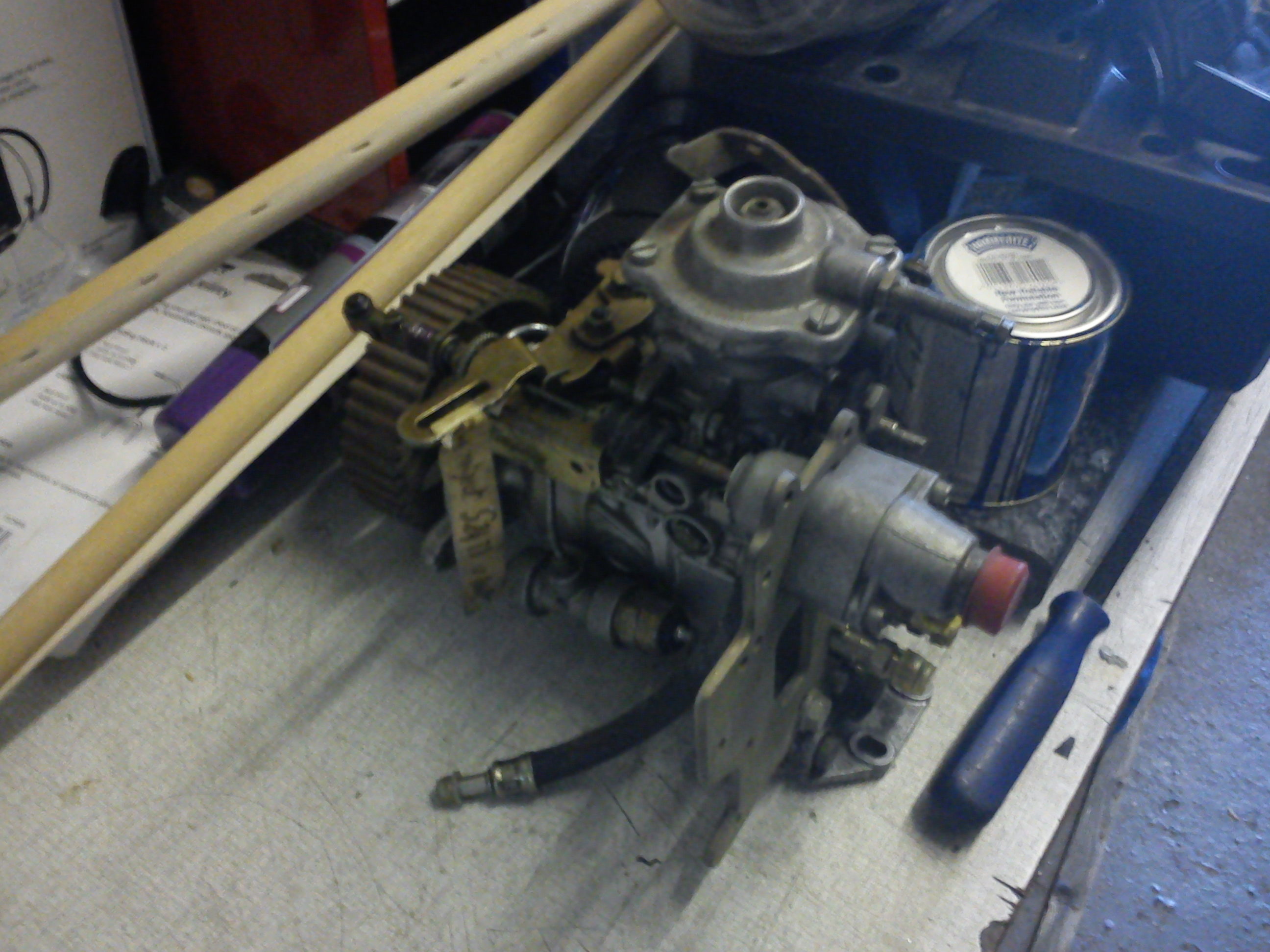

So my Bosch is here. May have to gov mod it before it gets fitted.
[attachment=0]
[attachment=2]

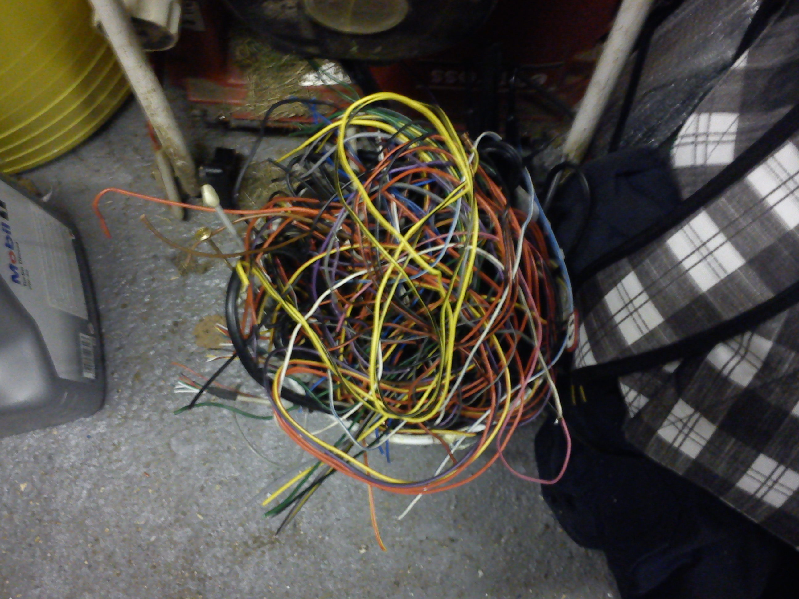

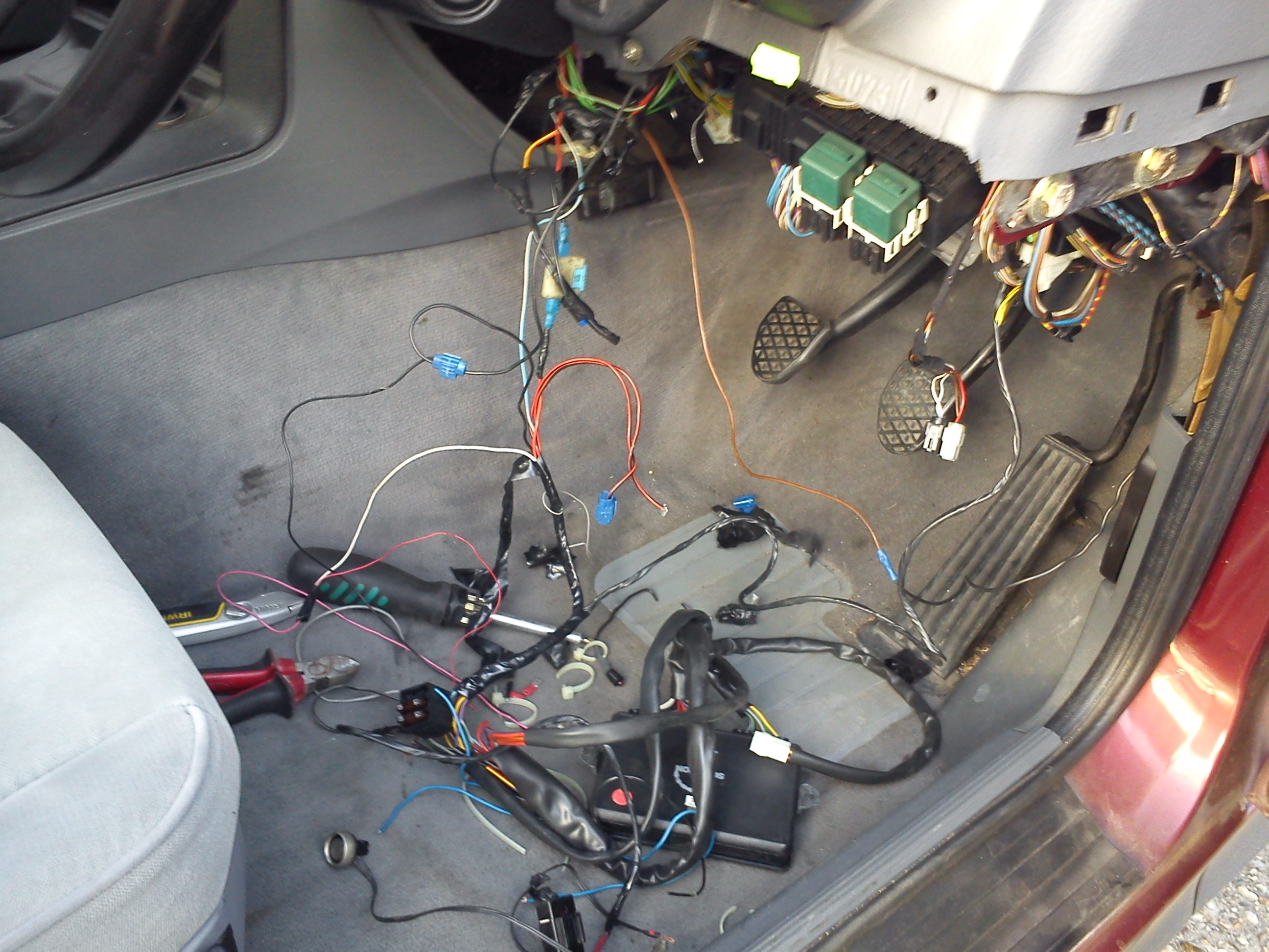

Removed the not working aftermarket alarm last night, was attached in about 20 places. Has given me a nice pile of wiring in my scrap bucket though.
[attachment=3]

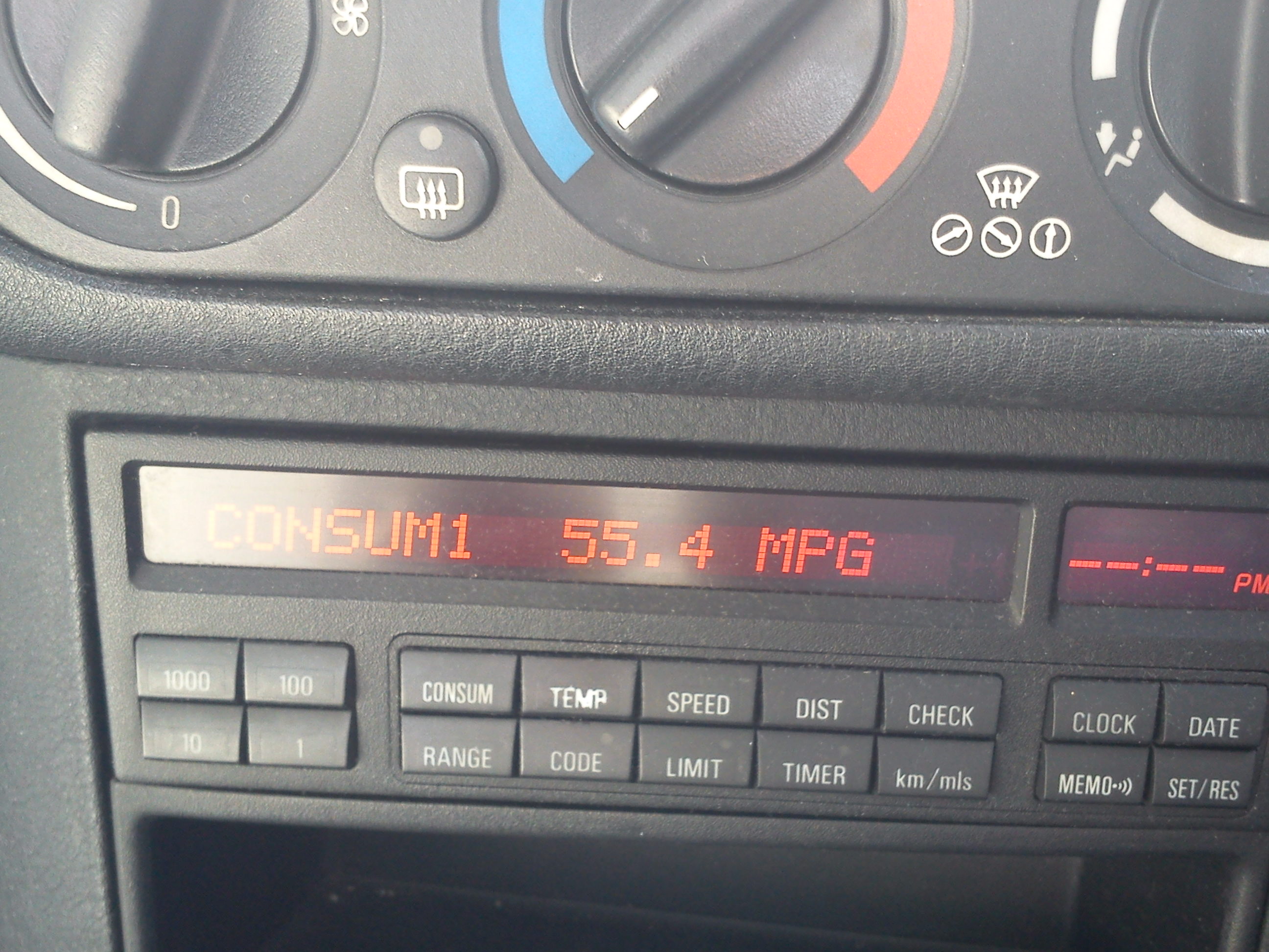

MPG wouldnt be too bad if i wasnt pissing fuel

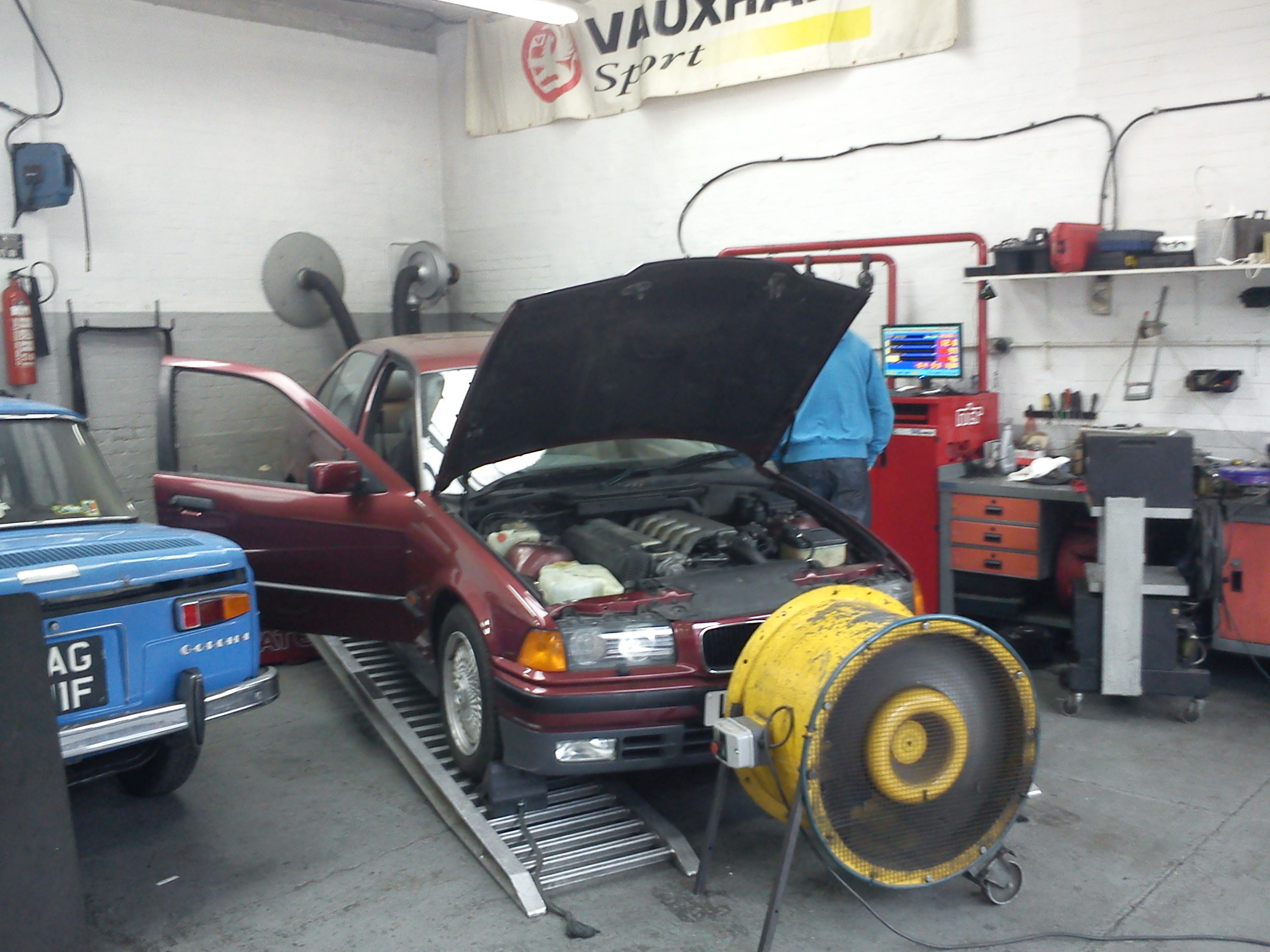

Oh and a quick pic of her on the dyno
[attachment=5]
