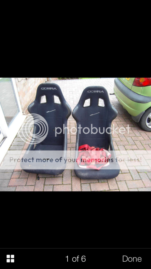

I found some non-reclining cobra monaco seats for sale for £50 so they were very quickly bought
I had to sew a couple of splits up that made them look a little scruffy....
