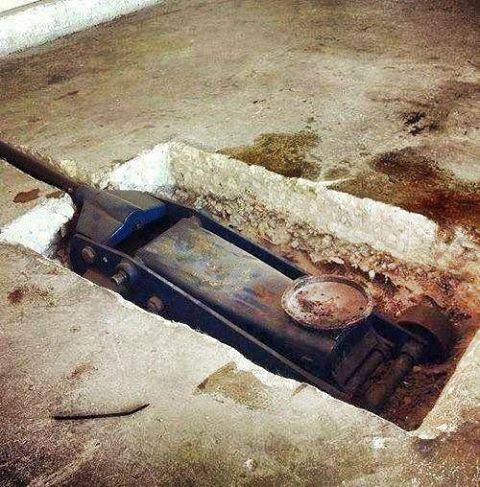

(05-11-2013, 06:45 PM)puglove Wrote: Job done
I need one on my drive!
Probably scrape as you go over it lol

That's a fooking brilliant idea Jamie. Love it. I don't think my dad would too pleased if I dug a trench in the drive though!
