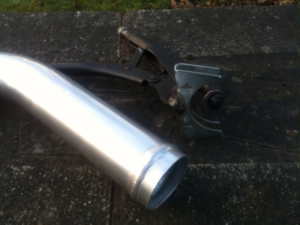

Made this today cost just over £20 but i didnot have any cheaper grips
[img][Image: 20131030_230958_zps31fecc99.jpg][/img]
[img][Image: 20131030_231009_zps3dacad7b.jpg][/img]
[img][Image: 20131030_231029_zps63d2e60d.jpg][/img]
[img][Image: 20131030_231106_zps077d138e.jpg][/img]
Going to try fitting a larger washer see if 1/4 of the pipe can be done at a time rather that just small bit's

Don't use a larger washer, unless you're popeye. You'll just make it really difficult to form the bead.
the other change I would say is the 'pinch' point is not far enough allong the grip jaws...meaning you are losing a lot of the leverage of the grips.
see that ebay one...washer is right on the end...makes it a lot easier
