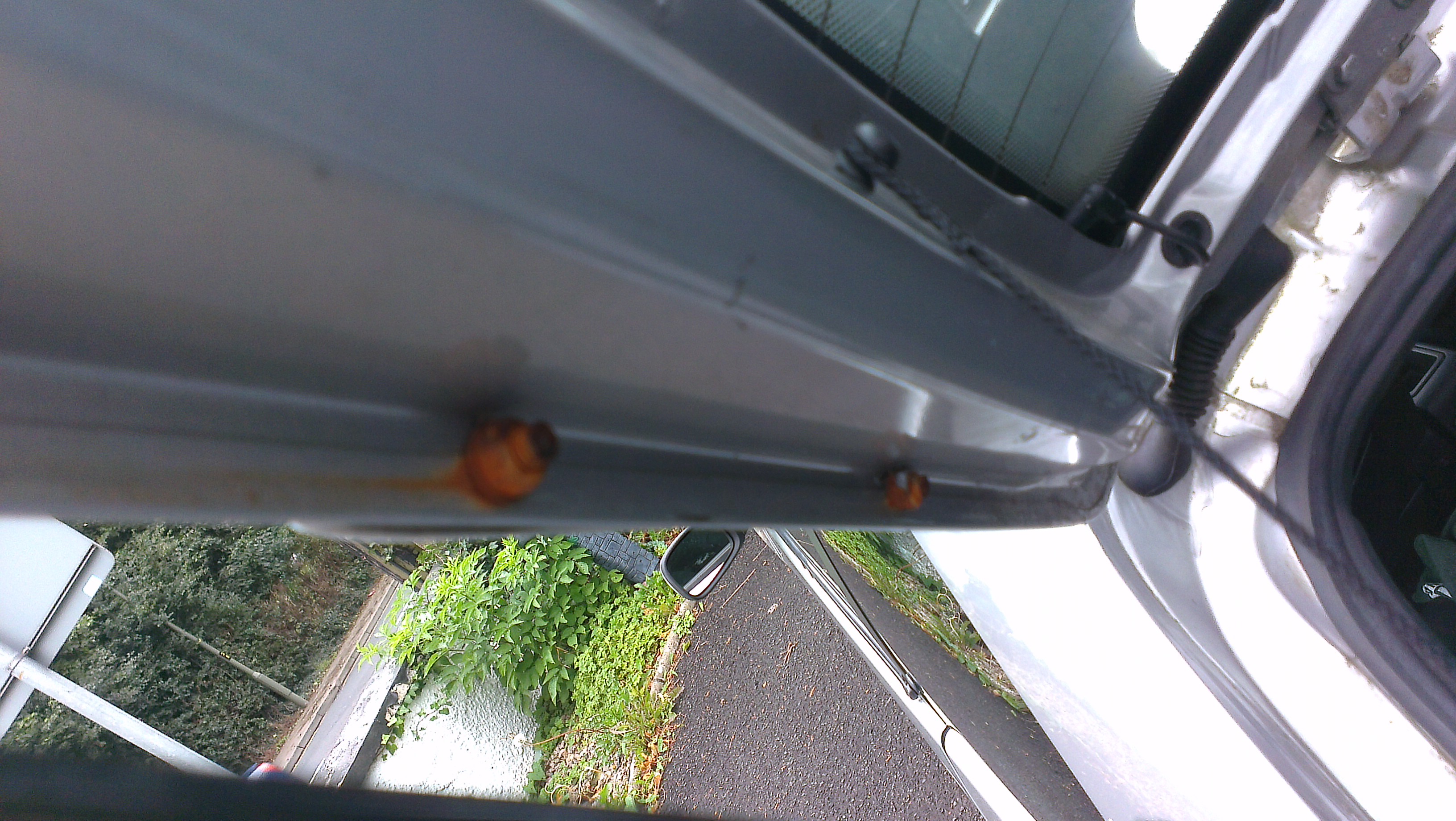

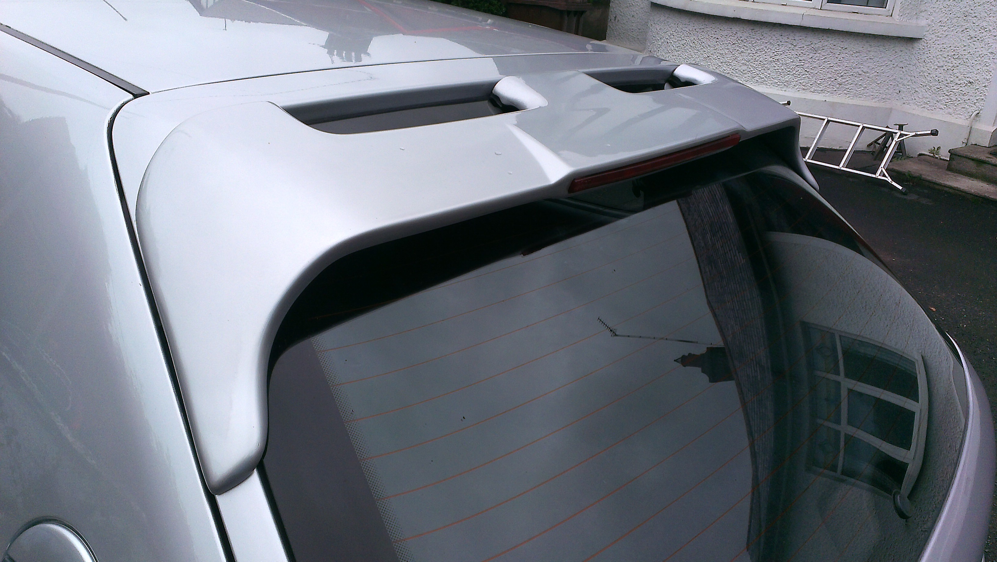

Hi guys really fed up looking at the 3 leg spoiler that came on my hdi and want to swap it for a standard ph3 gti one.
Anyway it appears it is bolted in two places on boths side of the bootlid and some kind of adhesive has been used too...
any tips on how to remove it and make a job of it?
how does a standard ph3 one attach?
cheers
[Image: 20gh7o0.jpg]
The glass will smash.
just saying.

Undo the bolts for a start. Then get a stanley knife and cut away at the adhesive, pulling the spoiler away as you cut. Will be easier to see what needs done once the actual spoiler is out of the way.

As will I. Given that I removed mine with no issues I can only conclude Jonny has the delicate touch of a gorilla with a hammer.
As the bolts aren't through the glass on this one I don't see how it's gonna affect the window!? You will be left with some nice holes in the bootlid though.
The phase 3 one screws through the top metal of the bootlid with one screw each side, you'll need to drill holes outside which match with holes inside. Or you can tiger seal it on if you don't want to drill.
Just get another boot lid. The P3 spoiler bolts on through two small holes. Check your bootlid and there should be two small holes at the top on each side covered up by black stickers!
^^^^ this is true.
but need to drill two holes in the outer skin of the boot lid to allow those covered holes to be used.
I'm beginning to think getting another bootlid with spoiler would be easier. because surely the paint will be buggered with the adhesive, nevermind the holes lol.

I'll take it if its not too much, one in mines has only half the leds working. Also chances are youll possibly break the glass if theres been alotta tigerseal etc used if seen a few of these spoilers for sale which have been taking off with bits of glass on the sealant or actually bits of the spoiler missing..
Did you ever get this spoiler off..? Willl take the light from it..
Use a heat gun to soften whatever has been used to stick it on.
it will be pu adhesive ? if so will be stuck like sh*t to a blanket.
try to use a piece of cable such as accelerator, bike brake or gearchange cable----use it like a hacksaw to cut it ??
or cheese wire, used it to take windscreens out before, but if your not careful you will either cut the end of your fingers off, or scratch the paint to fu*k
