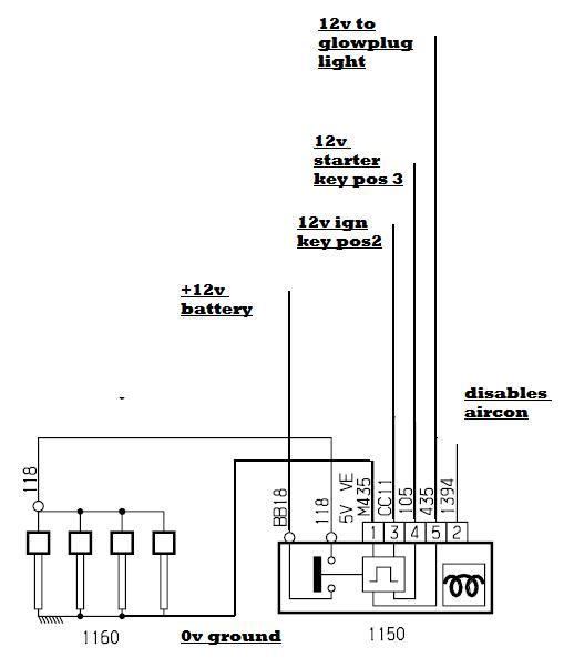

Morning all, would somebody be able to post up a simple diagram for wiring up a glow plug relay please? Been searching the sodding haynes for half an hour and thoroughly pissed off with it lol. Cheers!
EDIT: For an XUD btw.
may help a little
where is says disables aircon that is a guess as it connects to the aircon and im unsure what it does
Is that for an XUD? Sorry, should have specified, edited the first post. :S
(10-08-2013, 03:58 PM)Poodle Wrote: Is that for an XUD? Sorry, should have specified, edited the first post. :S
yes as you did say simple!
