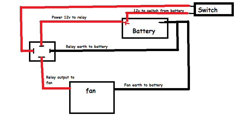

I've completely ditched the stock relay and fan set up and have fitted and wired a slim line fan to a manual switch pretty much like cullys diagram.

Gimmie a moment...
[Image: rITXVnx.png]
#43
o dear god Nialls at the crayons again!
go look at the drawing i posted..............
#44
86 goes to a thermostat - ie; my switch?
(21-06-2013, 02:55 PM)cully Wrote: o dear god Nialls at the crayons again!
lmao
Also, it say's 85 goes to 12v? should it not stay as an earth?
#45
hmm i followed the diagram to the TEEEE, except i connected the wires where the switch "will be" and manually put the 12V on to make sure it was kicking in, and nope..
so i bridged 2 & 5 (85 & 86) and the fan kicks in, but the relay doesn't want to activate the magnet.
tried another relay, nope.
I am using thin speak cable for the switch, could this be the fault?
Can't see where i've gone wrong..

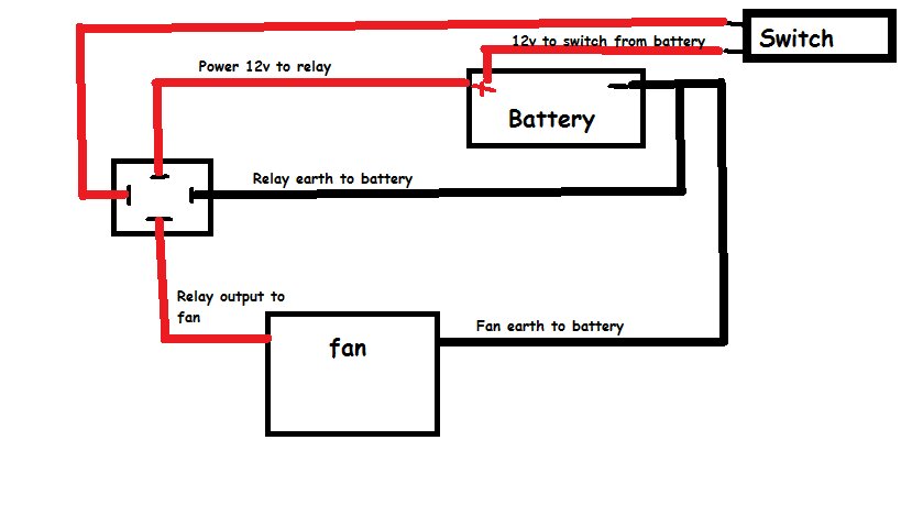

#46
Being trying to get my head around this too lately, i get myself so confused its unreal, i came up with this tonight (i believe its correct, if not somebody please tell me) sorry for the tragic attempt of using paint but you get the idea!

#52
(11-07-2013, 10:24 PM)Mitch Wrote: Being trying to get my head around this too lately, i get myself so confused its unreal, i came up with this tonight (i believe its correct, if not somebody please tell me) sorry for the tragic attempt of using paint but you get the idea!
If I use this diagram can I use the fan sensor in the thermostat housing and wire it up instead of the switch?? I will also have a switch but its for the mrs car and want it to come on automatically aswell so if she forgets it wont boil the car
#53
I wouldnt know sorry dude, it fried my head working out that diagram the other week, matt, i used one of the green relays out of the standard fan unit, used it a fair amount on the way to pug fest, and the last few days in this weather we are having, all seems to be ok!

(19-07-2013, 12:43 PM)Matt Wrote: Sorted. Scrappers at the weekend then, relay and wiring Smile
Did you find it easy to wire up?
erm it's dependent on your competence i guess; for cully and the like, he can do it in his sleep, for myself whom his electrically numb, it took a fair bit of figuring out and literally copied the layout from paper; i printed it out and followed it to the T.
