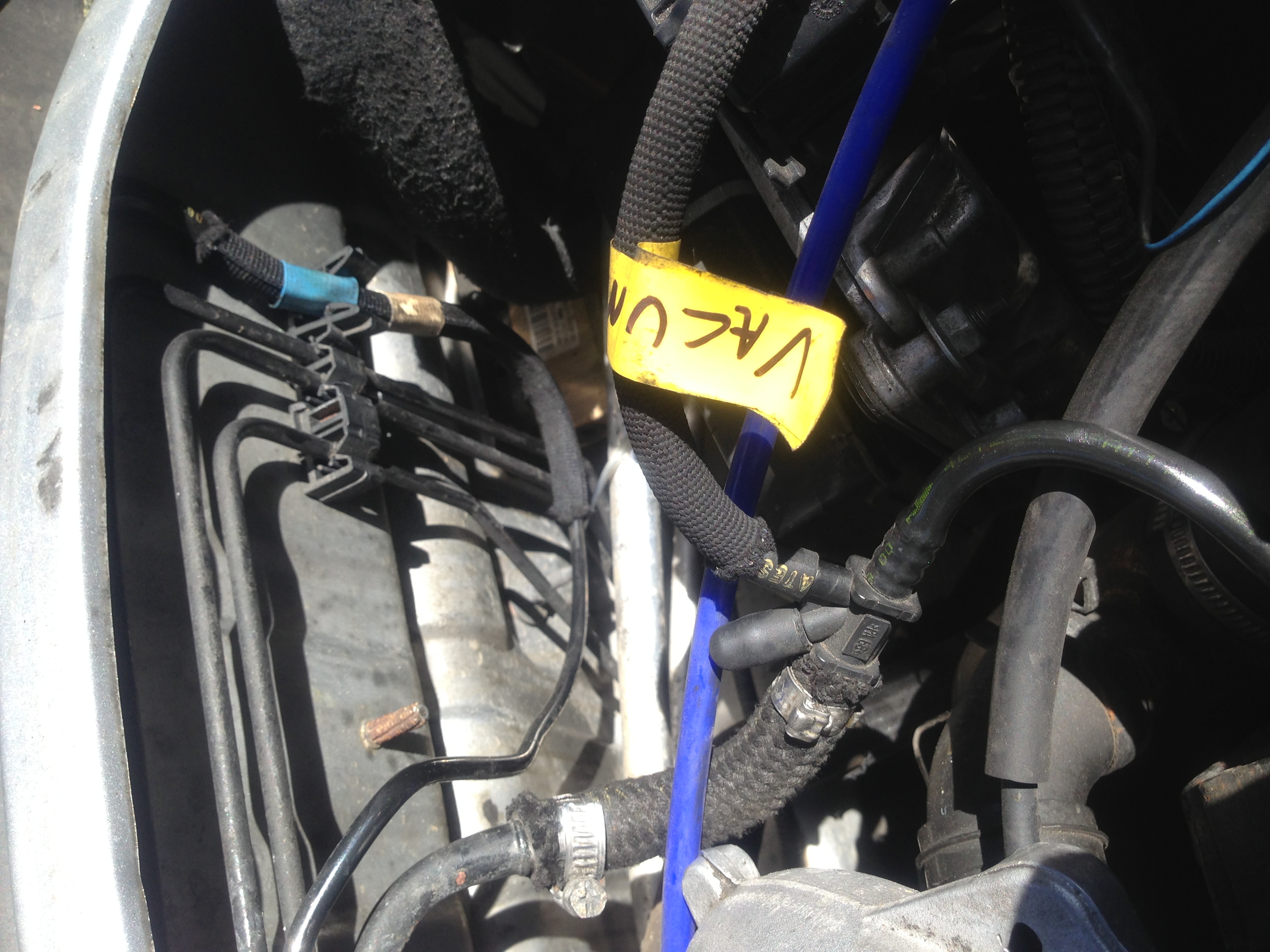

So I fort I'd put a dump valve on the hdi just purely for the sh*ts and giggles but I can't seem to find what vacume pipe I need to T into. I've set up the solenoid system boost in one end but need to do the vacume in the other. I've T'ed into my boost gauge line will that be ok? Will it still show when I'm fully boosting or be less now, also set up the micro switch on the throttle so all I need to sort out is the vacume any idea/pictures people could help me. Thanks in advance. Ben

You'll need to t into the vacuum from the brake servo
You'll need to artificially create a vacuum, as obviously diesels dont have a throttle body. Easiest way would probably be to wire up the egr solenoid to the pedal switch and connect your vacuum feed t that.
Been asked for better explanation of what I mean above, thought i'd put it here so people can see it in future. Smile
Basically you need a new vacuum feed for the pressure switch. Easiest way to do it I can think of would be to rewire your egr solenoid (guessing you'll be de-egr'd already) so it's activated by the switch you're installing on the accelerator pedal, then run a new vacuum line to your bov from the solenoid.
This is only me making an educated guess btw, never installed one myself, but can't think of an easier way to do it or any reason why this wouldn't work.
There is 2 capped off lines on the vaccum hose that you can use.
If you look at the rocker cover on the right hand side (from the front of the car) there is a cylinder on the end of it about the isze of a tennis ball with a pipe coming off, this is your vac pump. use one of the blanked things on the pipe off it.

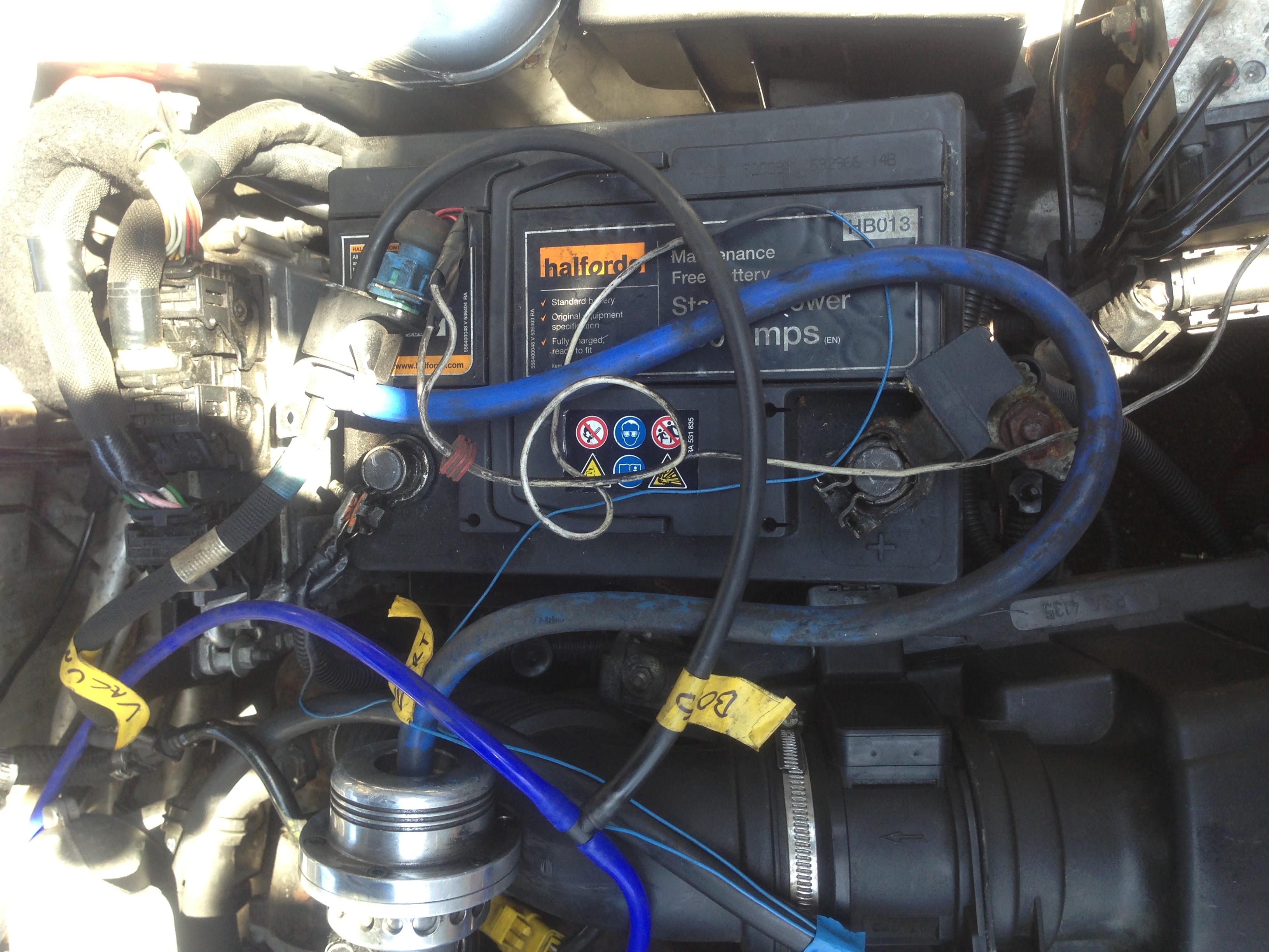

so its all up and working but its very quite Sad
still needs a tidy up as its very messy still with wires every were
Looks about right to me but youll want a vac resovior as otherwise its not strong/fast enough to open your DV
Shouldn't be quiet mate. Also dont use the blanked off pipes as there restricted you need to T into the actual pipe like I told you lol
Then it will sound better Smile
Blanked off pipe?
Dum-dum what do you mean by a vac resovior
(05-06-2013, 07:57 PM)Ben hdi306 Wrote: Blanked off pipe?
Where you have your vac pipe going to take it off. T into the material pipe that connects to the metal pipe.
(05-06-2013, 07:57 PM)Ben hdi306 Wrote: Dum-dum what do you mean by a vac resovior
Believe it or not i mean a resovior for the vacuum
Basically a small inline tank or even large diameter pipe just before the solenoid as it means there's a large store of vac for that instant hit to the DV to make sure it opens quickly.
