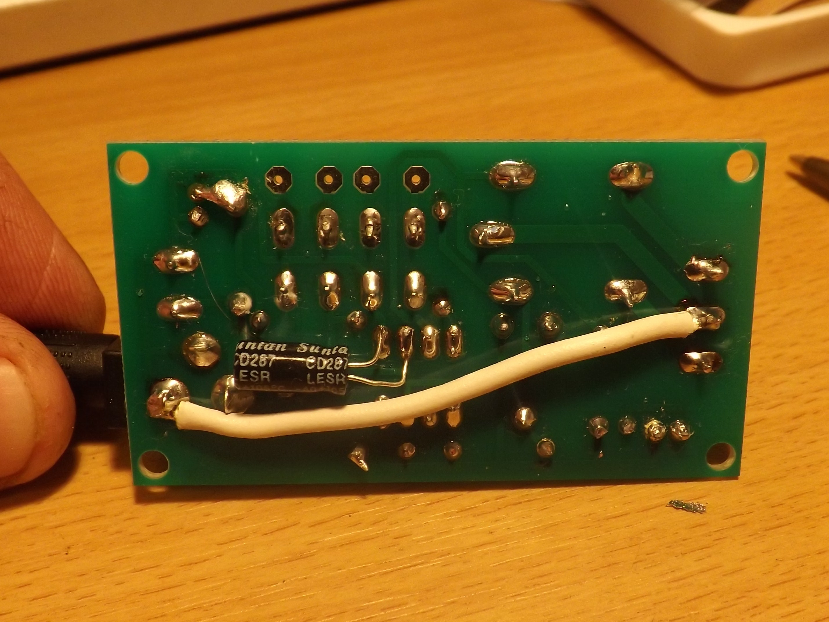

you will need one extra capacitor 10uF 50v and some wire
solder up the kit as instructed
add the capacitor across pins 1 -2 of the chip, pin 1 is 0v or - if the capacitor is polarised!
adding this mod makes the timer start the delay as soon as you power up
as the circuit std needs the board powered and then triggered with a button
add a length of wire between the 0v feed and the common of the relay output
this addition is part of the wiring for the airbag lights Wink

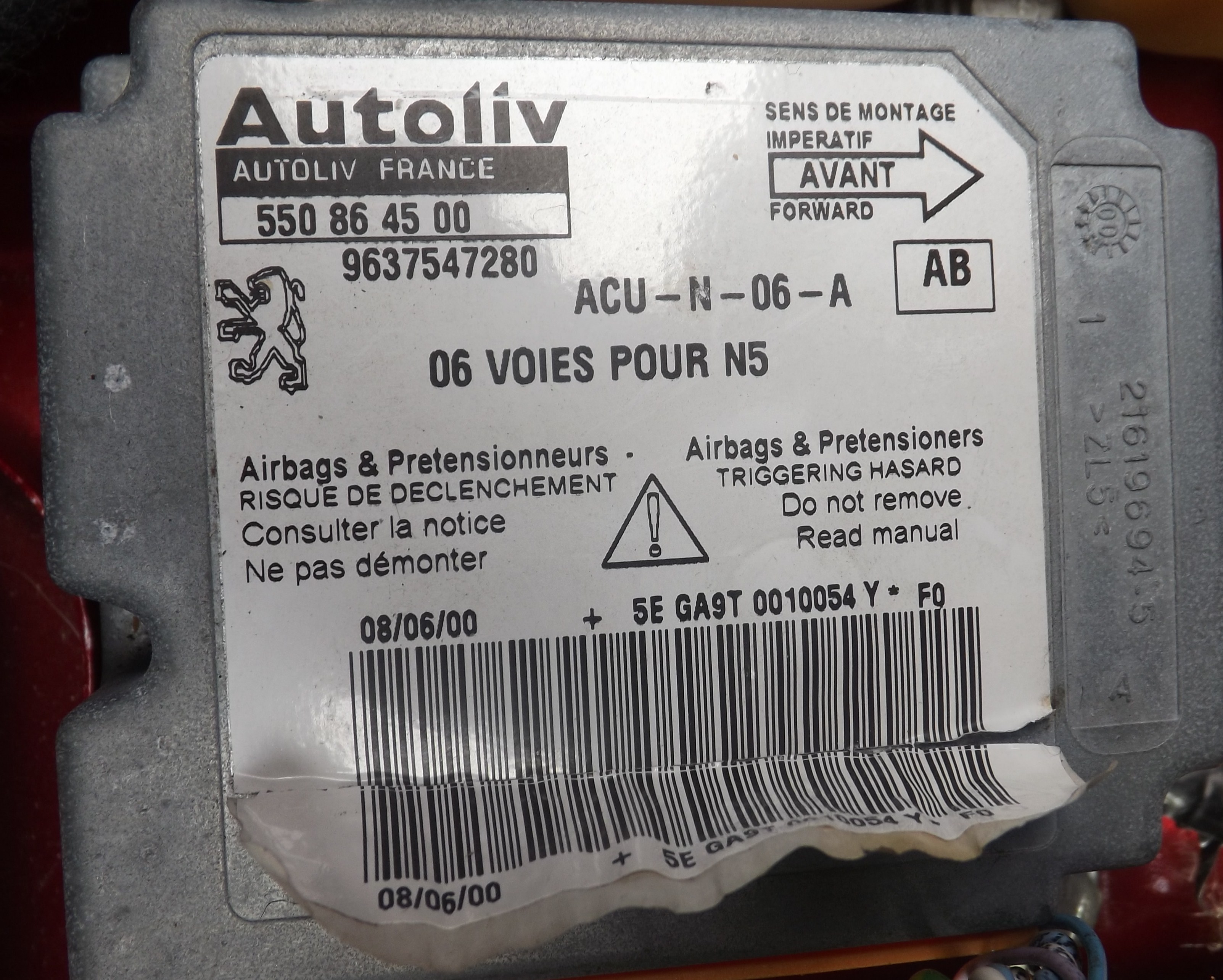

Airbag ecu Pin outs for wires needed

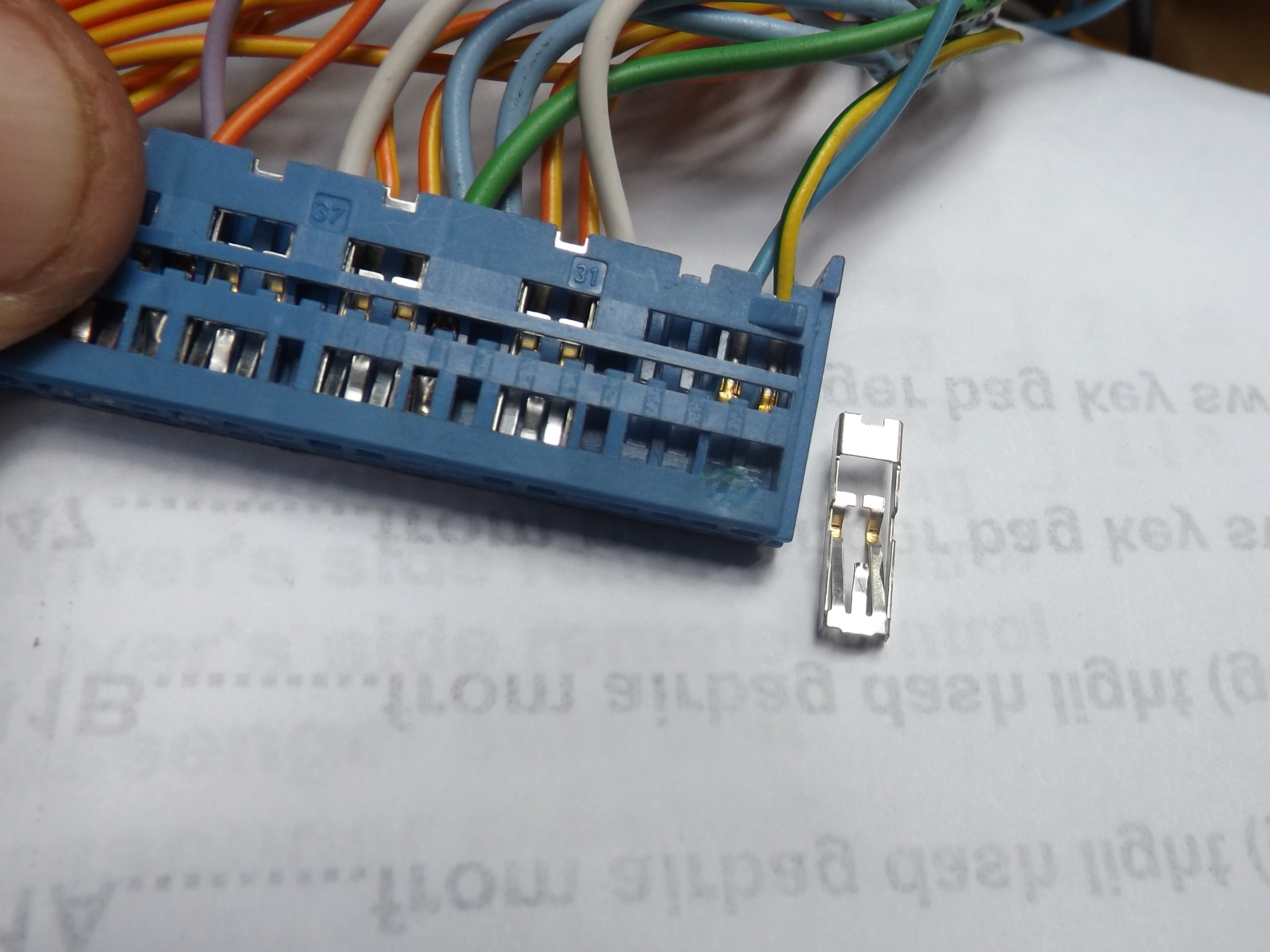

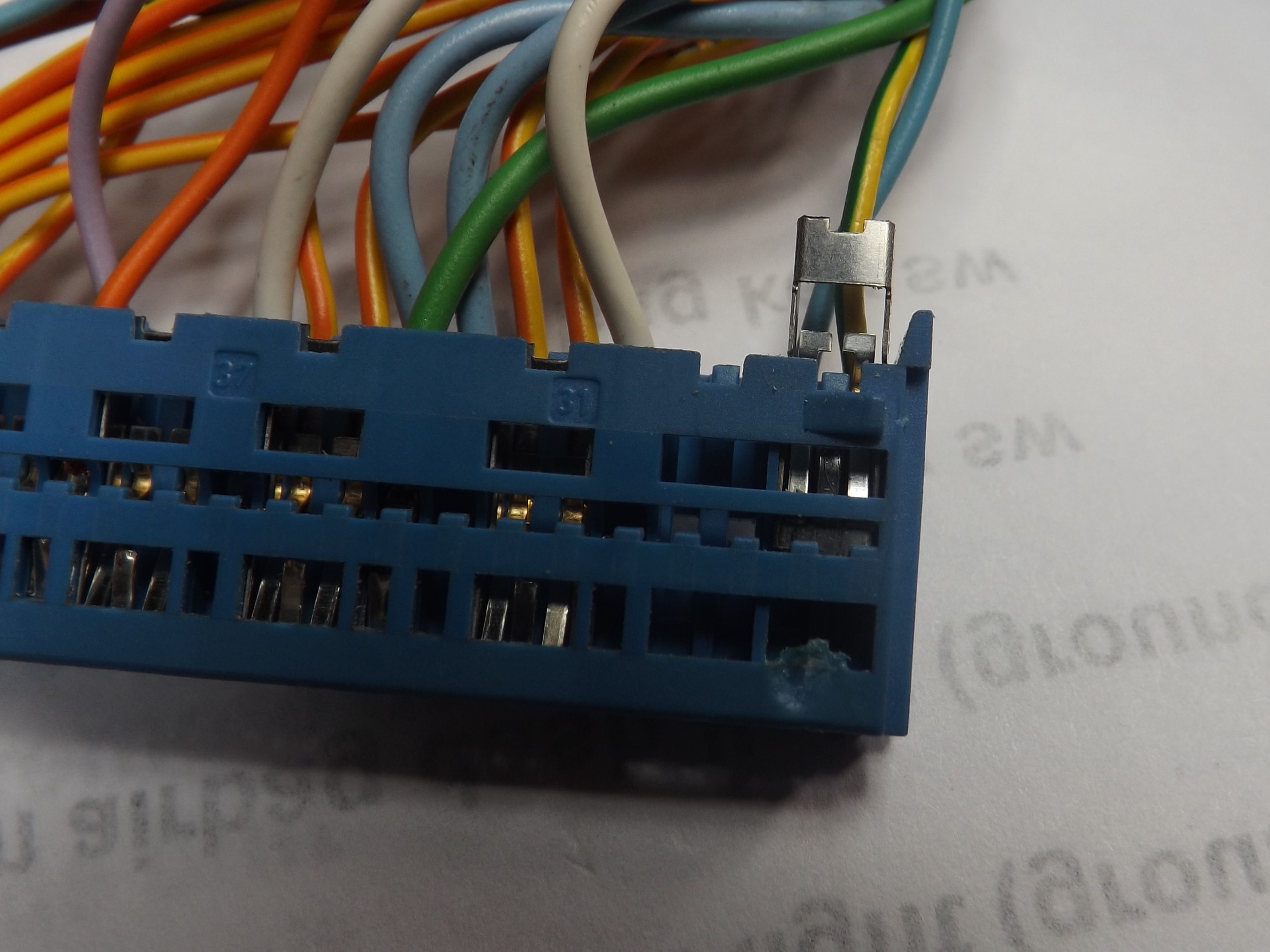

VERY IMPORTANT
remove the shorting link at plug pin 26-27 this shorts pins 1-2 together
push down on the centre tab and push out
if you don't remove this the airbag light will stay on permanently!
