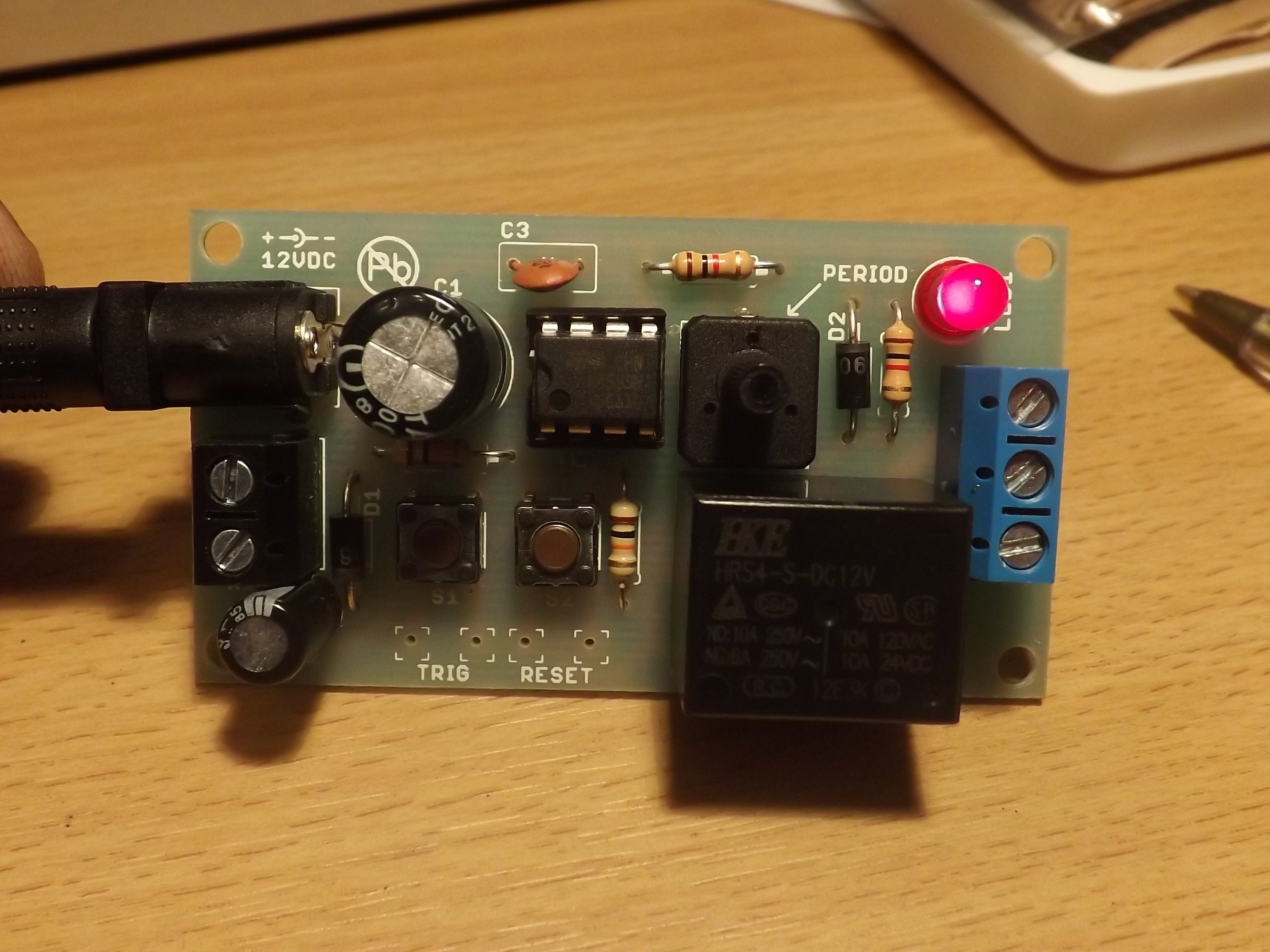

delay on or off timer
i have used a timer from Maplins for this as its all i could find at short notice
unfortunately the timer dose not do quite what i wanted it to do so have slightly modified it
the timer comes in a kit you have to assemble!
Maplins kit 555 Monostable Switch Kit N32FL
http://www.maplin.co.uk/555-monostable-s...kit-220009
[Image: n32fl.jpg]
you will need one extra capacitor 10uF 50v and some wire
solder up the kit as instructed
add the capacitor across pins 1 -2 of the chip, pin 1 is 0v or - if the capacitor is polarised!
adding this mod makes the timer start the delay as soon as you power up
as the circuit std needs the board powered and then triggered with a button
add a length of wire between the 0v feed and the common of the relay output
this addition is part of the wiring for the airbag lights Wink

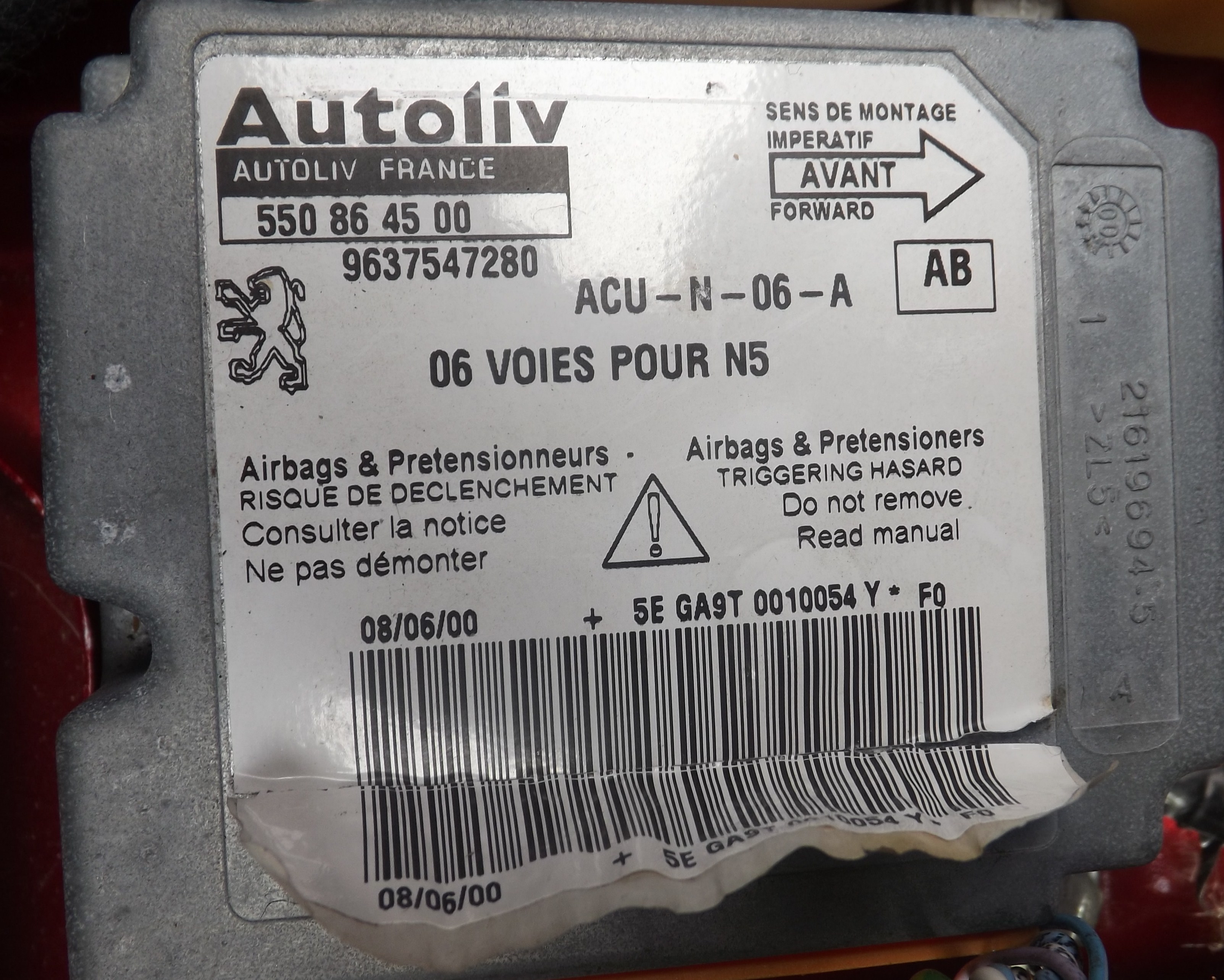

Airbag ecu Pin outs for wires needed

Pin 47.....wire number CC4............ connect to +12 of timer board
ground/car body............................connect to -12v of timer board
Connect all three of these to one wire and connect to O/C of the timer board

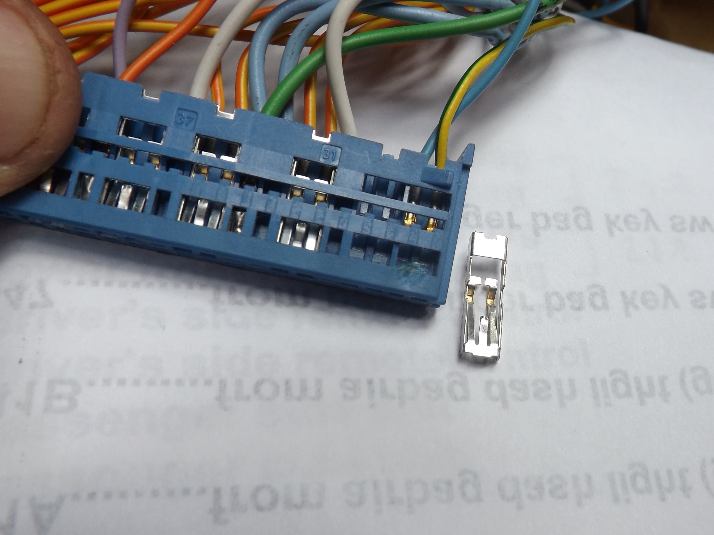

remove the shorting link at plug pin 26-27 this shorts pins 1-2 together
push down on the centre tab and push out
if you don't remove this the airbag light will stay on permanently!
leave Airbag ECU unplugged
test by turning on the ignition the airbag+sidebag light should go out after a timed delay
to adjust the time the lights stays on, adjust the pot on the board to extend or shorten the time

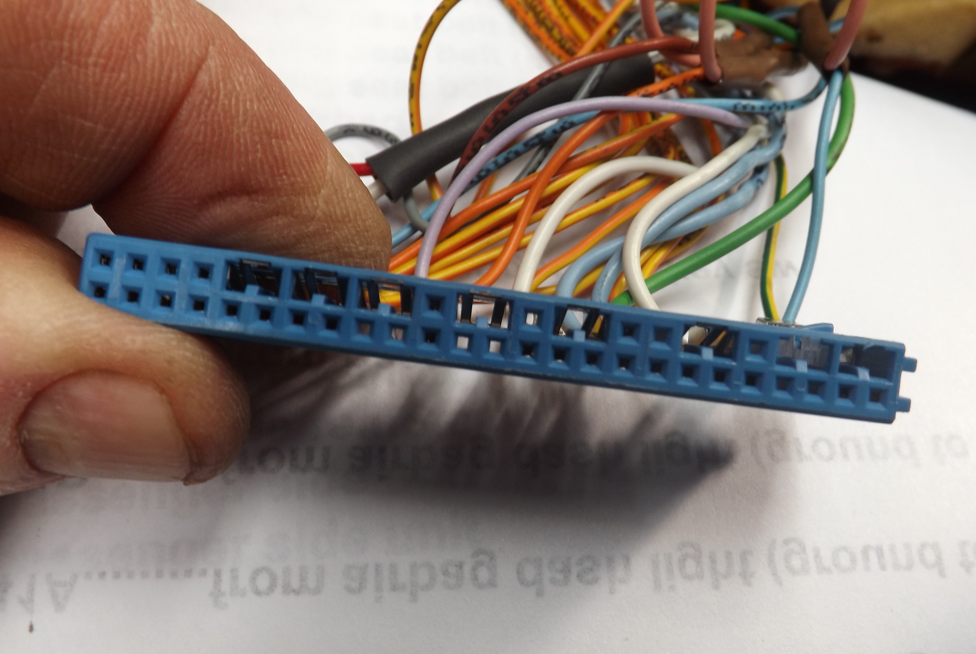

when i say with the shorting pins defeated!
if you look at the plug you have double holes above single holes
when the plug is unplugged from the ecu the double holes short the single holes below protecting the airbags from stray voltages stopping static setting the bag off
Safety feature!

Also, when building the circuit i didn't bother with the buttons, relay or output terminals as i won't need to power an external circuit, just switch on the led for 5-6 secs when the circuit is energised by the 12v feed.
Speaking of which, your mod to bypass the trigger switch worked a treat - ta for that.... however... rather than switching the led on for 6 secs, it remains off then switches on after 6 secs!!! How might i correct this?
Additionally, when the circuit is broke then re-energised soon afterwards the delay is less than it should be... in fact if you were to switch the ignition off then on again quickly the light might not come on at all! I suspect that this is due to residual charge remaining in the capacitor/s. Therefore the question would be if these could be arranged to discharge on power off to ensure the proper delay every time the ignition key is turned on.
