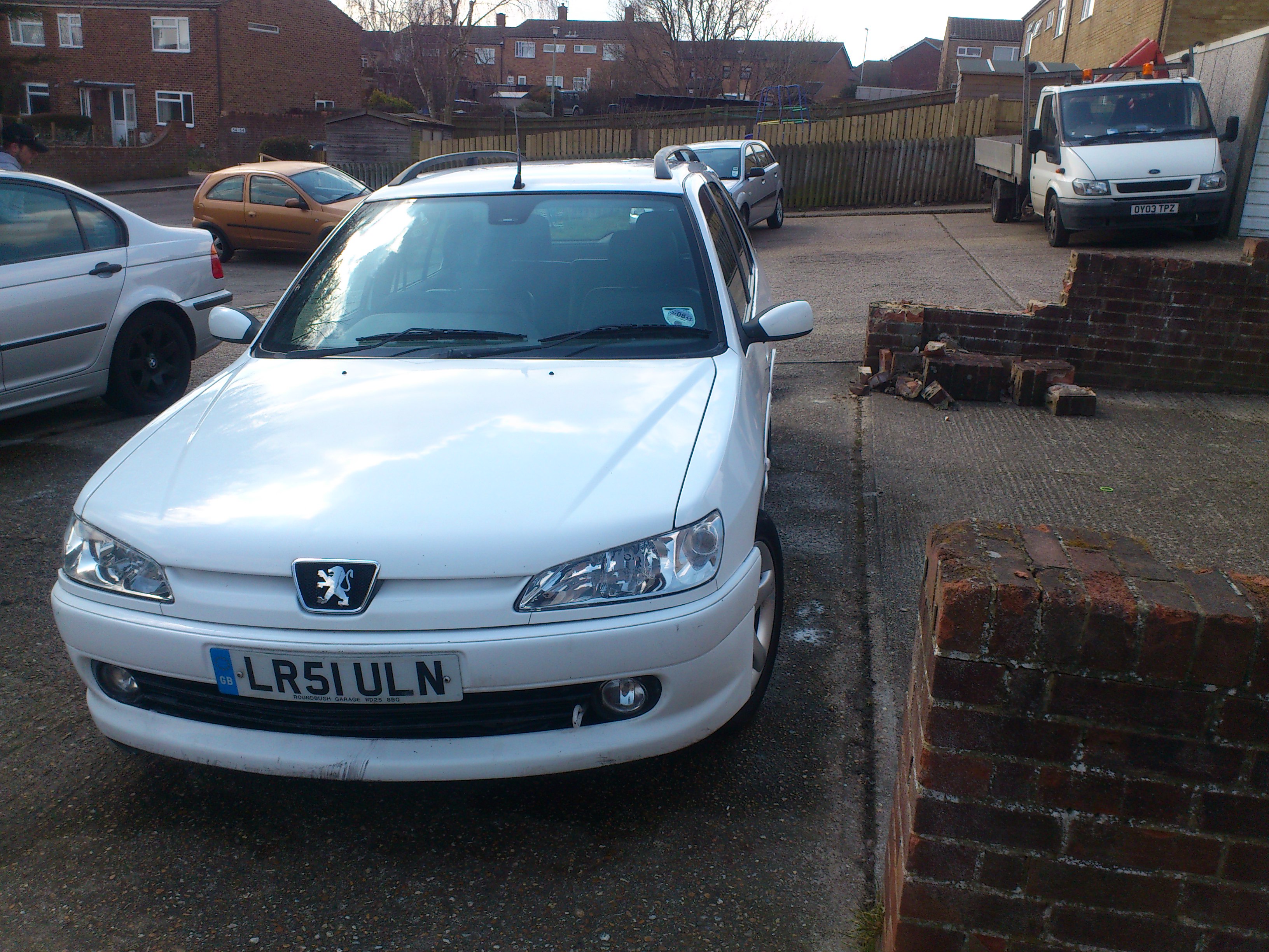

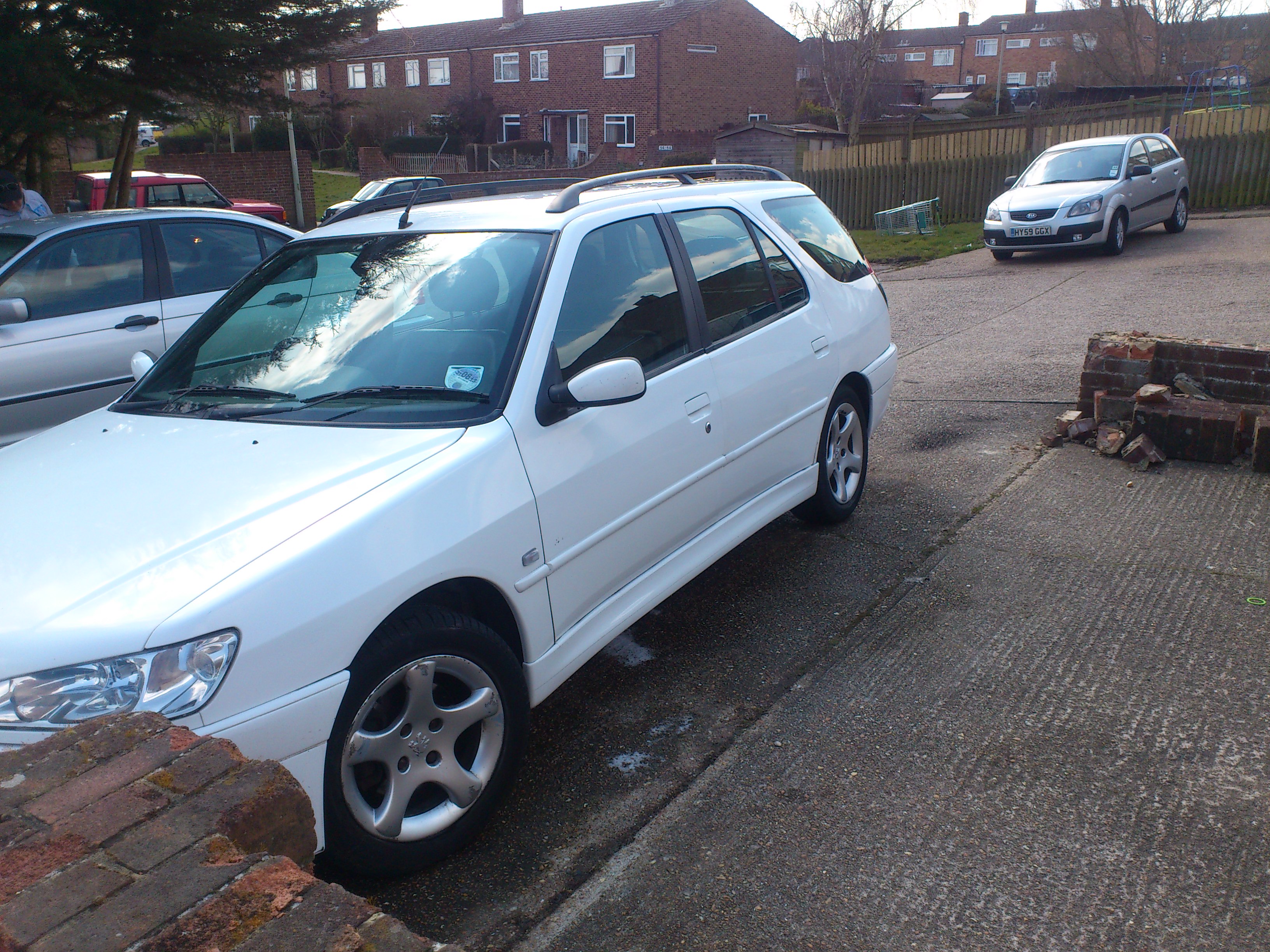

just got a 306 estate 51 plate d turbo ....
paint work is flat as sh*t but is coming up with a bit off elbow grease will put some pics up later
plans are gloss black wheels smoked windows wind deflecters a nice drop and sounds an tune it a bit Makeup

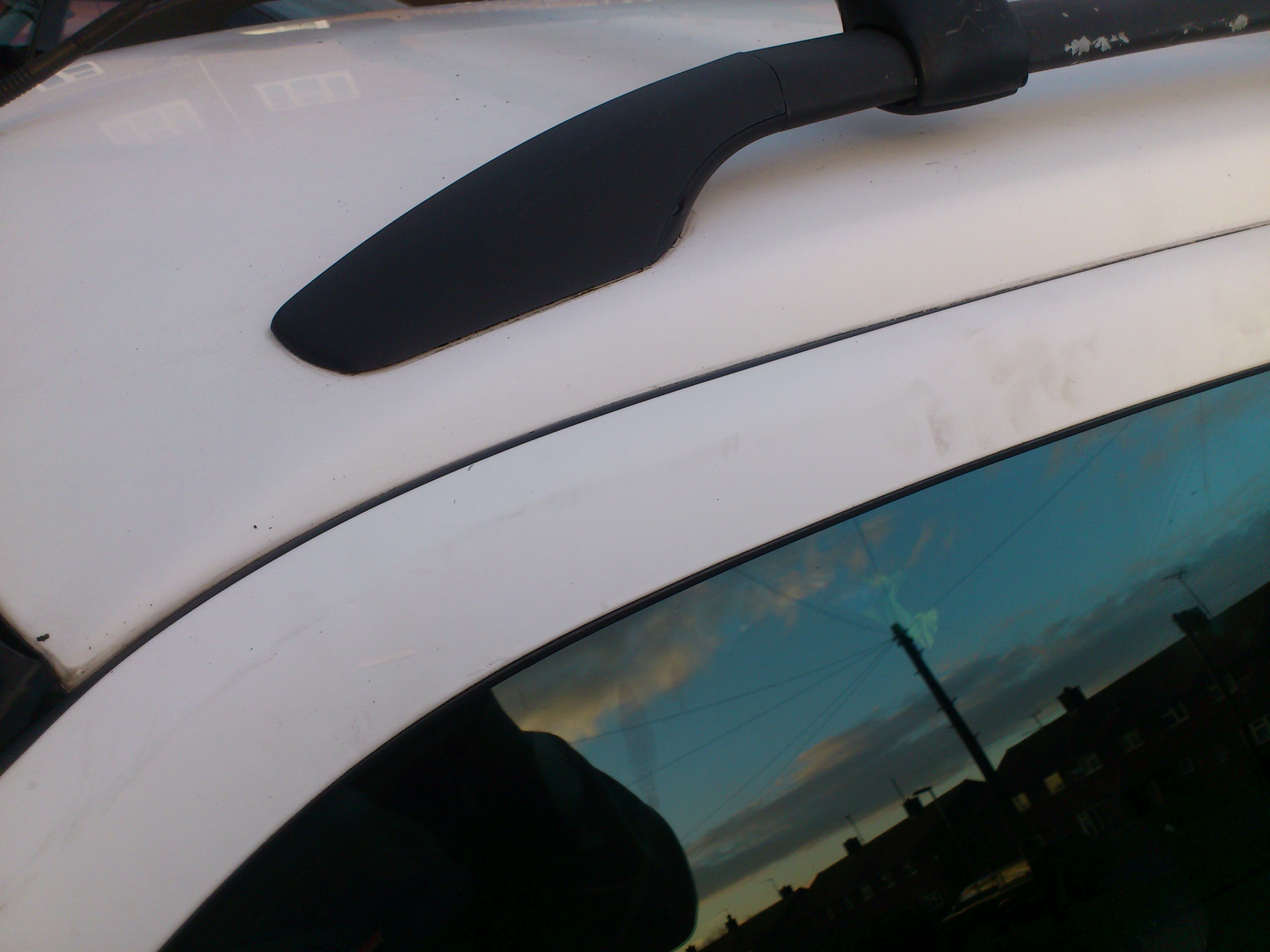

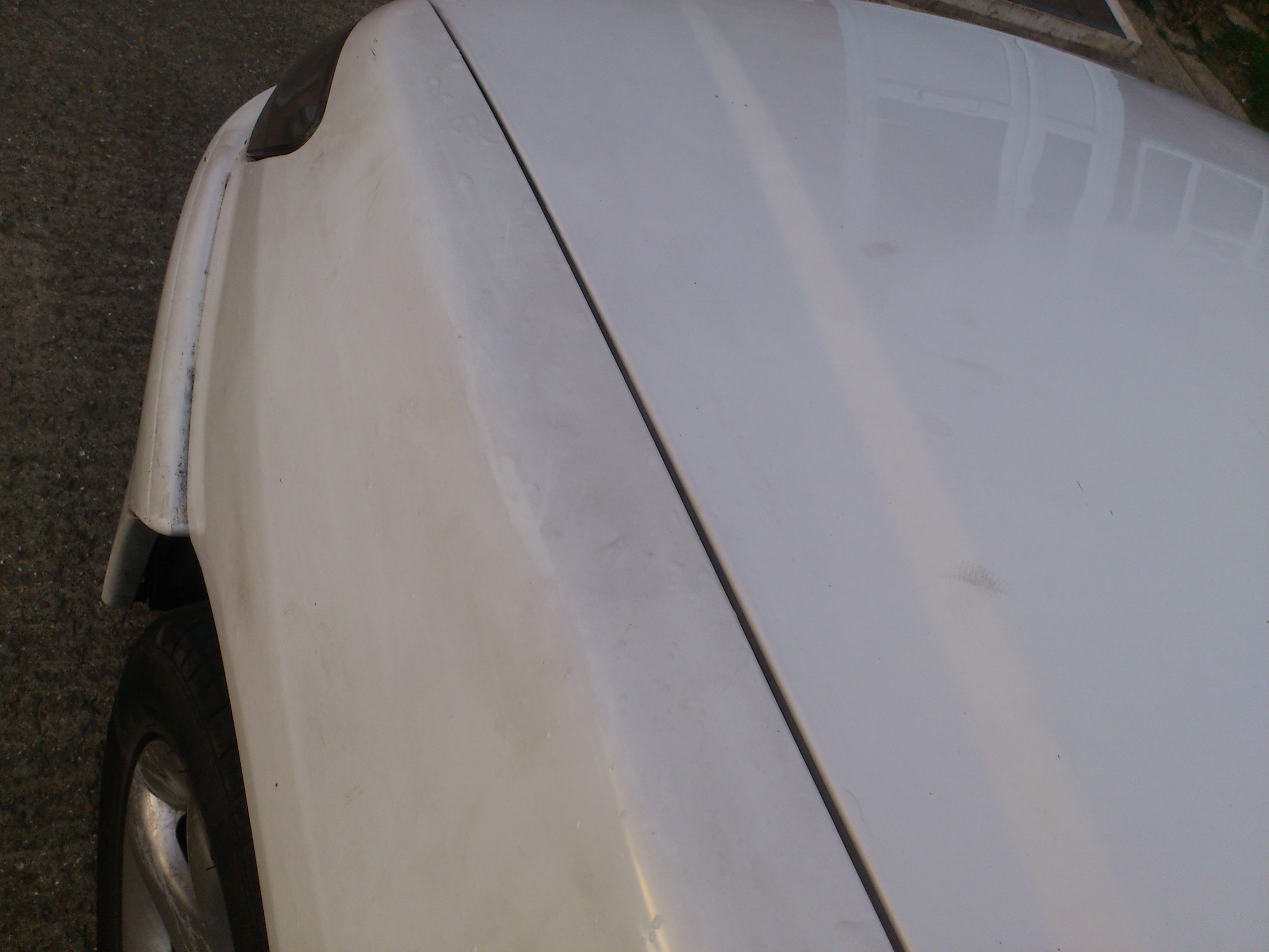

cheers it hasnt been buffed up yet just clayed and cut to get good paint i need a new or repaint the front bumper and trim needs replacing under drivers headlight and idealy want rear bumper and a quarter painted but thats me bein fussy lol
before
after need to get more pics when polished and wax still needs a machine to run over it to get a shine

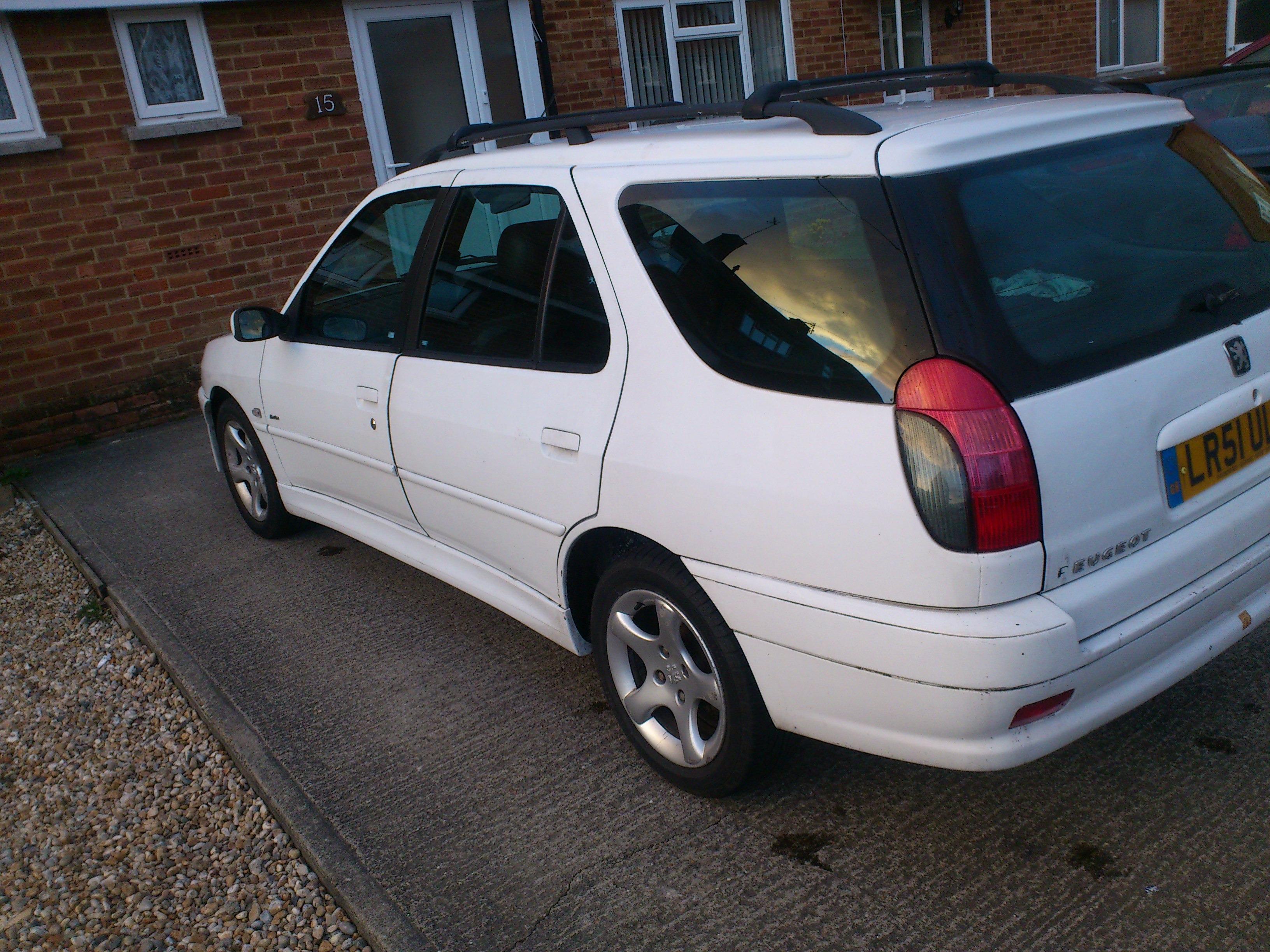

also its been de badged at the back and doors and removed the roof bars so will be selling if any one is interested
need to get it polished up now and get bumper fixed ... do i do wheels gloss black or graphite as tinting windows and was going to do bumoers gloss black and white and side strips carbonn wrapped

as u see in the first pic all off the car was actually like the wing i still need to run compound over it again then start polishing it back up has it got a clear coat ?
what did u use to get it looking that shiny i like that bar the flowers Smile

bit off a update havent been on for ages
i have painted mirror covers,roof bars, wheels and front badge and top of rear lights
i have carbon wrapped the pillars to cover the dull standard ones
fitted led side lights now to get ice white head light bulbs and tint headlights
