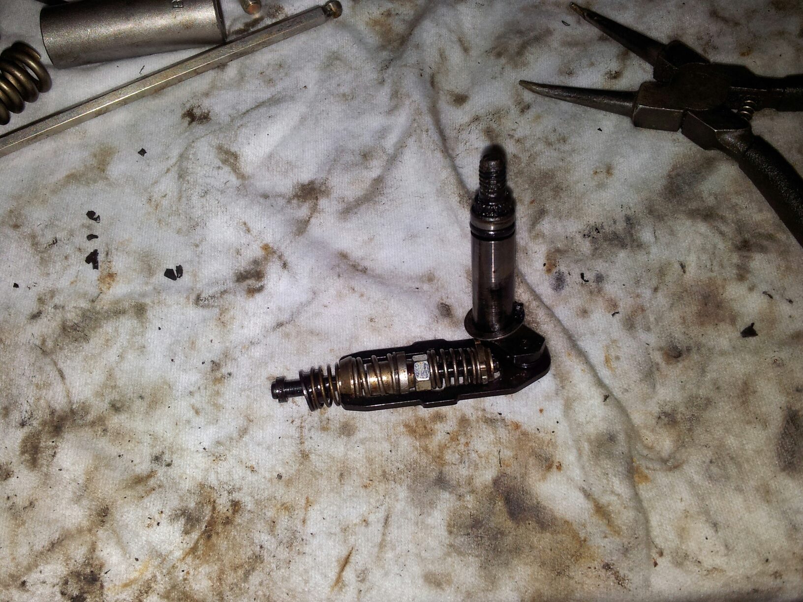

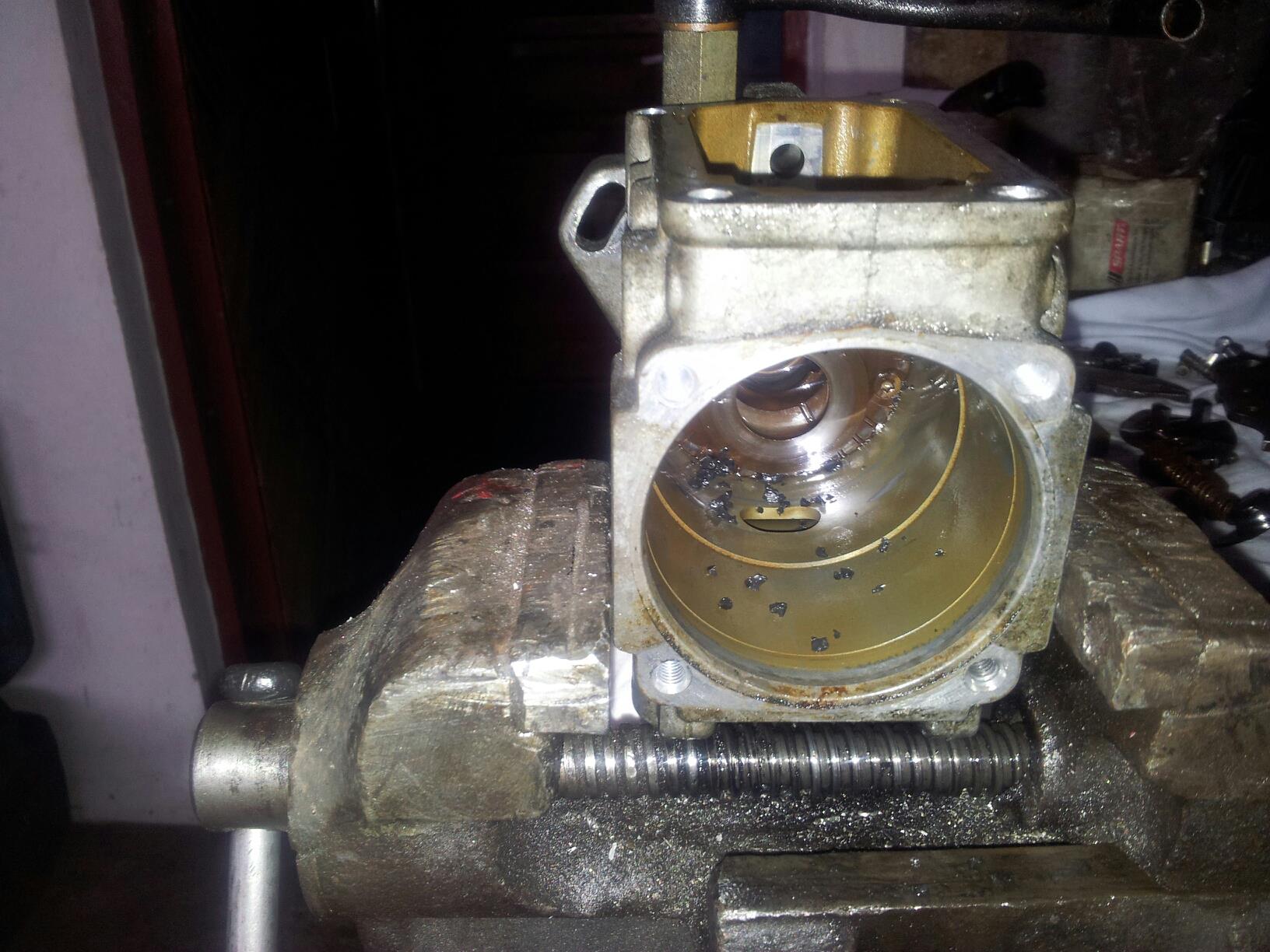

Attached Files Thumbnail(s)
Has a spring fell out when u put the head in, I wud remove and have alook in
Lol that sounds epic!! haha love advance like that (although will kill your block long term!!) Does sound like your fuel timing though... knock your pump right back and see if it changes tone - if not it'll be something else.
