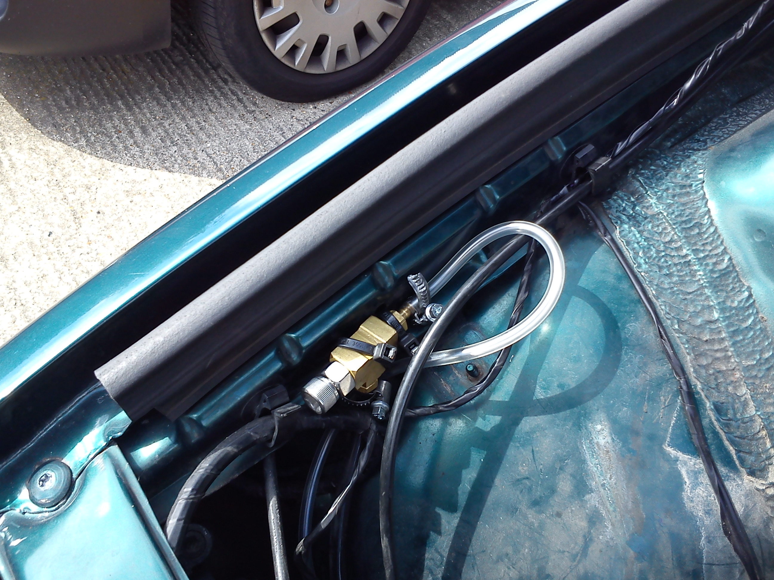

So, the reason why I couldnt get the boost controller below 24psi.
[attachment=2]
[attachment=1]
[attachment=0]
Yep in case you didnt guess by the picture titles thats a couple of inches of the hose from the turbo to the boost controller.
I think I must of blown it when I pegged the gauge as I heard a pop just as it hit the fuel cut and I felt like I was going backwards.
