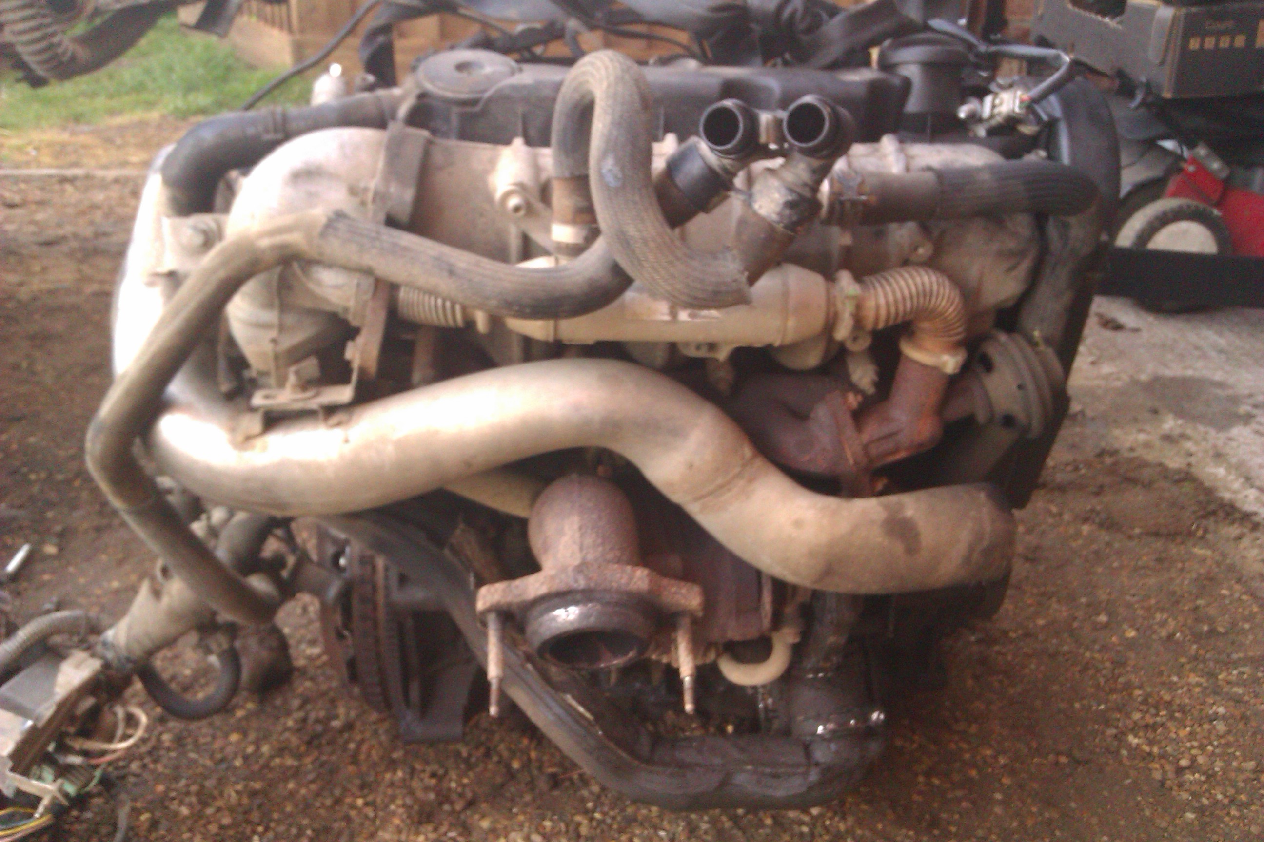

Ok how much of a pita is it to remove the inlet manifold so i can clean the ports etc., I suspect they may be blocked. The reason being the engine seems to make a knocking noise on one cylinder, due to combustion i think, and, when the air hose is off the main intake pipe there seems to be a slight "blow back". The turbo seems to be all ok but the slight blow back may be because of a blocked inlet track in the head/manifold ????

It's easy enough with the engine out of the car but pretty much impossible in situ I would think! Highest miler I stripped was 170k though and the inlet was barely chocked at all, 1 or 2mm max. Nothing like the PD Golfs that really coked up by 130k.

Thanks especially for the picture of the manifold.
