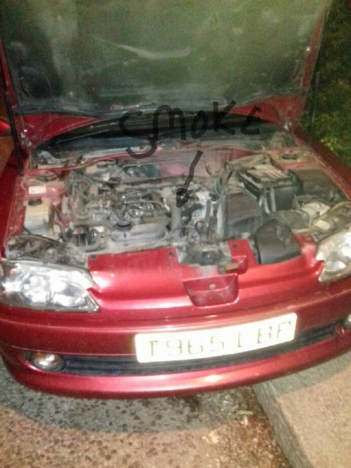

The white stinky smoke from arrowed area. Alternator over on the left side of engine
The noise/sparks/smoke at start could be a shagged starter, but the rest of your description sounds like alternator. Maybe two issues.
Could it be starter failed causing direct short to earth? There is a cable from the alternator to the starter then up to the battery.
(08-07-2017, 10:17 PM)apples76 Wrote: The white stinky smoke from arrowed area. Alternator over on the left side of engine
not sure, but I think the starter is at the back of the block. Anyone confirm/correct this?
Hate Housework!
nope, its on the front.
