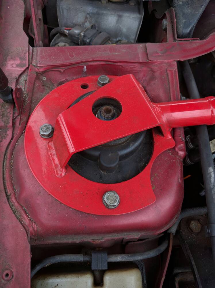

This is the drivers side top mount from the front of car     Seems fine to me as I don't think you could fit it the other way.

Top mount bolts too long, or are you using stock ones with the brace?
(07-09-2016, 07:28 PM)Rippthrough Wrote: Top mount bolts too long, or are you using stock ones with the brace?
I didn't fit them. So don't know. I bought the skf top mount kit from euro car parts. And didn't even open the box, so don't know if they came with bolts.
What would I be looking for to check if they were too long?
Thanks in advance.
Just whip them out and measure the lengths - although generally if they say 10.9 on the top they're probably OE ones.
You won't be able to see if the bearings are in upside down with it fitted, you'll need to drop the top mount out and dismantle to check it.

Your top mounts might be incorrect? On mine with SKF top mounts and the OMP brace, the fourth hole has a little metal pin sticking out of it? I'll take a pic later on today hopefully.
Also, are the bolts on the strut mount tightening up? You do need longer bolts but only 3-4mm.
(09-09-2016, 01:01 PM)BiG K Wrote: Your top mounts might be incorrect? On mine with SKF top mounts and the OMP brace, the fourth hole has a little metal pin sticking out of it? I'll take a pic later on today hopefully.
Yeah you could be right. I say that because I can't imagine it's the b8 eibach setup as lots of people run them and nobody has mentioned a compromise over stock.
The car is at the garage so I can't look at the top mounts. And the photo I've taken and posted above is at an angle, such that the 4th hole isn't fully visible.
But I'll pop over there tomorrow and look and compare with your photo.
If mine doesn't have the little metal pin showing... Would that indicate the bearing has be put in upside down? Or?
I wish I'd opened the box now because I can't picture what they look like not installed.
Thanks again. Really appreciate the help.
The pin is on the body of the top mount, entirely separate to the bearing. If the top mounts were for a different vehicle i'd be very surprised if they could be made to fit at all, it's not like VAG where you can get 4 different mounts off the same reg all with 2mm differences. If those bolts are standard length i'd be getting some longer ones rather than trying to tighten them as hey are - they don't have a lot of thread in the top mounts even without the brace, it'd be very easy to strip the threads out of your nice new top mounts.
The reason it's a common mistake is because the bearings come upside down in the box to save on packaging space, they have to be flipped before installation.
