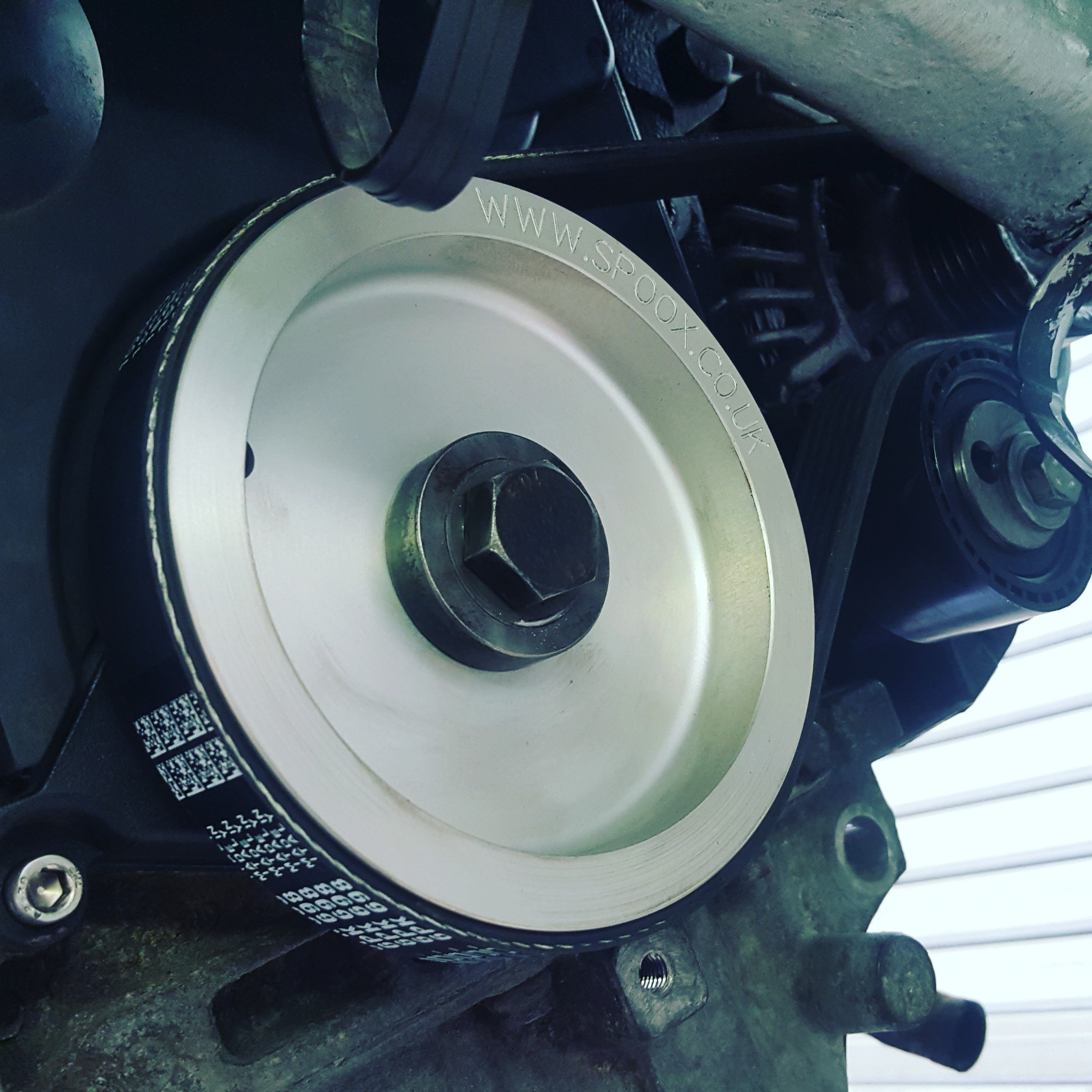

New aux belt route complete with new crank pulley. Used a slightly modified hdi cambelt tensioner
