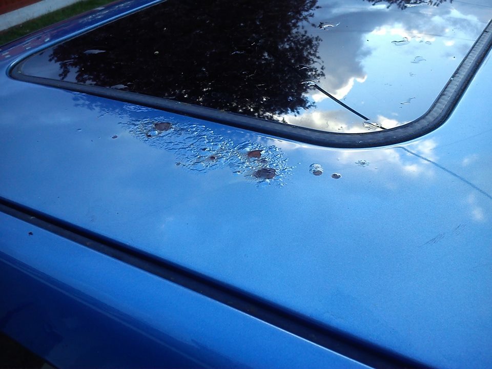

    Seen a clean 306 for sale but the roof is beginning to rust. How much roughly should it cost to get repaired and painted? I dont think it looks too bad but i dont know if it will be a big job or not. Thats the photo of the worse side its the same on the other side of the sun roof

That's pretty fcuked dude, don't buy it to fix, buy to run into the ground.
Any idea roughly how much it would cost to fix? Didnt realise it was that bad, maybe give it a miss
As said that's from the inside so would say its pretty knackered, roof skins are only thin, I'm not a bodywork guy though so others may know better Smile
Thanks matt, its just that the cars so clean apart from the roof and if it isnt too much i might consider buying it.
that needs a new roof, quite a big job, windscreen out.
I'd be checking the rear arch, bulkhead and chassis rails as well, I doubt it's as clean as you think without digging further. Smile
What causes the roof on a 306 to rust out?

The sunroof...
peugeot doing something very daft 23 years ago.
spot welding the sunroof frame to the roof skin.
citroen did it the right way, plastic frame bolted to captive inserts at the top of the pillars.
blocked sunroof drains dont help.
feck me..... thats bad, you can cut, and weld a new piece in, but that again is alot of work, plus how far has it gone on the inside. bit of a can of worms to me Smile
