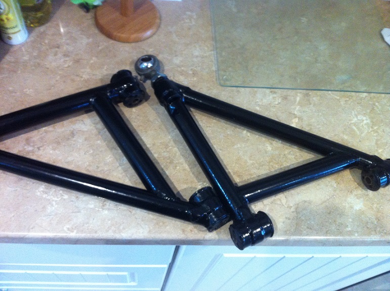

refurbing all front suspension , here are the PTS tubular adjustable front wishbones , ready for going back on car

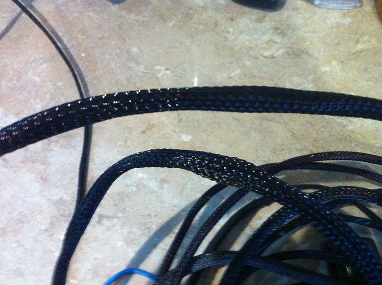

started making lightweight motorsport loom all with overbraid
Those bottom arms are a work of art!
(18-01-2016, 08:32 PM)roland rat Wrote: Those bottom arms are a work of art!
yes mate ,they are genuine PTS bottom arm i got hold of ,slily money to buy new for what they are
how on earth do you thread braid? (respect!)

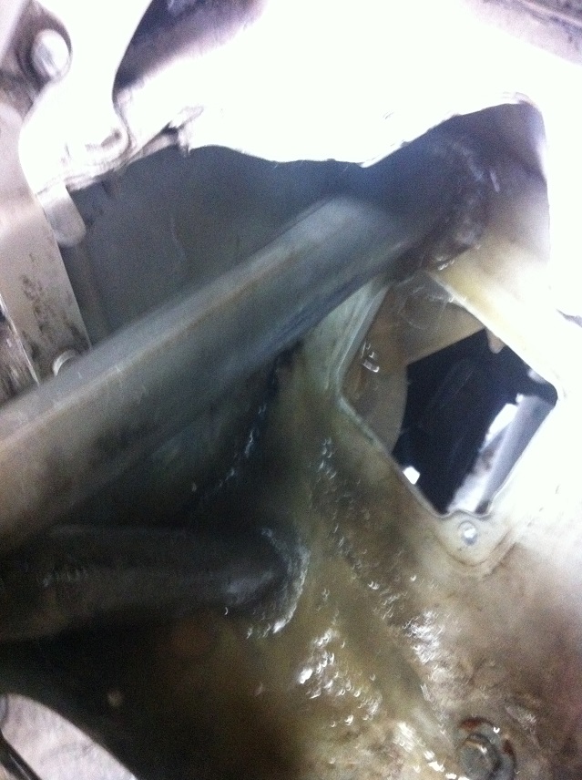

How did you ensure the subframe didn't warp while welding may I ask?

(18-01-2016, 10:12 PM)Piggy Wrote: How did you ensure the subframe didn't warp while welding may I ask?
Loving this by the way... Only project that makes me want a perv
to stop subframe from warping when welding  you do  a inch weld 1 side and then weld opposite side and  so on , just not concentrating welding in any one area , it just take a bit longer so as not to get any heat distortion mate
Righto. I wasn't sure if there would be a need to make a jig to hold it see

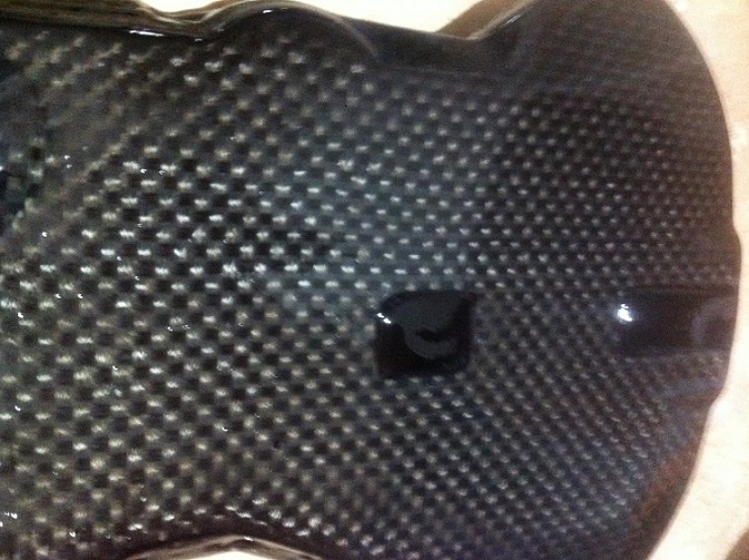

right found out nobody makes carbon fibre cambelt cover ,so made mould and layed up in carbon fibre , so will remove tomorrow and see how it turns out like .then might make some more
right  pulled first carbon cambelt cover from mould  , but decided to make phase 2 cambelt cover , so  just ready for final trim and flat and polish ,ready for engine build

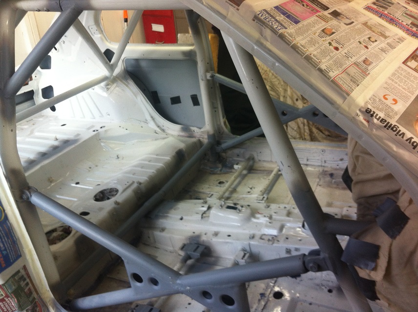

    with engine getting rebuilt ,decide to start on other mods , so stripped interior ready for cage work ,am adding extras to door bars and triangulating to front top mounts and strengthening in a few more places as my kids drive car aswell ,so safety has to come priority , will add more picture as go along

[attachment=26657]got a bit more cage work done today , got both x door bars in and rear  main hoop sections in ,and got one side of triangulation to front turret ,hopefully will find time to finish drivers side triangulation to turret this week , then can prep for paint. fingers crossed

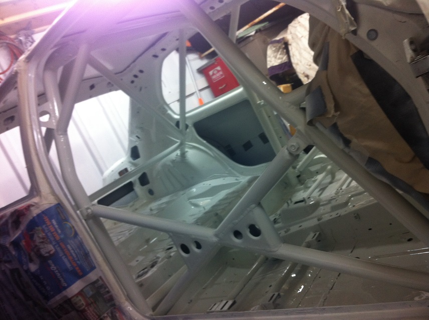

managed to triangulate drivers side strut turret  , and modified original wiper motor by turning motor and drilling the 3  fixing holes that hold motor and trimming mounting plate , so all fits in original mounting holes , so  primer new cage work this weekend hopefully

finished fibreglassing bulk head and managed to mask car out , and primed new cage work ,then decided to go for it with being mothers day tomorow  . so ended up painting inside ,will start fitting up inside this week
