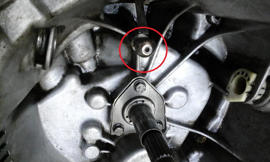

can this round thingie be removed? it fouls the fork that actuates the thrust bearing and cannot be installed without removing the metal sphere shown here.

the box is off of an NA 1.9 diesel and is getting mounted on a dw8. before it had this welde together jobbie where a fork sticking out of the box used to swivel on that metal ball and when you pull the cable the thrust bearing would work.. this looked like a proper hackjob to me so i tried to convert it to the later style found on the dw8 i.e. still cable driven but much more sturdy and safe imho. the problem is the new system includes kind of a pipe which goes from the yellowish white piece of plastic seen in the pic to another piece of plastic with a fork attached to it linking it to the thrust bearing. ill try to whip up a paint diagram to explain it. thanks for the help till now lads!!

can't i just grind it off or chisel it off? because apparently it doesn't screw off or pull out.. i tried... :/i wanted to use this box because I already mock fittef it to the engine and everything lines up correctly and..well..it's available and free..
It looks like for the fork arm to pivot when a hydraulic slave cylinder is used to move the clutch.
206s have similar setups.
I've removed it before (on a later box) and its on a taper like a bleed nipple for a brake caliper (though on a larger scale) so I would say there is oil behind it.
If you set on using the box, would need to refit a bolt with a taper. Its thread locked in so will be a bit stiff to break the seal.
Looks like a BE1 gearbox to me which would make sense if it's out of a 205. The clutch fork setup is quite different and pivots on that ball.

late be1 boxes have the holes for the be3 style clutch arms, the ball pivot should just unscrew.

tried unsuccesfully to unscrew it. problem is there is no nutlike part which can be grabbed by a spanner so it keeps sliding.. was thinking just grind it off if i can fit a grinder in there.. a dremel might work actually.. thanks for all the replies guys!!
