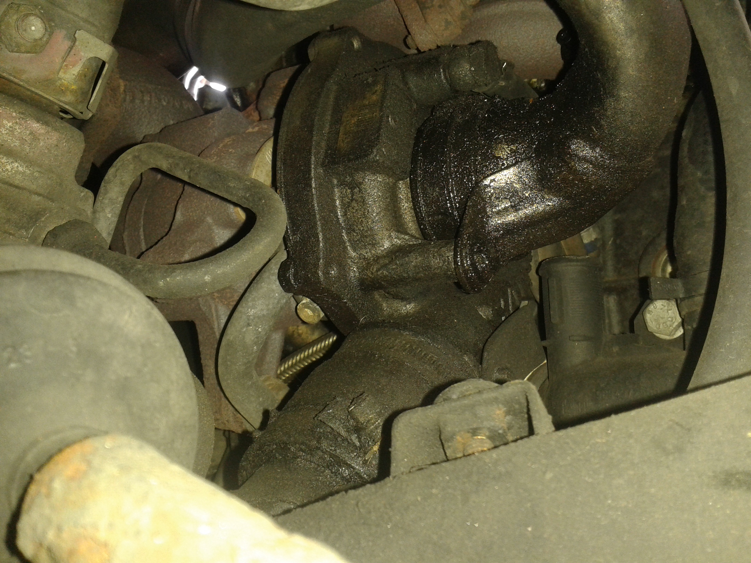

Whats your views on this dirty turbo Sad
Spotted this too, does this clip look like its on properly???

its got me a little bit peeved and concerned :/
i wouldnt worry about the sucky side its the blowie side that needs sealing check the manifold bend wher the egr bolts they tend to blow from there spraying black gunk on the bulkhead

checked those last time and resealed the inlet with gasket and sealant, erg blanked at the same time, no tell tale signs of leaks but sounds like the leak is from drivers side Sad no noticeable power/boost loss but hard to tell with a slippy clutch :/
cheers for your input, thats put my mind at ease, what about the clip thats circled, doesn't look like its on properly???
clip looks ok to me

ok cheers mate, just looked a bit suspect to me Wink
is the click locked??
I have zoomed in but still not entirely sure the clip is locked?? does it rotate freely? if so then its loose.........if not then its locked
It looks loose/unclipped to me
i thought it did to me too, thats certainly not how i would have left it...f*cking mechanics! lol

What is the pipe for, that the clip is on? Vac or oil...Confused?
Wastegate vac pipe?
If it is waste gate related, that might explain the sound I'm getting....?

If the pipe going to waste gate leaks, does it keep it open or closed..or what? If it does/doesnt, will this be creating the noise i am hearing?
