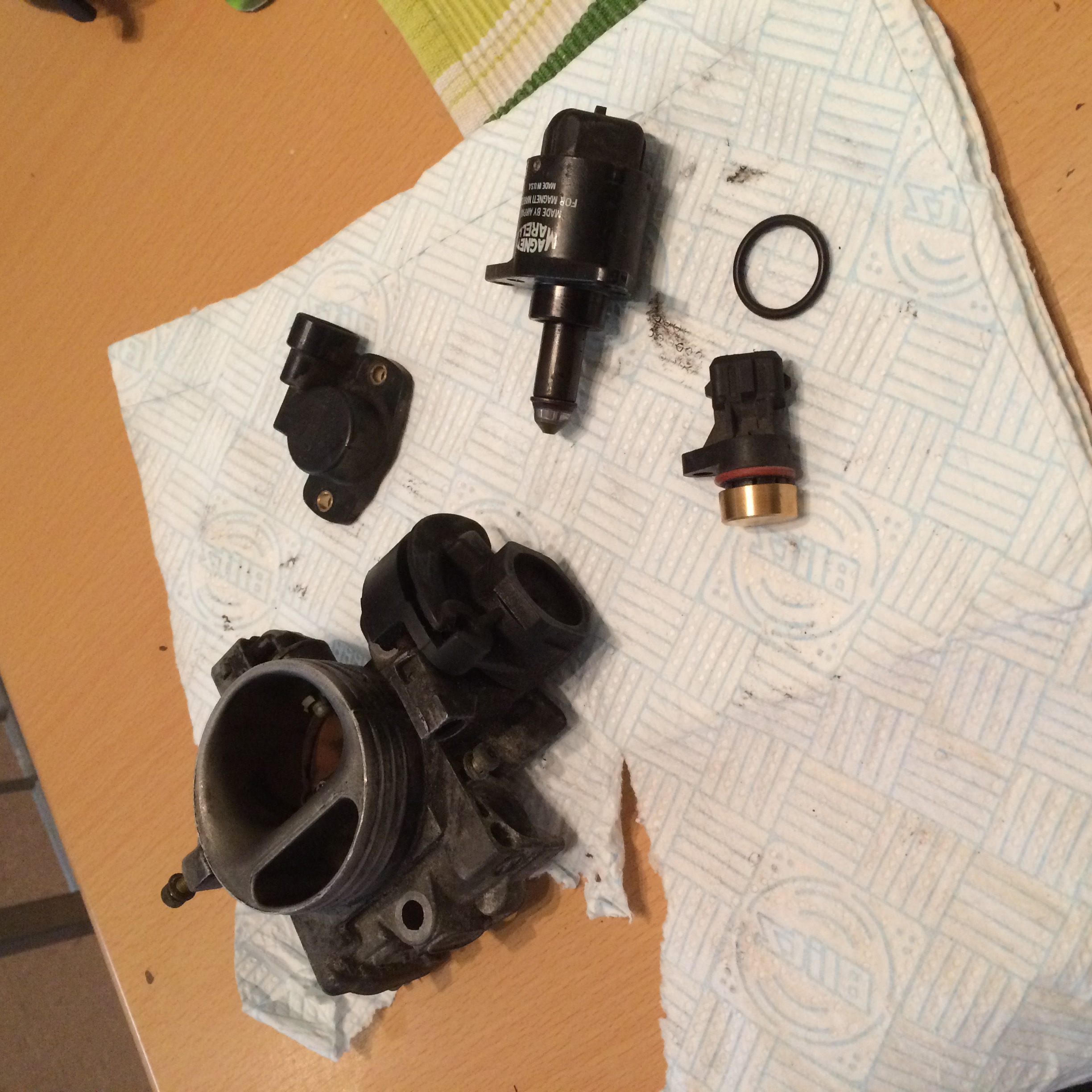

Most common cause of this is a blocked /dying ISCV (Idle Speed Control Valve) on the TU series engine (fitted to your car)
Its easy enough to remove and clean / test / replace Smile If i wasn't at work right now i would be able to post a detailed picture but there should be something about it in the guides section i'm sure!
Its located by the T/B (throttle body) and should have a 4 plug plug into it, the valve is secured in the T/B with 2x T25 (IIRC) Torx screws.

Cheers guys I think I found it was the manifold pressure sensor? Seems to bog out when I wiggle them a little so will chop and solder and get a new sensor! Hope this works! Thanks for your ideas guys! Will get most the (intake) box sensors done asap! Process of Elimination I think! Will try the map sensor first and will let you all know! Then throttle position,maf,and the icv cheers guys! So much help also already checked the fuel filter, plugs, coils, leads, and also electrical fuses, but thanks! Smile

HUHJust got rid of a focus as well!!! haha!!!! On board computer went so lost all power randomly, it opens your ring piece when ur on the motorway and the car acts like you've just pulled the battery terminals out!! Haha using ford!! f*cked on roadside dead is what it stands for right? ! Also I've cleaned the throttle body sensors on the pug and am aiming to get a new map sensor for Monday, let's hope this works! If not it's a lambda getting ordered Sad  cheers for the help though guys!! Smile
