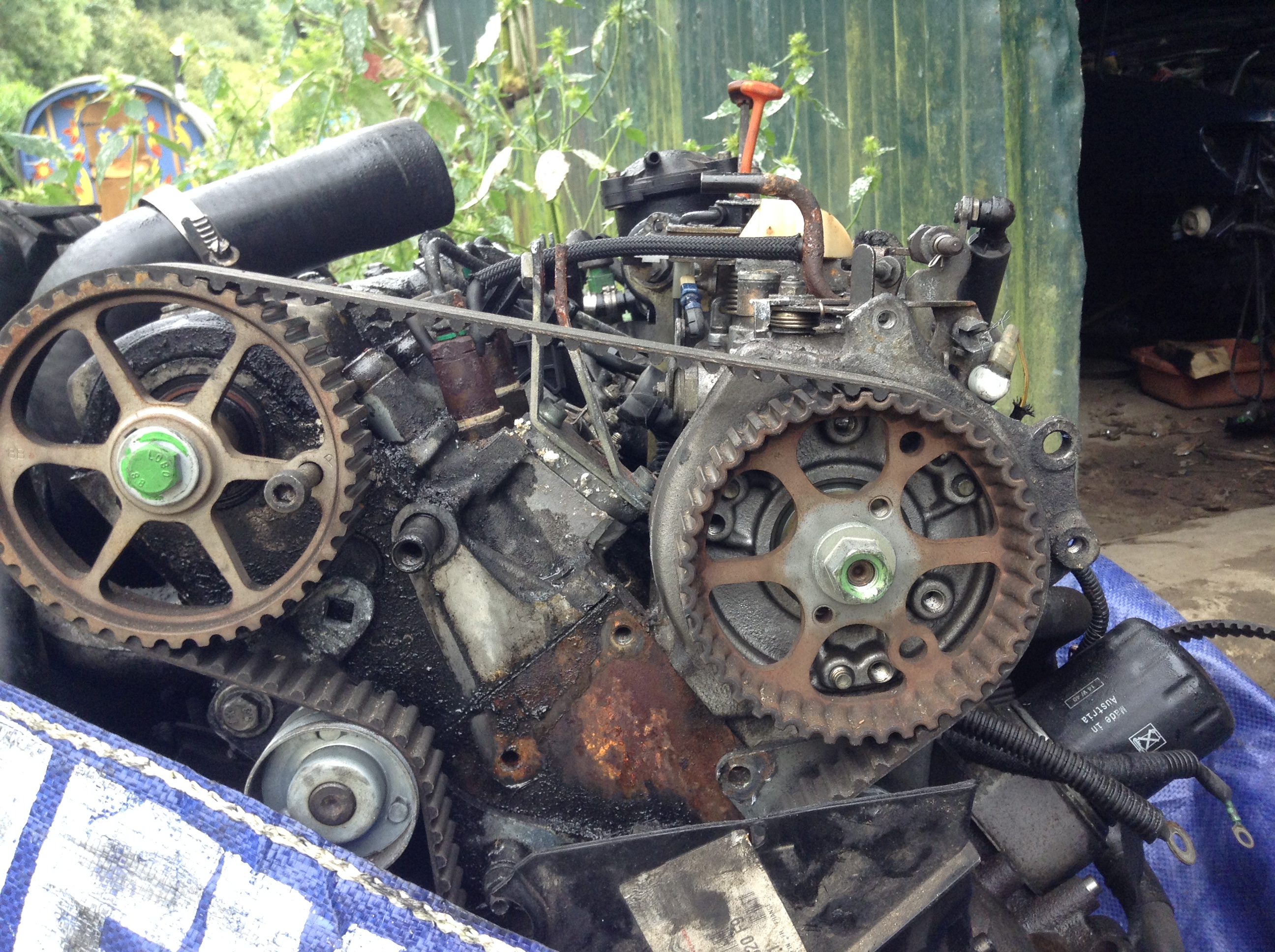

I was reading ruan thread about runaways and I'm really not keen for that, thing is I have got another doner car with a d8a engine, bosch pump, t2 turbo and hdi box but just trying to find the motivation to swap it all as im relatively new to machanics

Also if I disconnected everything from the donor car before, how long do u reckon it would take to swap it in to my car. Do you recommend hiring a hoist and possibly a stand and sorting it out abit or just chuck it in
