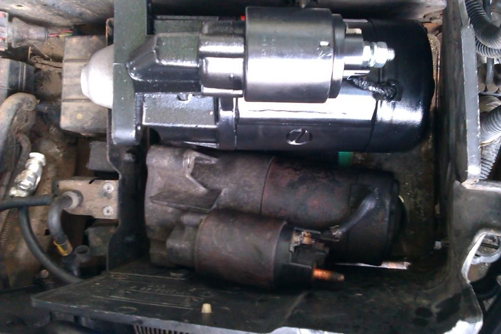

New vs old, old one has good brushes but was missing one of the two main long bolts that hold the body together. Can probably recondition it nicely for a few quid.
[Image: IMAG0271_zpsefef5b89.jpg~original]
