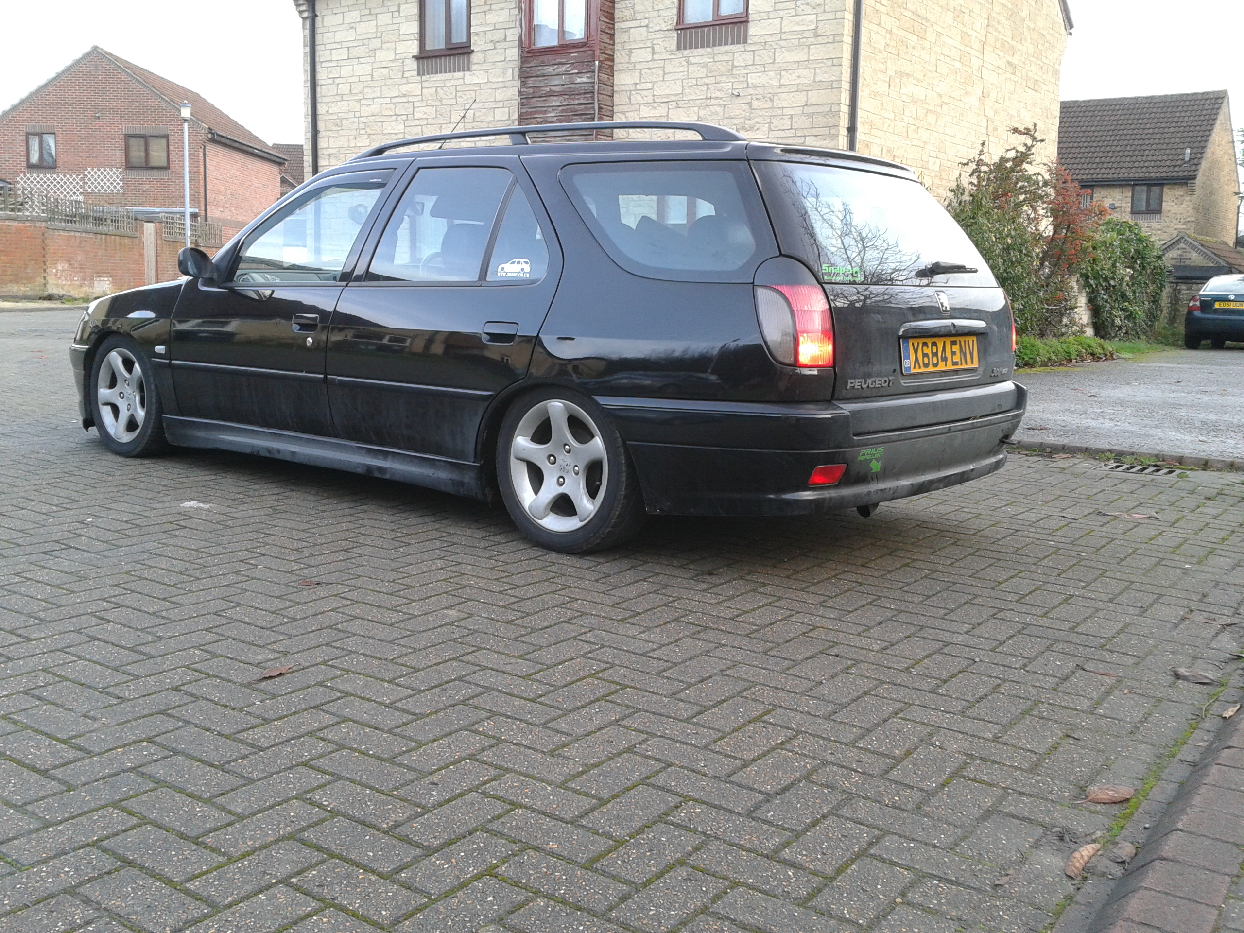

how much is that drop ? damn it's low low low ! looking good !
Im not sure fella , what ever raceland coilies are bottomed out 70 or 80mm i think

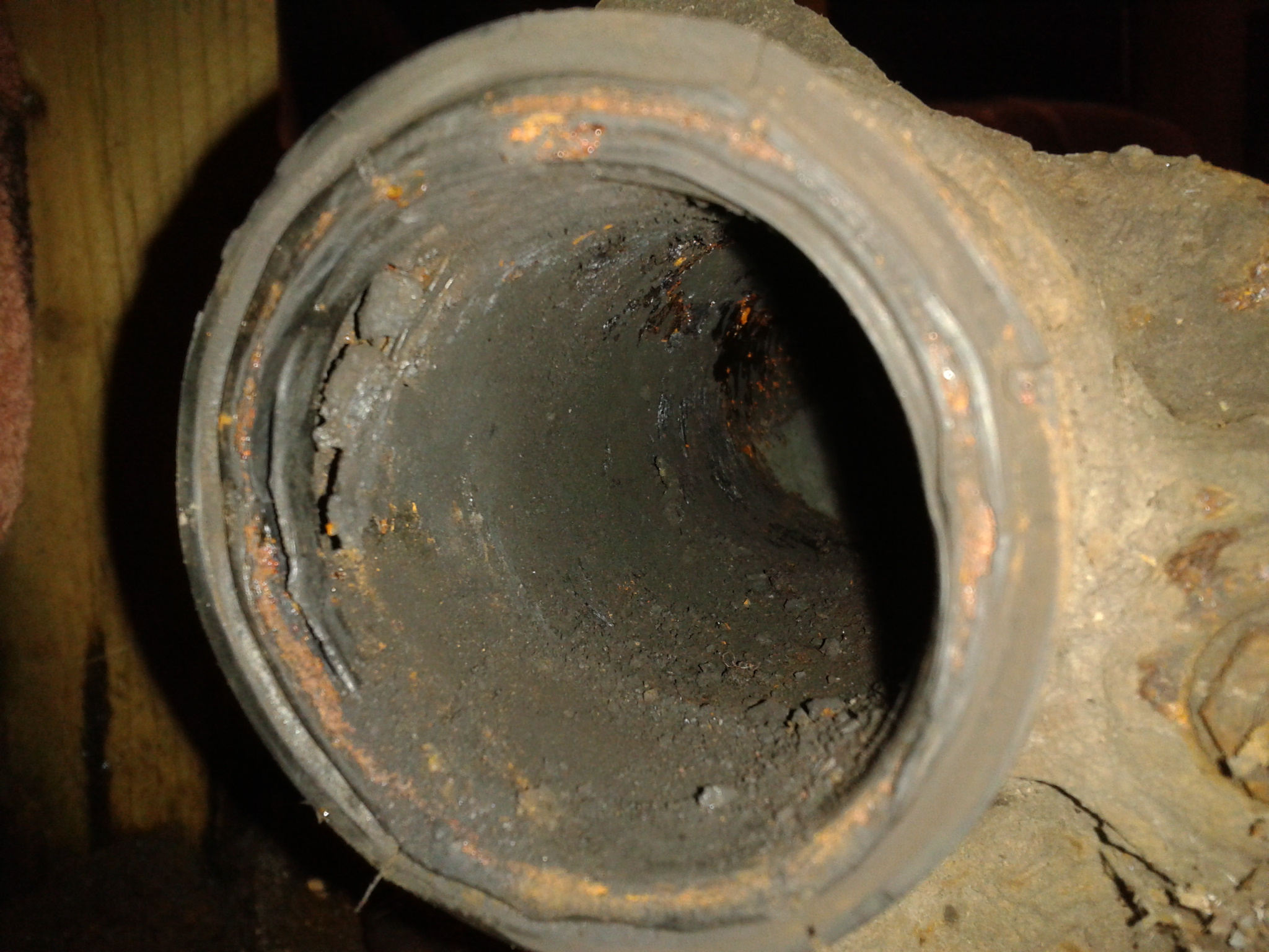

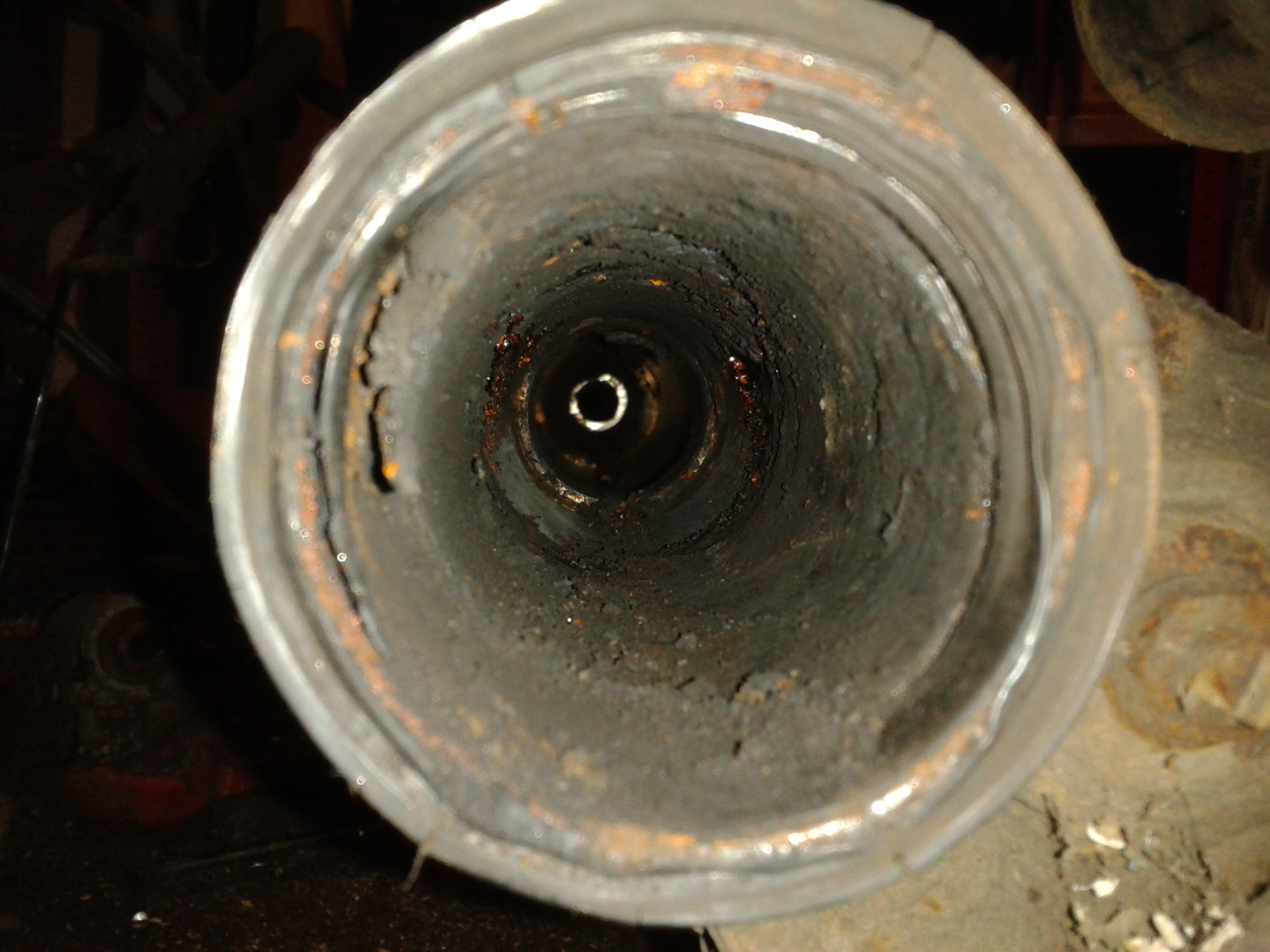

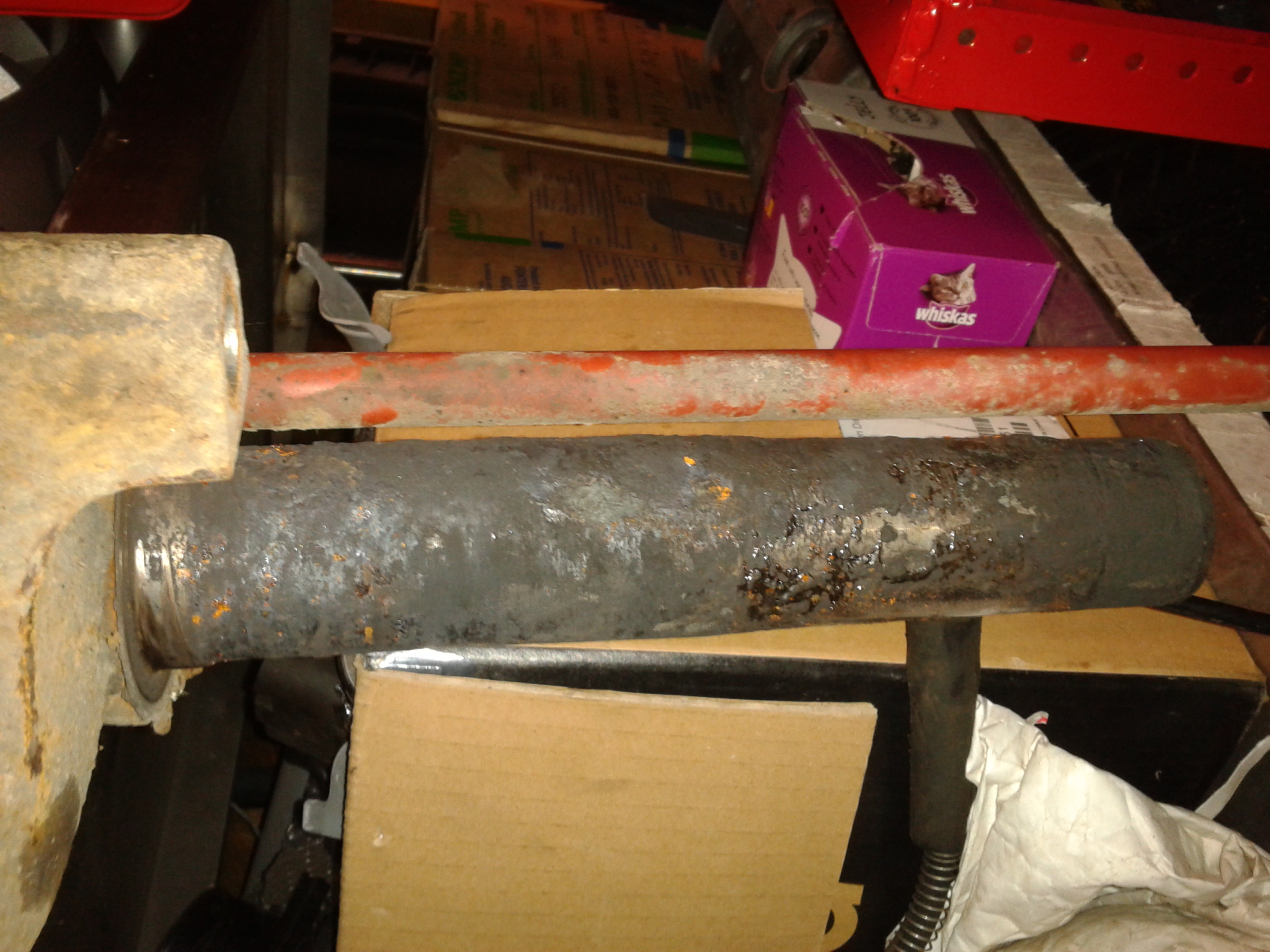

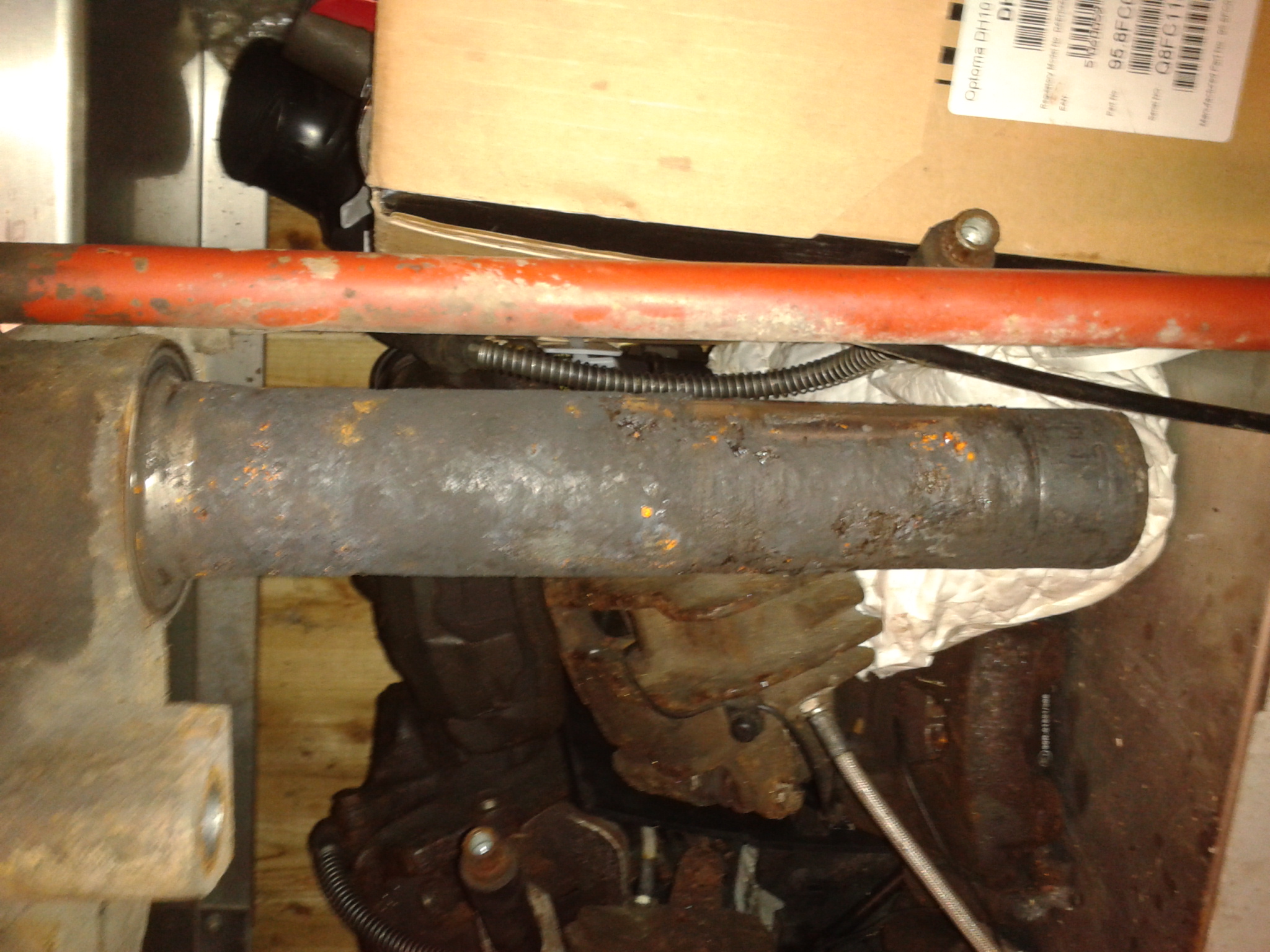

I took the old shagged beam that came on this apart today with the view to refurb but.......... Its pretty safe to say its totally f*cked and only fit for scrap, beam is dead inside it wouldnt even take a new bearing, the pins are scrap, & the TBs were so tight i had to smash the crap out of the trailing arms to get them out so they are pretty much scrap now,
So plan from here is to just use the 20mm TBs & ARB in the 80k drum beam, not ideal but will not cost me anything & and will give me a gti spec beam but with a good hand brake
haha holy shit, that is faaacked!
Thats worse than the one ive just replaced on the misses car and I thought that was bad.

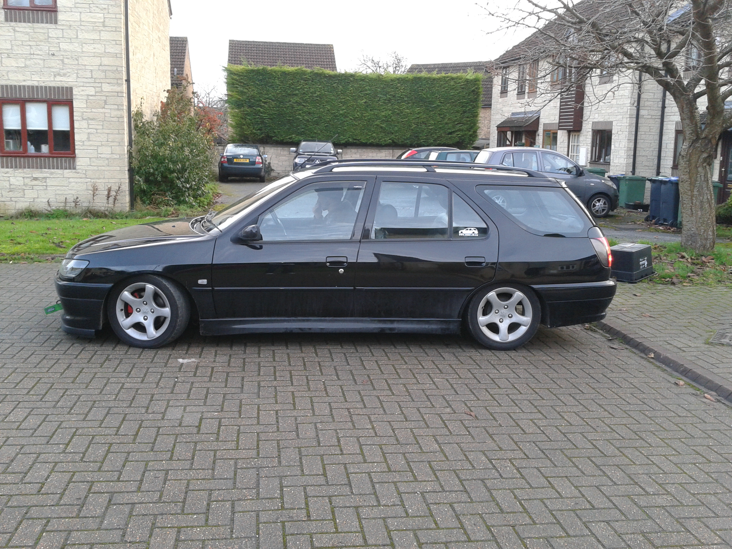

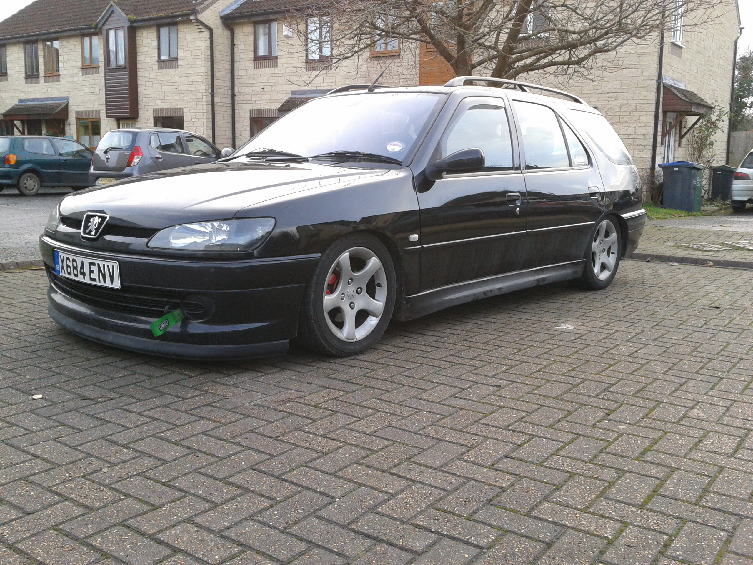

small update. fitted my gti torsion bars & Arb to my drum beam last weekend (drives much better now) and whilst i was at it i had to add more lows Smile
Excuse the dirt, currently in winter dirt spec lol

Could you measure from the bottom.of your front bumper to the ground for me? Lol
[Image: 20gh7o0.jpg]
uuhhh why? lol its on TAs wound to the bottom , with helpers if that helps lol
Just seeing what clearance you have being that low on 15s
Moar picturesss!!
(15-12-2013, 07:43 PM)rd070707 Wrote: Just seeing what clearance you have being that low on 15s
Ah i see well if it helps , they are 195 50 15's and they are onlly a couple mm smaller then my 205 40 17s which im guessing is what you have on atm,
