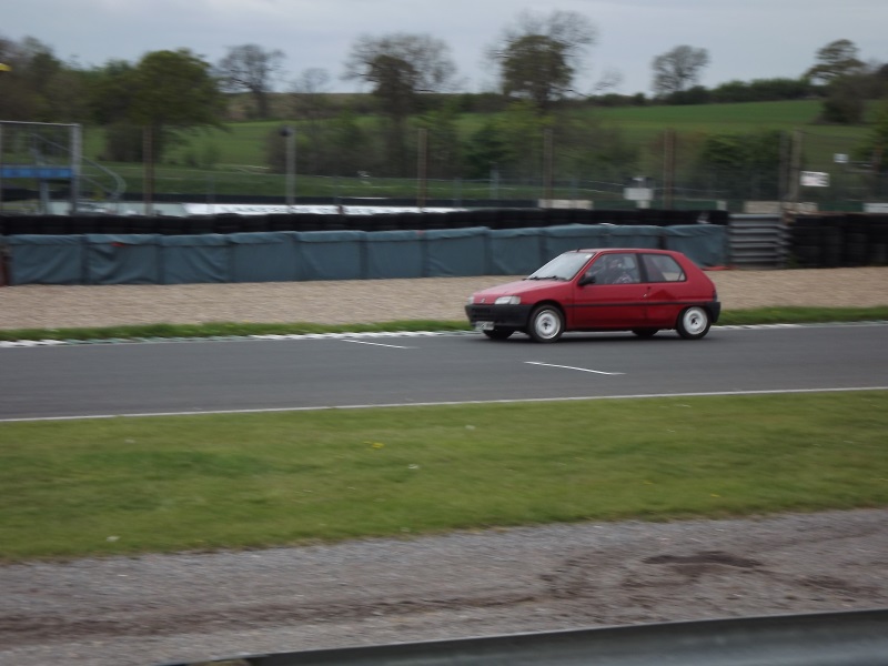

Took her up to PPCITP in may, took her round the track, COOKED her, oil temp at 135 degrees, water temp pegged at 120 degrees, so probably hotter, clutch was ruined, slipping like mad as soon as she got hot, but a cracking time anyway!!
[Image: attachment.php?aid=7242]
(pic stolen from Dum Dum)

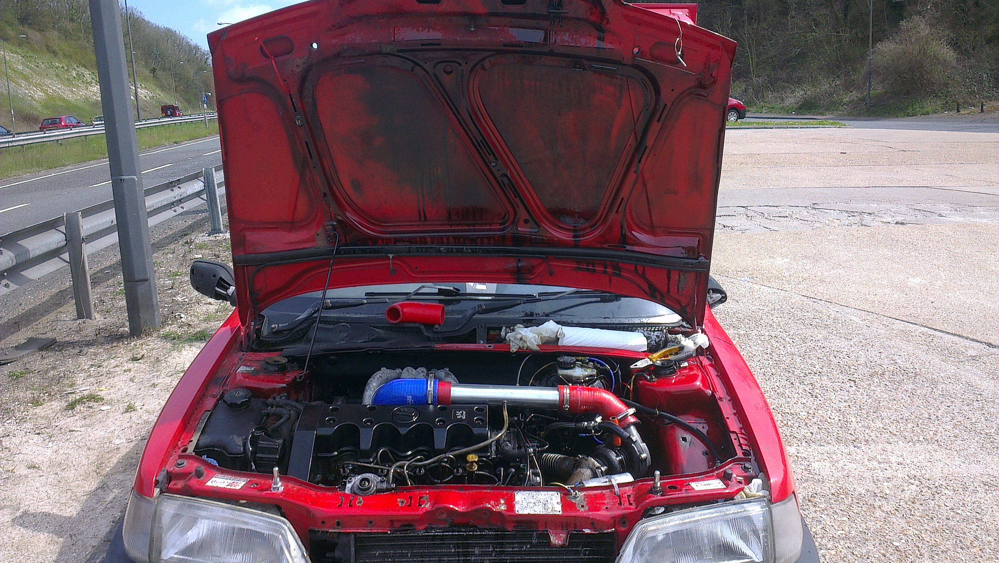

[Image: IMG_0844_zps8e0863a5.jpg]
(pic stolen from Carl)

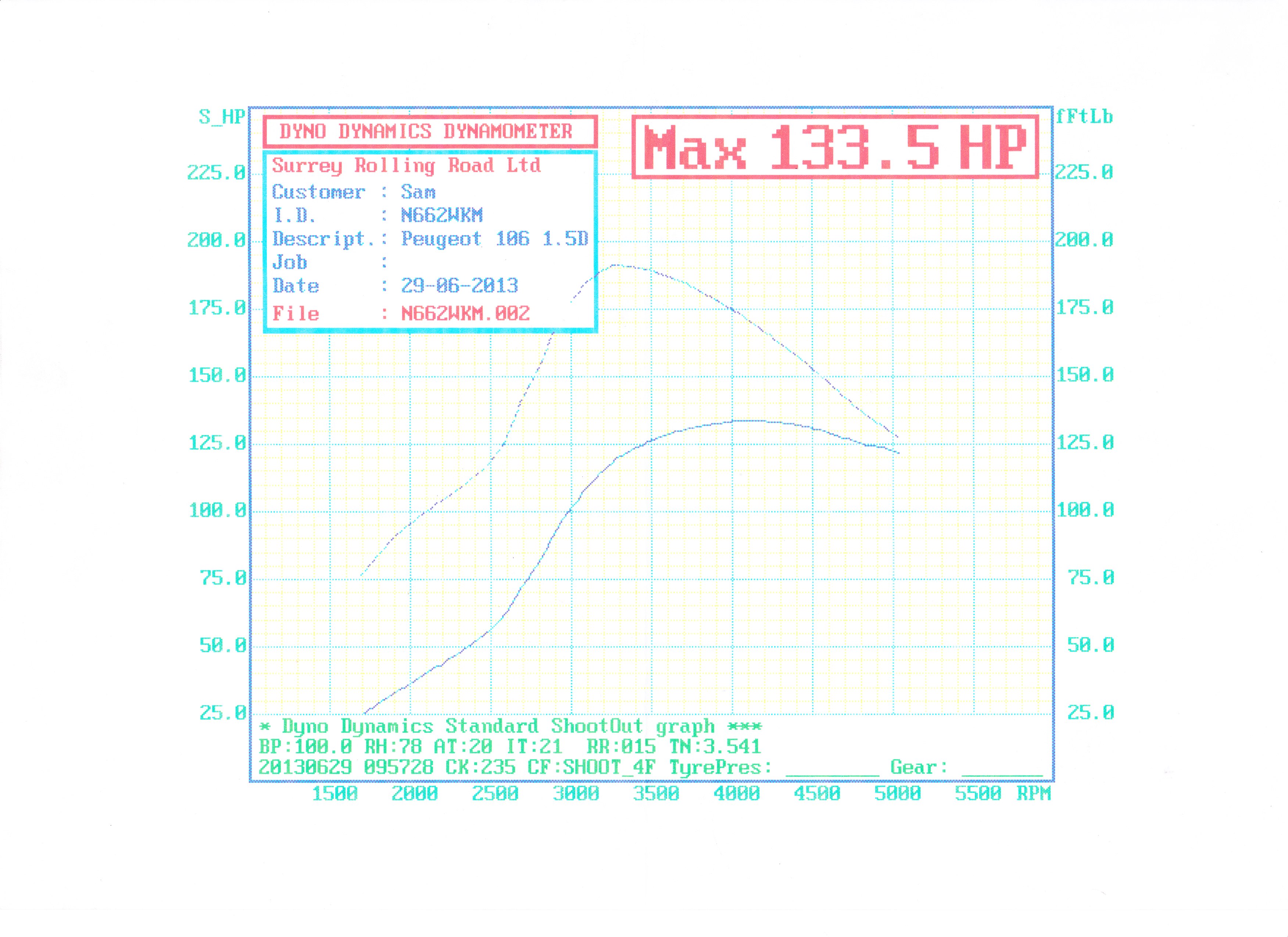

Had her on the dyno at the end of June, pulled 190lbft and possibly around 130bhp, but due to no rev counter I cant be sure of that result, but anyway, here's the graph.

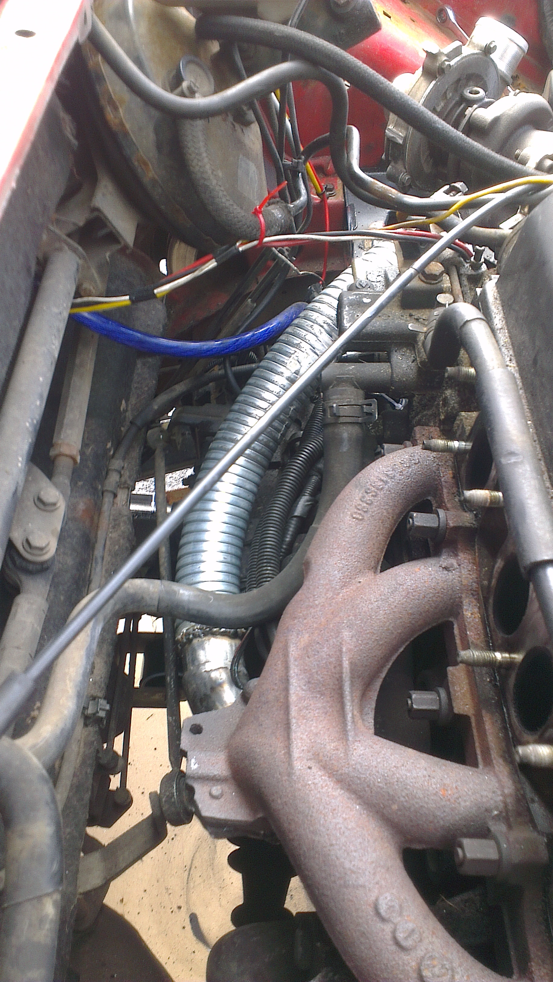

Currently she's broken, looks like this..
[Image: 270619_10152430678755476_2127976800_n.jpg]
Sandwich plate on the oil filter wont seal, at all. Needs a new filter insert.

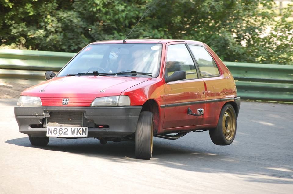

aaaaaaaaaand one last pic, mainly cuz I love the pic and i love to whore it out Big Grin
ABOUT TIME!
[Image: mcetg0.png]
