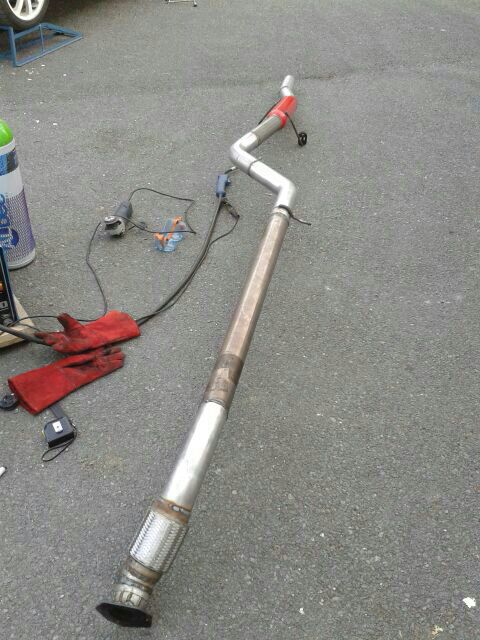

Ive got a hoffmann downpipe and mid section and ill agree its only cheap mild steel and it does have some kinks just cheap masproduced stuff the only reason for replacing most of my system had rusted so just hacked the mid box as my backbox and gave my old man my hand me down butchered downpipe, Had to replace one of the sprung loaded bolts as it snapped.
Its a good fit though, but going to replicate the system with some 2.25/2.5" stainless model when supporting mods warrant it.
Like i did with my corolla tsport
[Image: 1d02b155.jpg]
Just need abit of time....

As is above if you know someone who can weld then the mild steel tube to make your own system will be under £150 and you can make what you want then. I think thats what ill end up doing on my next car just so I can get a full 3" system.
Just build one if you can weld/have access to a welder
