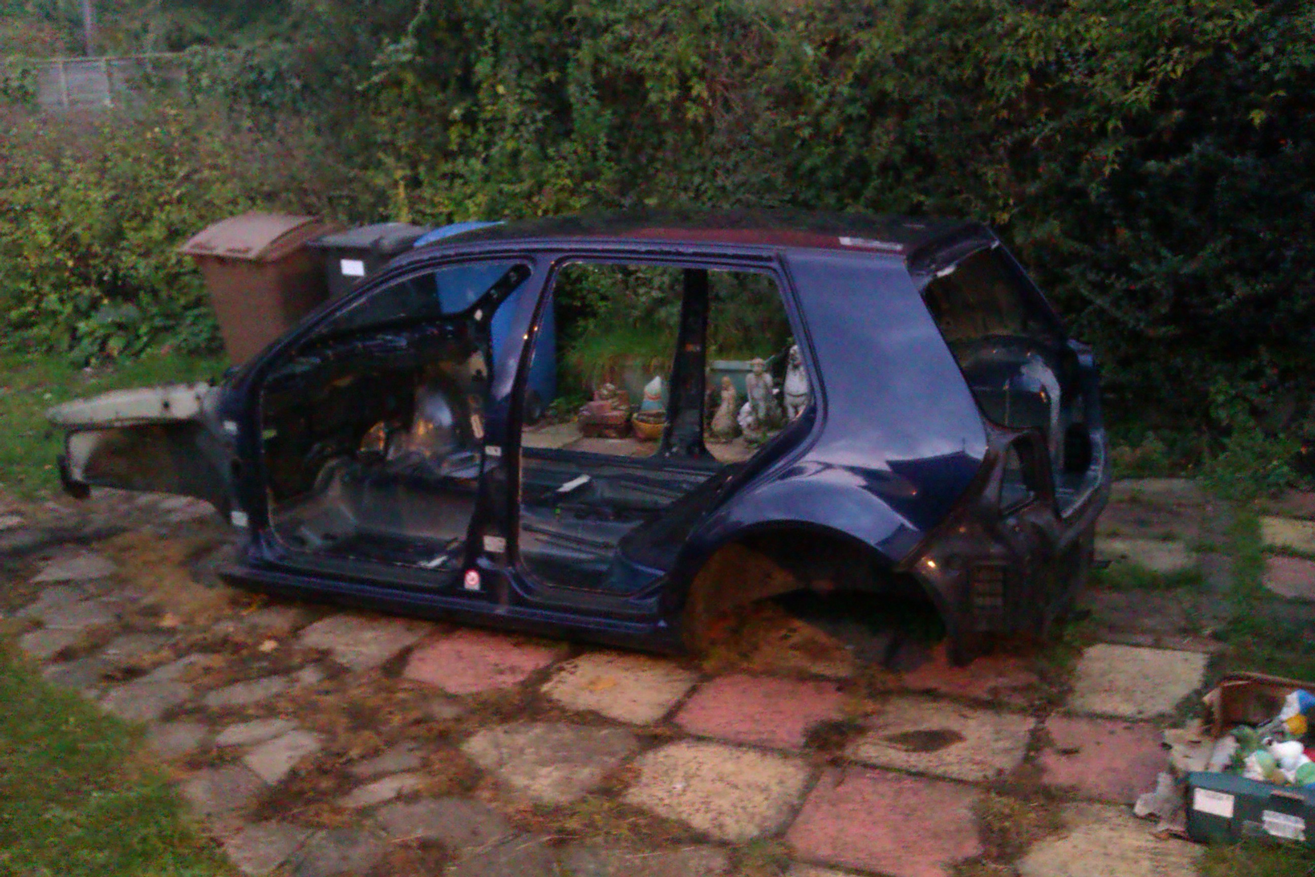

Looking at that I would cut it up. Rent a large grinder not a sthil saw a 240 jobbie should be cheaper than a sthil saw.
Edit - Brandon hire £26 per day.
http://www.brandontoolhire.co.uk/en/cutt...230mm.html
#32
two days is only 35 inc vat Smile cut more stuff up as scrap that way
#33
Hmm, good idea.
Btw, does anyone know how to get the window out without breaking it?
#34
Brake cable off a bike or throttle cable. Cheese it out!
#35
Damn FBW Golf throttle.... lol
Is that the best way though? Thought I'd be able to lift it with a chisel all the way round* but it didn't even budge!
*I was wearing the correct PPE for this before anyone says!
#36
Lift it with a screwdriver or whatever then tread the wire through and rub it. Like dental floss.
Or just cut it out with the rental saw.

my dad cut the mgf shell into pieces with a large angle grinder. he cut it up into 6 pieces. my local metal yard came and took it away.
make sure nothing is near the sparks as it will burn glass! my dad didnt follow that rule and his car window as a few metal filings burnt into the glass. also when cutting buy good discs too! my dad bought machine mart ones and they were dangerous. they broke or flew off the grinder due to the centre piece falling out.
or just hire a car transporter and winch the shell on to it and take it down.

Use the bonnet release cable for the screen what me and r45 did yesterday lol
And rent a disc cutter for the shell Smile

Well, thanks for the input everyone, I'm scrapping the loom, brake lines, heatshields and ac pipes amongst other things tomorrow so will ask them to collect the shell while I'm there. Saves messing about as I need the space now lol.

I just cut the plugs off and left it at that, also scrapped the AC pipes and ally heatshields. £14.
I was expecting to wiegh the brake lines in as well, thought were copper but they're magnetic so steel!! Will wait and get it all together before scrapping iron/steel as its worth sod all tbh.
Also got them to come and collect the shell so thats going tomorow and they'll sort the V5 as well.
