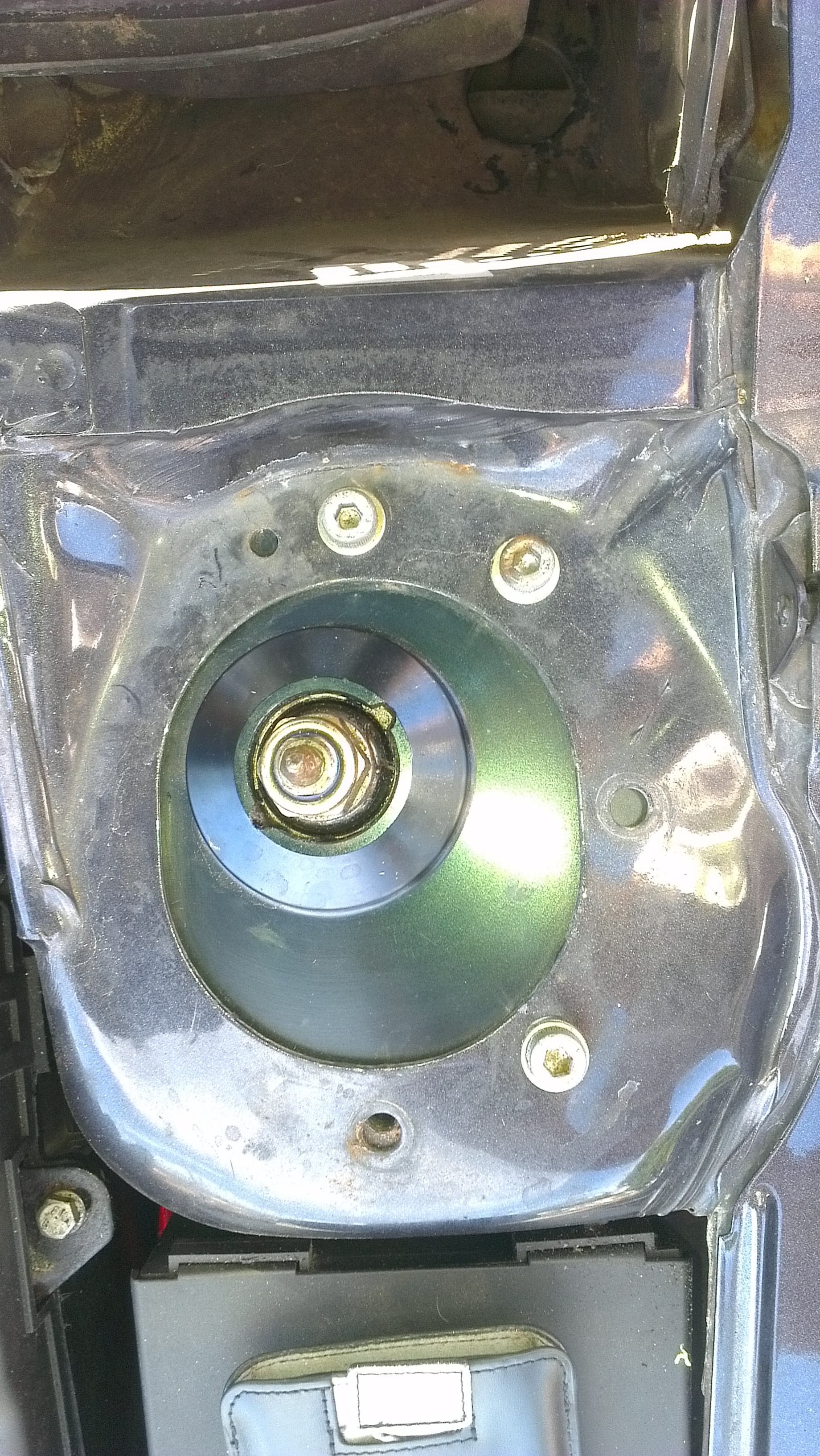

Mine are the same as Jamie's, the same as a couple of sets I have seen on the gti6 site, as for pics I'll believe it when I see it ha ha

Jonny has the same ones as me. If they don't line up, just drill a hole in the top mount, tap it then bobs your uncle.

Mark you got pics of yours fitted? Preferebly without the strut brace

I dont get it, why do they supply ones without holes round the full circumference? surely that's easier to fit and gives way more adjustability anyway?

No just with the strut brace in place.

Maybe mr compbrake can shed some light!! Or are they just piss and wind, Jamie obviously didn't get sorted, it's disgracefull that they can get away with selling a product that is supposedly a direct fit when it quite clearly isn't
Also the fact that people have got different products for the Same aplication

When I got daveyboy to fit mine, he said they are not direct fit.
He was the only person I knew who had fitted them on the six forum. I think I will be getting rid of mine soon and going back to standard. Or if I get a good job spend £250+ on a direct set. Either the baker ones or the home made Russian guys ones on the 6 forum.
These just aren't getting on with my golds.

It's because they are universal top mounts.

I'm really not sure what the hell's going on with Compbrake supplying different models of top mount but send them a photo of mine from my Diablo project thread and just tell them to send you a pair of those! should be fine then!
and Chris dont be a tool, the baker ones are £220+vat excluding bearings sleeve nuts and top cups, my Compbrake ones came asssembled with my gaz coilies, fit with no modification at all and cost £94...

And yes mine still havent had mine sorted keep getting fobbed off TBH and im ringing him every week, even my mrs is loosing the plot with it and it isnt her problem lol, but im remaining optimistic and hoping Iain comes through for me, (seems to be a top bloke) as im not butchering holes into my 38k gti shell! also i dont like the minimal amount of mount thats touching the front of the strunt housing, fingers crossed,

So are you only using 1 of the original holes ed looks like you are using the hole for the locator pin on the standard mounts

(08-09-2012, 04:28 PM)Jonny b Wrote: So are you only using 1 of the original holes ed looks like you are using the hole for the locator pin on the standard mounts
Hes not using the locater holes, and hes not using all the holes the OE ones use, but all the holes he is using are holes that were already there prior to fitting

Hhhmmmnn may have to measure up the other holes I was just measuring up original mount points, though have to say I don't like the bolt points on yours ed, seems like nothing holding one side
