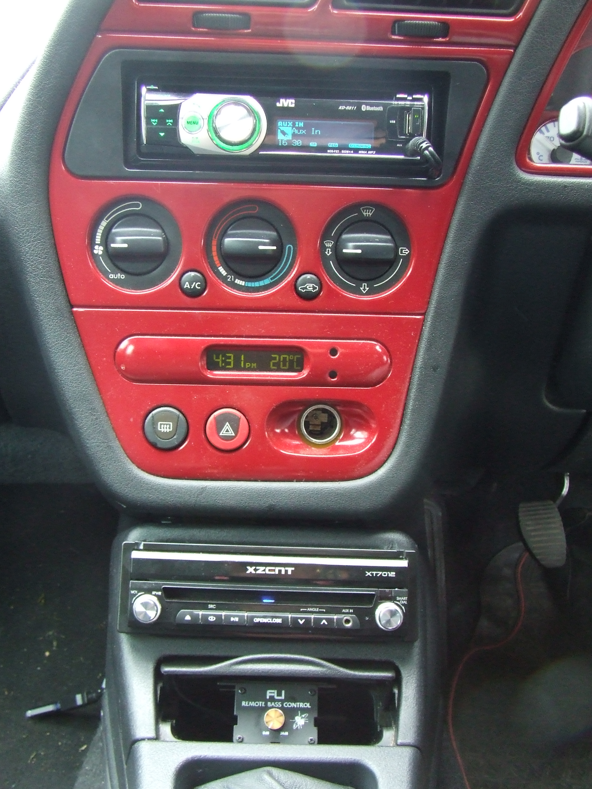

this weekend i managed to get hold of a 7" touch screen dvd mp3 player for the car,
ive been wanting one of these for a while now as my JVC head unit has a crap menu system for browsing Lots of MP3's
now i have a nice easy touch screen menu system
the lower head unit power comes from the same supply as the top piggy backed off of the iso plug
the lower output is fed via low level into the line in of the top head unit

The hole you've put the touch screen in, did you have to cut it or anything to get it to fit?

(04-09-2012, 09:42 AM)bowers Wrote: The hole you've put the touch screen in, did you have to cut it or anything to get it to fit?
yes i had to cut out the original pocket and enlarge the hole to fit the head unit,and also had to remove the duct work piping for the side air vents near your knees

did the cage just clip in alright once you'd opened the orifice? (giggity)

yes the cage did clip in once the hole was big enough but i had to support the head unit as it is suspended just by the cage
i used two bits of pipe lagging on the tunnel to support the head unit from below
i cut the hole out with a dremel and used a sanding drum to enlarge the hole till it was big enough for the cage
