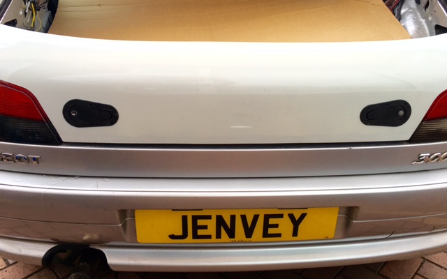

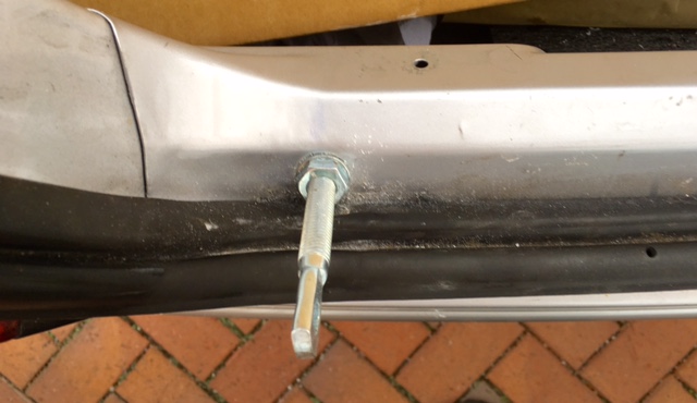

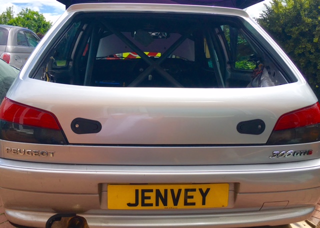

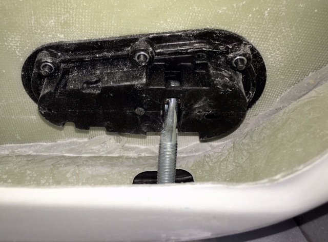

Test Fitting my Twin skin Tailgate all the way from good old France ..it uses standard mounting points & I'm going to be using Areo catches to lock it
Inside view ...ultra light Rofl

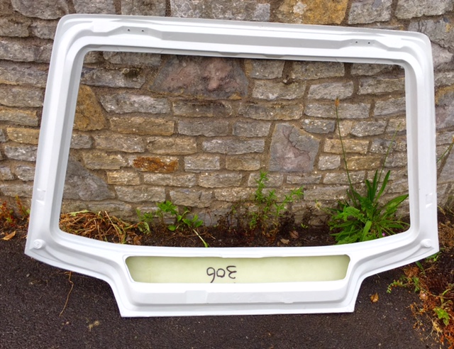

well thats rediculous. Where did you get it and how much? Ive got the same oil catch tank as you buy because ive got ABS theres nowhere to mount it! I thought it would be much smaller when i bought it.
Same guy who did the bonnets I would think as he was in process of making the mold
(10-06-2016, 04:09 PM)Eeyore Wrote: well thats rediculous. Where did you get it and how much? Ive got the same oil catch tank as you buy because ive got ABS theres nowhere to mount it! I thought it would be much smaller when i bought it.
£295 delivered inc Vat ....
It's a company that's been making stuff in France for 20yrs ....I'm dealing with a chap from Nailsea nr Bristol who imports everything
It's not the bonnet guy / Piggy ...

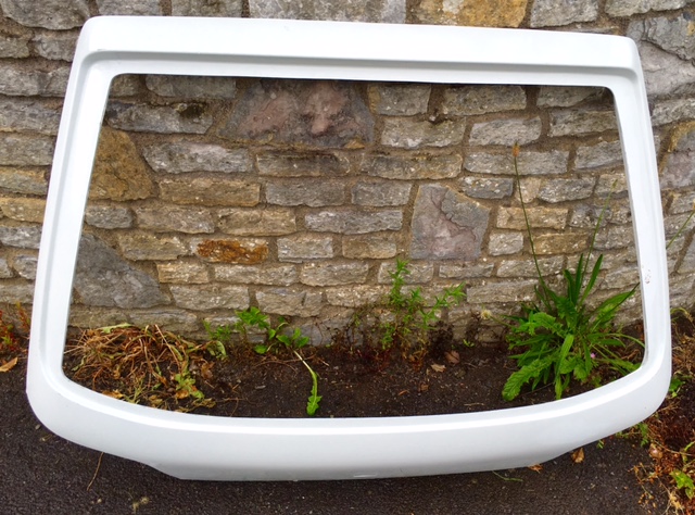

Tailgate test fitted before spraying
Inside
Steel pins not Alloy red ones that snap
Locked & closed inside view
Got the tailgate back Sprayed Great job & a (Free) Brand new rear glass window arriving Monday and being fitted without a trim as I'm planning on buying a Hardshell polycarbonate grey tint rear window within the next 6months & Same bonded rear quarters ....all in 6mm not Standard 4mm as they don't flex as much at speed & cornering ...gives more panel support also

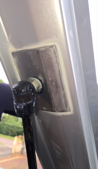

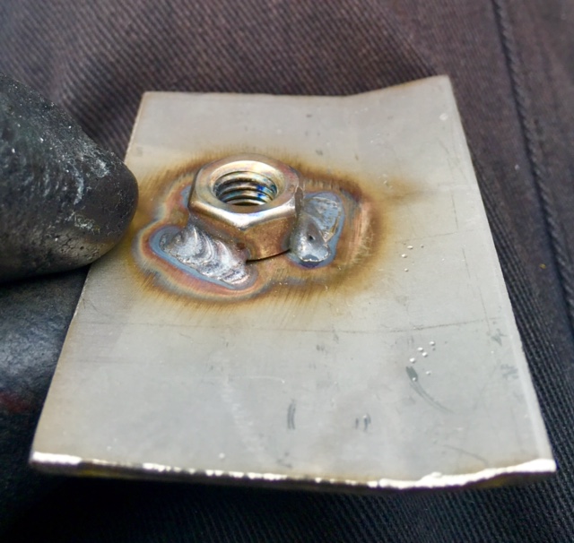

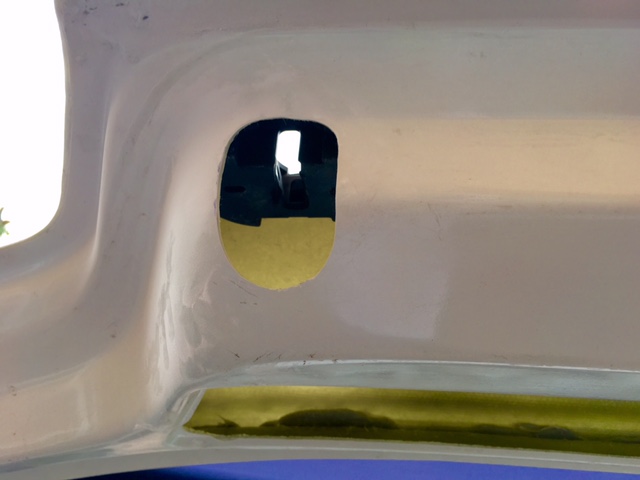

Bent 1.2mm Stainless plate & Tig welded a Stainless nut to the inside ..
I'm bonding the plates onto the underside of the tailgate where the tailgate ram nipple screws in ...I can then use it to spread the weight out over the Twinskin Fibreglass

Tailgate works well & Stainless bonded plate is speading the ram pressure out & not bending the Fibreglass ...I'm pleased

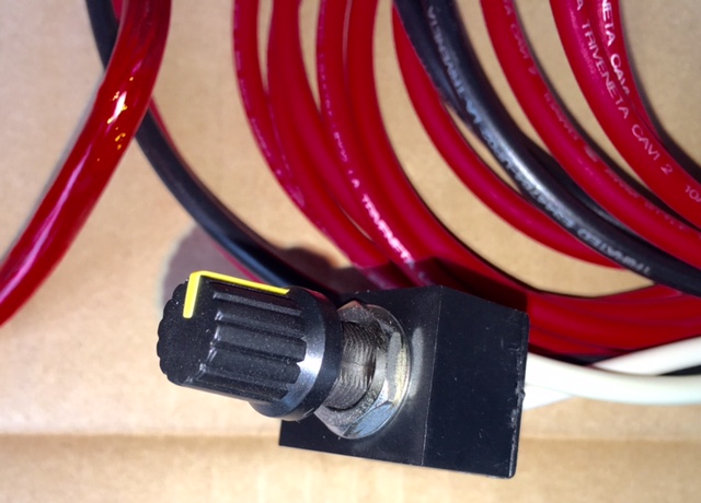

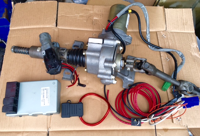

Vauxhall Corsa B Electric power steering going to be fitted in the next 2weeks  Rofl
Dum Dum my cars nearly finished m8 ...just Electric PAS to sort ....got to modify a few things for it to fit & the beauty of it is I've bought a conversion kit that allows you to ajust assistance 3 settings ...
I need PAS back on for road driving as its road legal ....I need a little PAS for Combe & a fair bit for Pugfest as my Arm we're hanging off the day after m8
do i spy a trim pot for adjusting the 'assist' ?

(03-08-2016, 11:26 AM)zx_volcane Wrote: do i spy a trim pot for adjusting the 'assist' ?
will you literally have to turn it for higher speed / low speed manoeuvres on the road?
always with the epic updates i may add. you don't hang about Smile
YES Tom ...but I will have it on lowest assist for Combe & highest for road .....
My steering with 2.4 Phaze 1 rack & 205/50/16 tyres is crazy hard ...
After Pugfest & 18-19 runs my Arms the next day were aching so bad ....
I will set it to drive to venues & Back & set the pot switch to minimum for track work or possible off for Combe ? As its so fast
