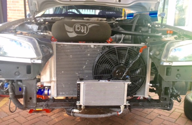

Noo, Pet hate with those cooler hoses I'm afraid
Is that a push on connection? hard to tell from the pic,
Otherwise bloody well done for doing it so quick

Surely concern over those oil hoses going under the lower panel...ie hitting the floor!
(24-05-2016, 09:57 PM)Piggy Wrote: Surely concern over those oil hoses going under the lower panel...ie hitting the floor!
No bumper skirts lower by 1inch Rofl
bumper will bend Wink
(25-05-2016, 09:48 AM)welshpug Wrote: bumper will bend Wink
Thats what I was thinking.
I have a 2" splitter...but it dont half move about
You're not leaving that filter upside down are you? Confused
I also wouldn't put the cooler hoses under there, look at the wiring loom casing there, it's always scuffed!
Haha...my ocd spotted that too tom! lol
(25-05-2016, 02:36 PM)Piggy Wrote: Haha...my ocd spotted that too tom! lol
Wow double O C D there Piggy !!
No the pipes for the oilCooler will be changed to Stainless Goodridge when I have the cash & im then going to be turning the oil cooler up the other way so Connections are on top...

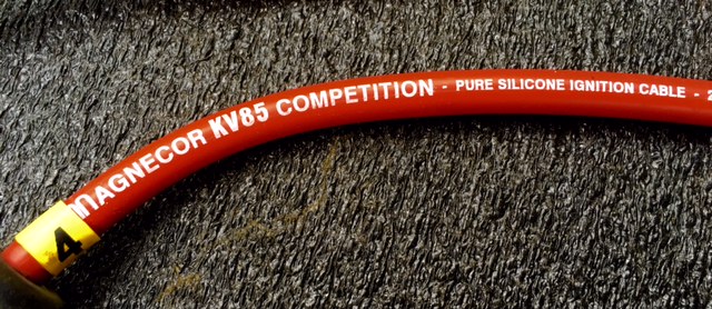

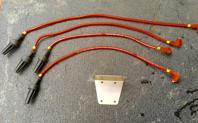

Right got some second hand Leads off Spooxs for £45 ....they didn't have 6 ones new in stock & they were £100 WoW !
They took them off a car they were stripping & sent them to me ...lucky I rang them ....they are a little longer than 6 ones but fit amazing & click securely into spark plugs & sockets & Coilpack ..
Reddddd
Got to love a smart set of leads ....better than the Mickey Mouse Corsa ones fitted that were loose as anything
