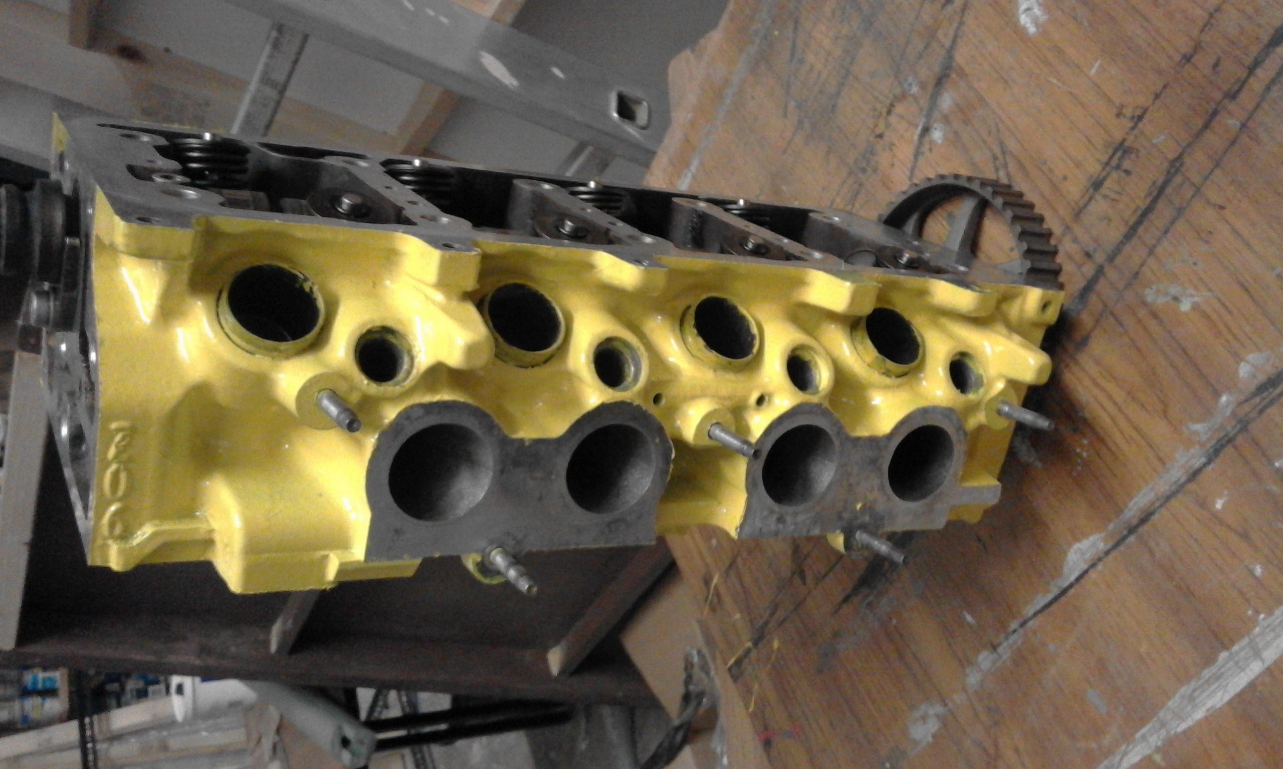

You gonna do a few cheeky bits to the head while it's apart?
wasn't planning to no, i definately havn't already had the dremel to it, i definately have not port matched the exhaust side, and smoothed out any transitions, i also have not thought about trying to find a way to do the same to the inlet as it doesn't have a gasket to match... #plasticmanifoldswithOringsFAIL
i also haven't registered my interest with a certain member about his lightened fly,
just a boring build i suppose ninja
Project: Formula Peugeot
definitely dont put some tipex on the inlet manifold o rings and attach it to the head. Then definitely dont use the outline to get a rough idea on the port matching. That would be a terrible idea and you shouldnt do it
[Image: mcetg0.png]
(09-10-2015, 06:17 AM)lolsteve Wrote: definitely dont put some tipex on the inlet manifold o rings and attach it to the head. Then definitely dont use the outline to get a rough idea on the port matching. That would be a terrible idea and you shouldnt do it
Lol. Wait a minute.....
well not getting the flywheel, just not... actually, so i can either get mine sent off, or just put it together standard and save for better later

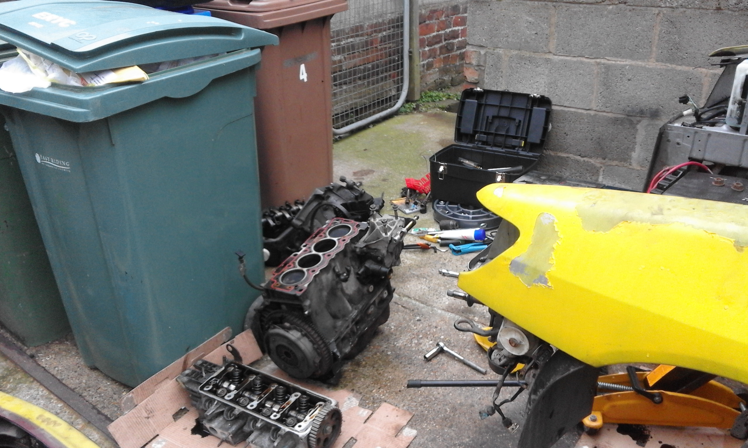

well this was the start of the work i've done so far, the current 1.4 will sing it's last either tonight or tomorrow, and then be de-wired, disconnected and removed unceremoniously from it's current abode, with an aim to having everything else back in (and working?) this or next week
Start with the block - Freshly rebuilt Smile

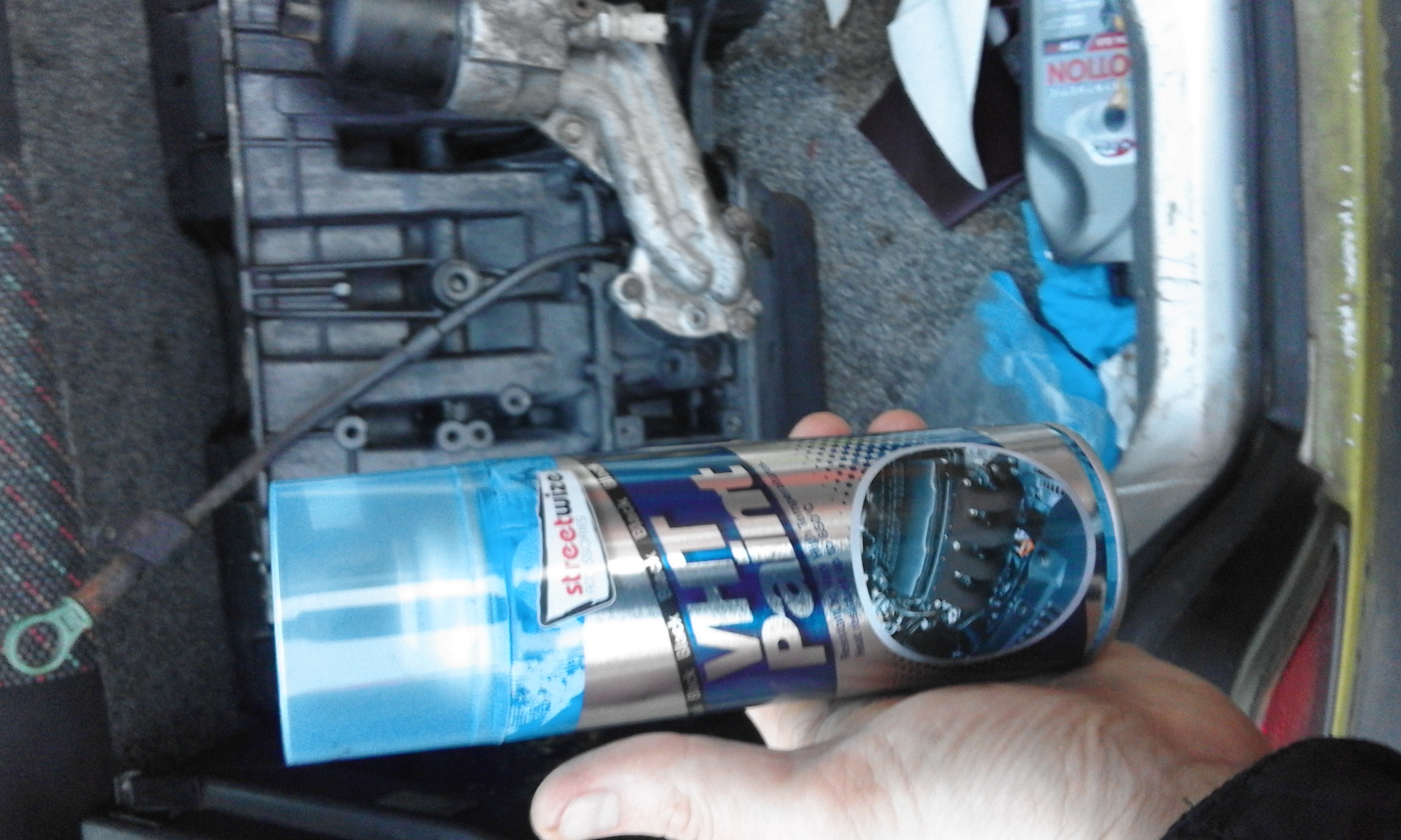

of course the head got a bit more shiny paint
it looks crap and really pale, but it's very bright, and sooooo smooth

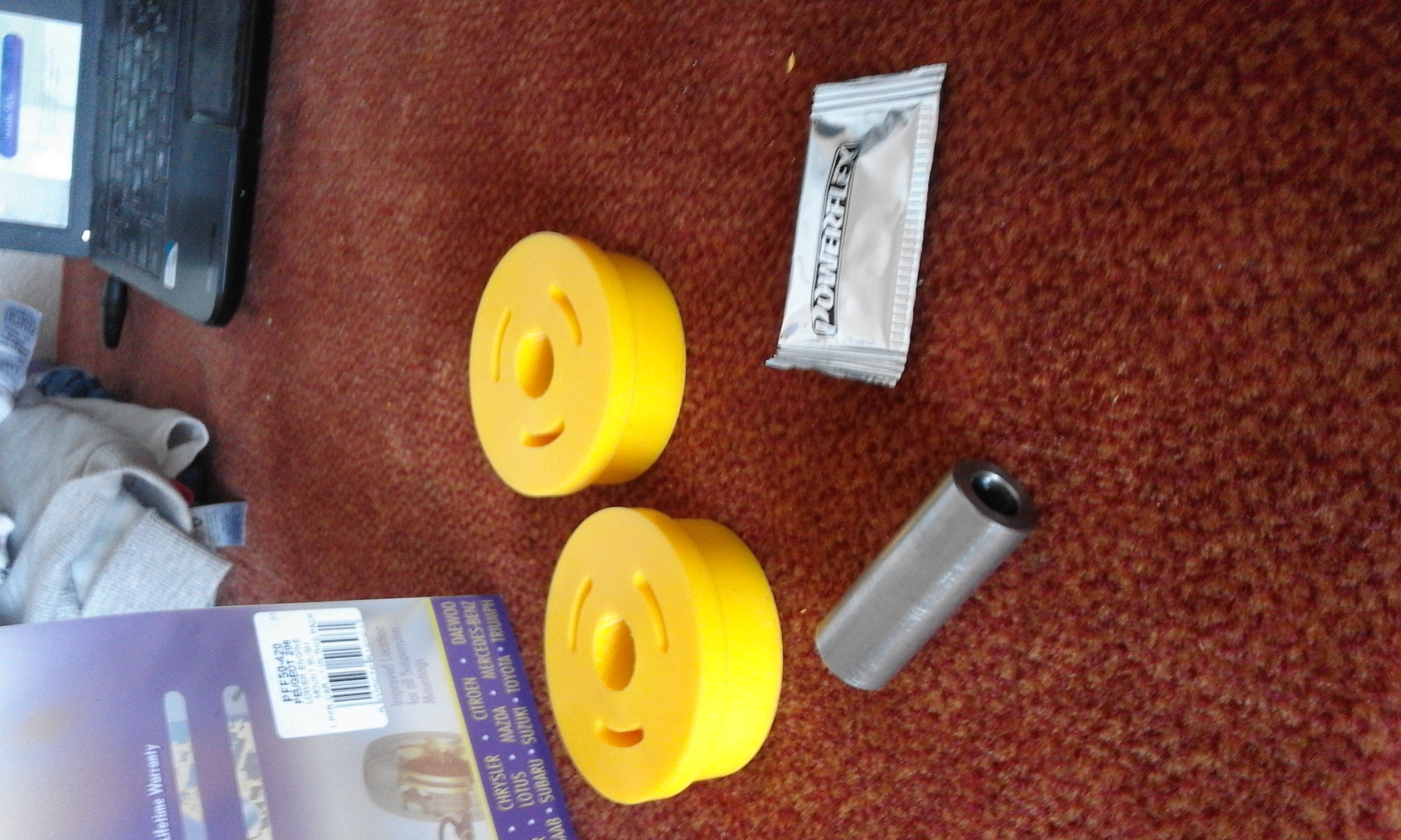

also got a package in the post.... i wonder what this could be?
BOOM
really happy with the quality of these now, i had a look at some a few years ago and they were a bit harder material, not machined properly, poorly fitting etc, this is beautiful... and the same colour as the head  Inlove

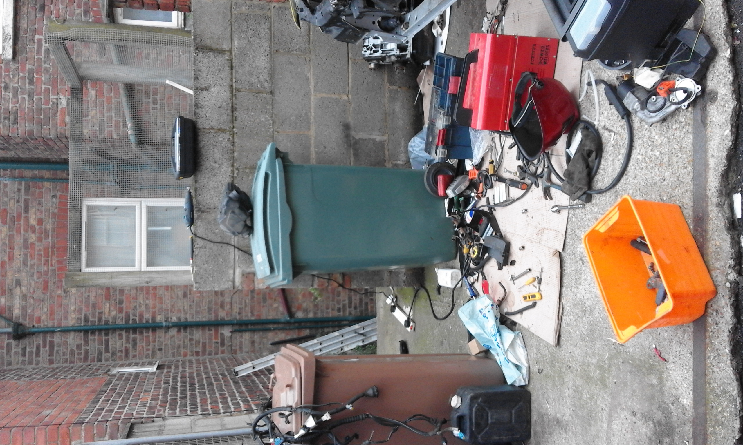

so this happened Smile
got a bit further than that today, but was elbow deep in rust and grease so didn't get any pics, will get some more tomorrow before i start putting stuff back in the bay

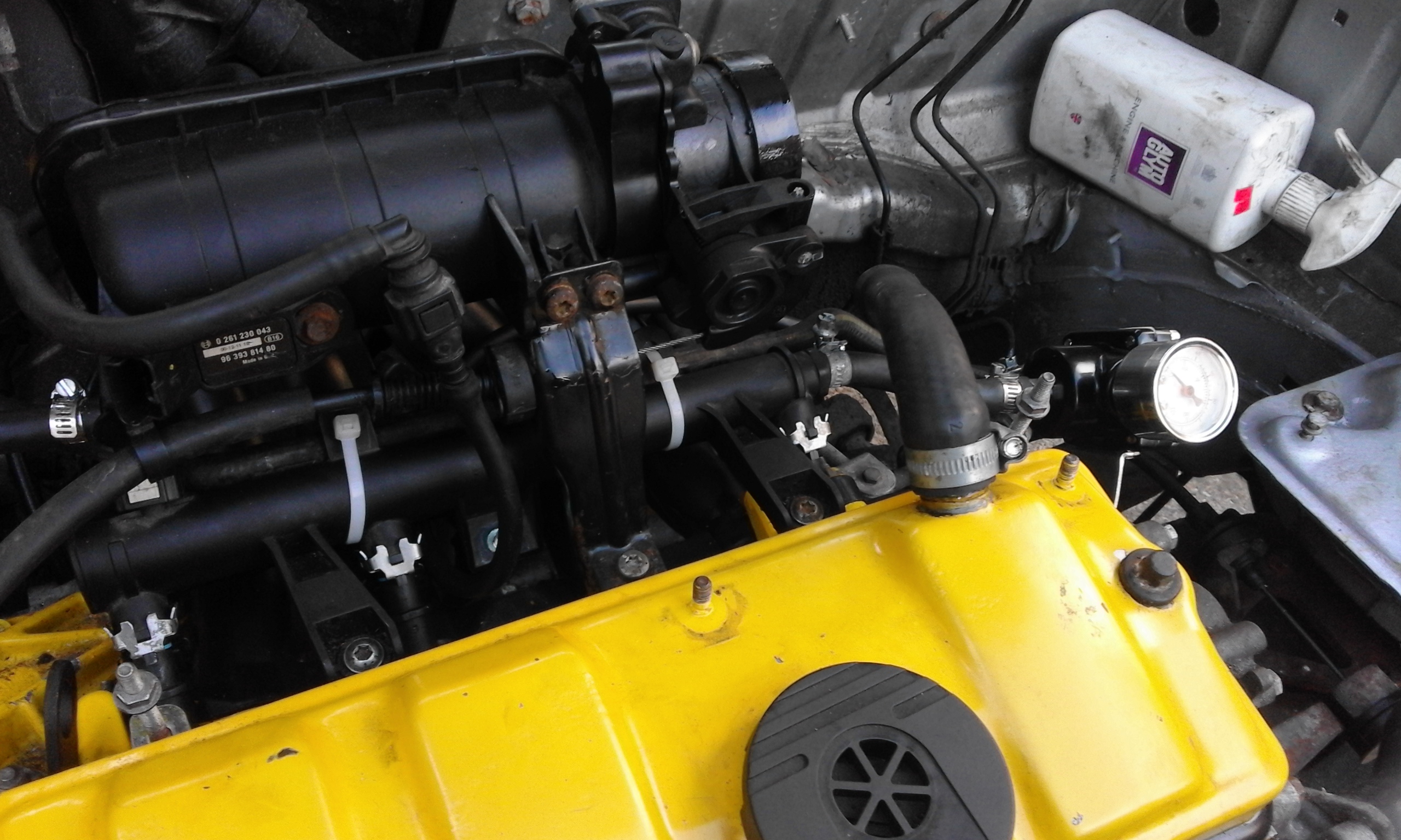

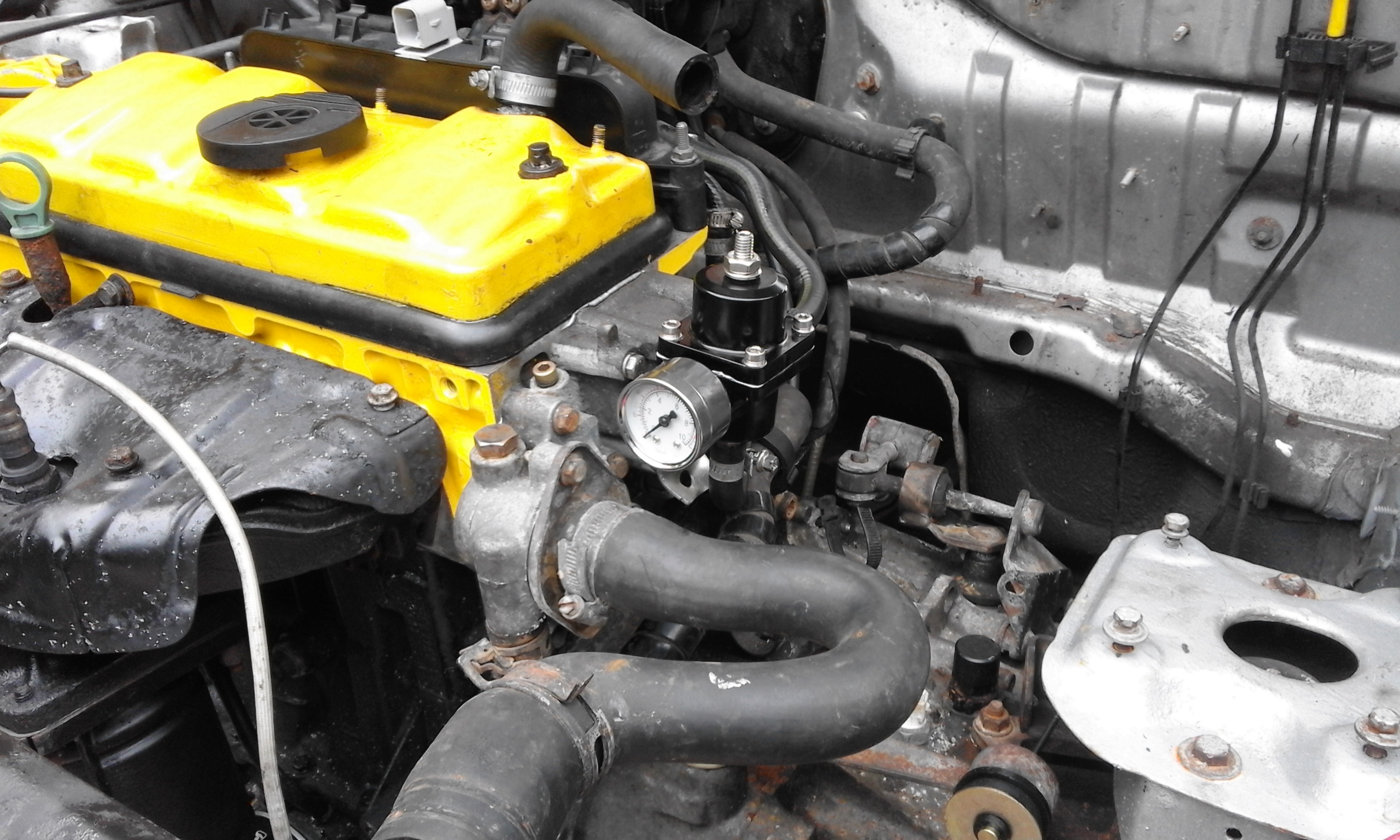

started with the fuel system, i decided to see about mounting the FPR at the end of the fuel rail, but as you can probably tell, it looks a bit.... shonky.
so decided to move it forwards, it now clears the airbox (a saxo item, not pictured but it looks awful, think i may have to make a proper induction pipe to put the crappy filter i already have down front somewhere
then i decided to add all the other injectors / coilpack and torque them down etc, make it permanent Smile
