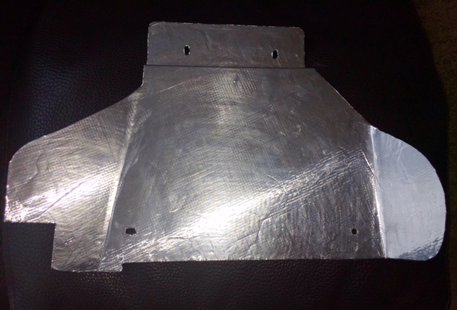

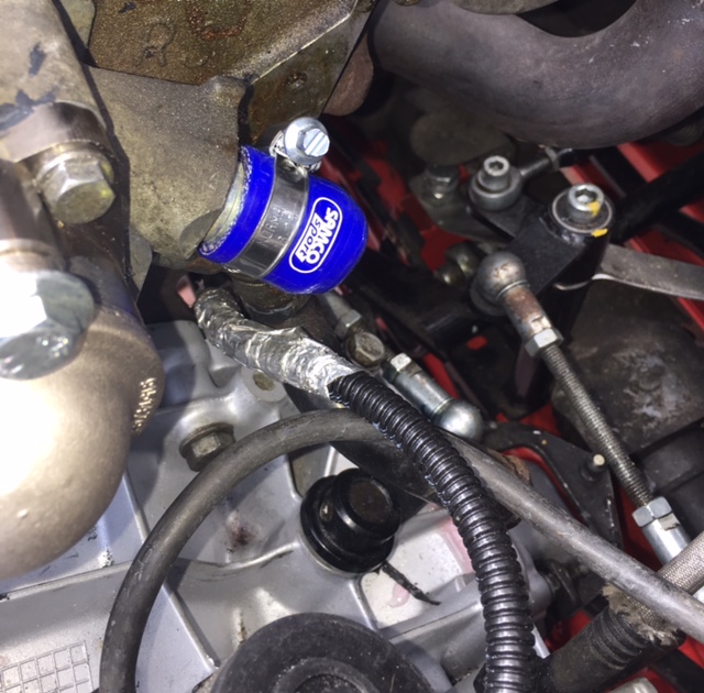

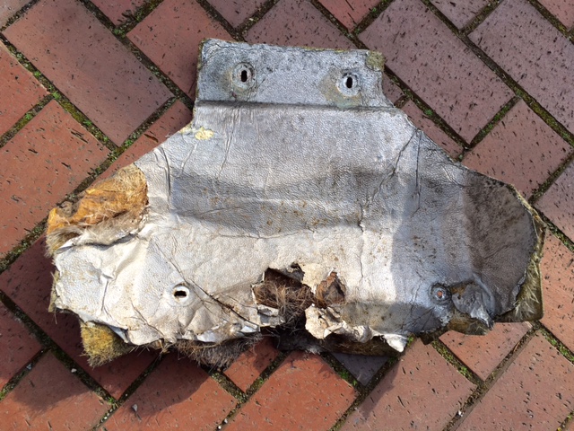

Zirco flex for my Stainless exhaust shield to keep temps to a minimum & I'll put some on the base & side of my Expansion tank to keep any nasty Exhaust heat at bay

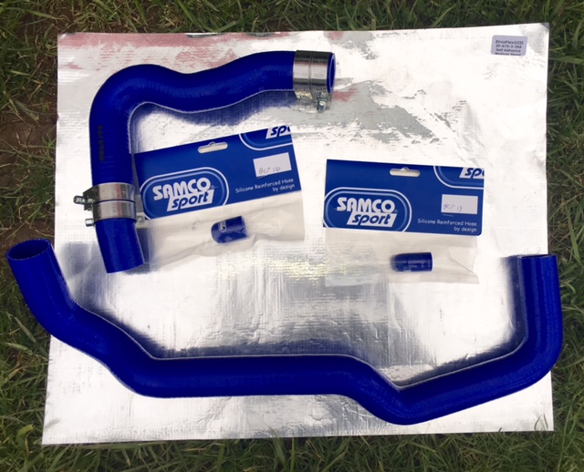

Covered Ryan / Pug-306s Stainless exhaust heat shield in Zirco flex 111....
Heres the details of it ....
http://www.zircotecwebstore.com/ZircoFle...B009DC0GDM
Looks like tinfoil in the picture but believe me it's the nuts stuff Inlove

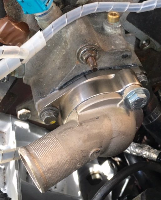

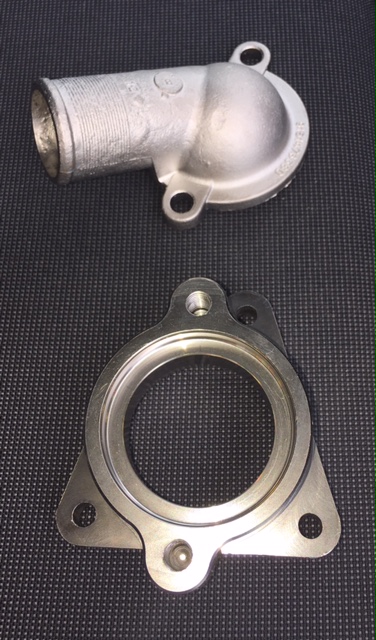

Had 29year old 205 Hose elbow bead blasted & Nickel Plated & also did Baker BM Thermostat housing done ...
This allows me to direct connect 32mm 205 Rad to now 32mm thermostat 205 housing ....no reducer needed & that Bacolite black plastic 40mm housing is now history .....thank god
Is that the standard heat shield or aftermarket? I like alot
It's a stainless steel copy off the guy called Ryan / pug_306 on 6 forum but he's also on Fleabay I believe ...£40 delivered ...
I've covered it myself in Zircoflex about £50 worth believe it or not ...silly expensive stuff ...got mine from Merlin Motorsport @ Castle Combe
PS ....a A4 sheet of the stuffs not big enough next size up

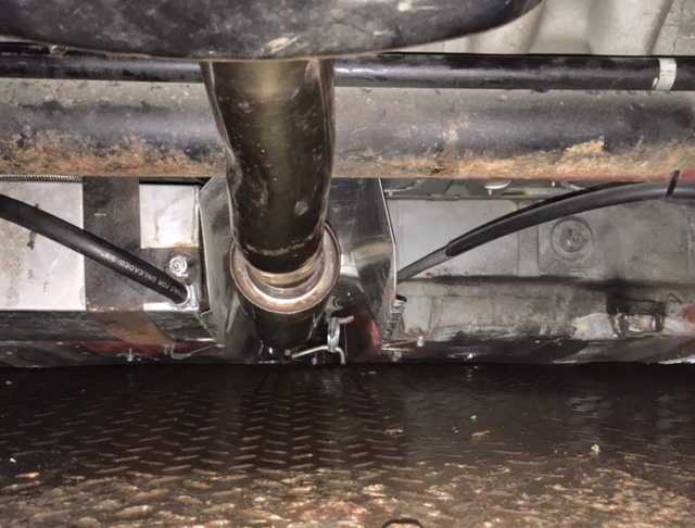

I think it's a good job I changed it today for Ryan / Pug_306 Stainless one . Itwasntme
God knows what could of happened ?

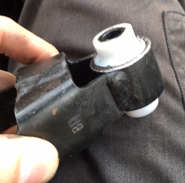

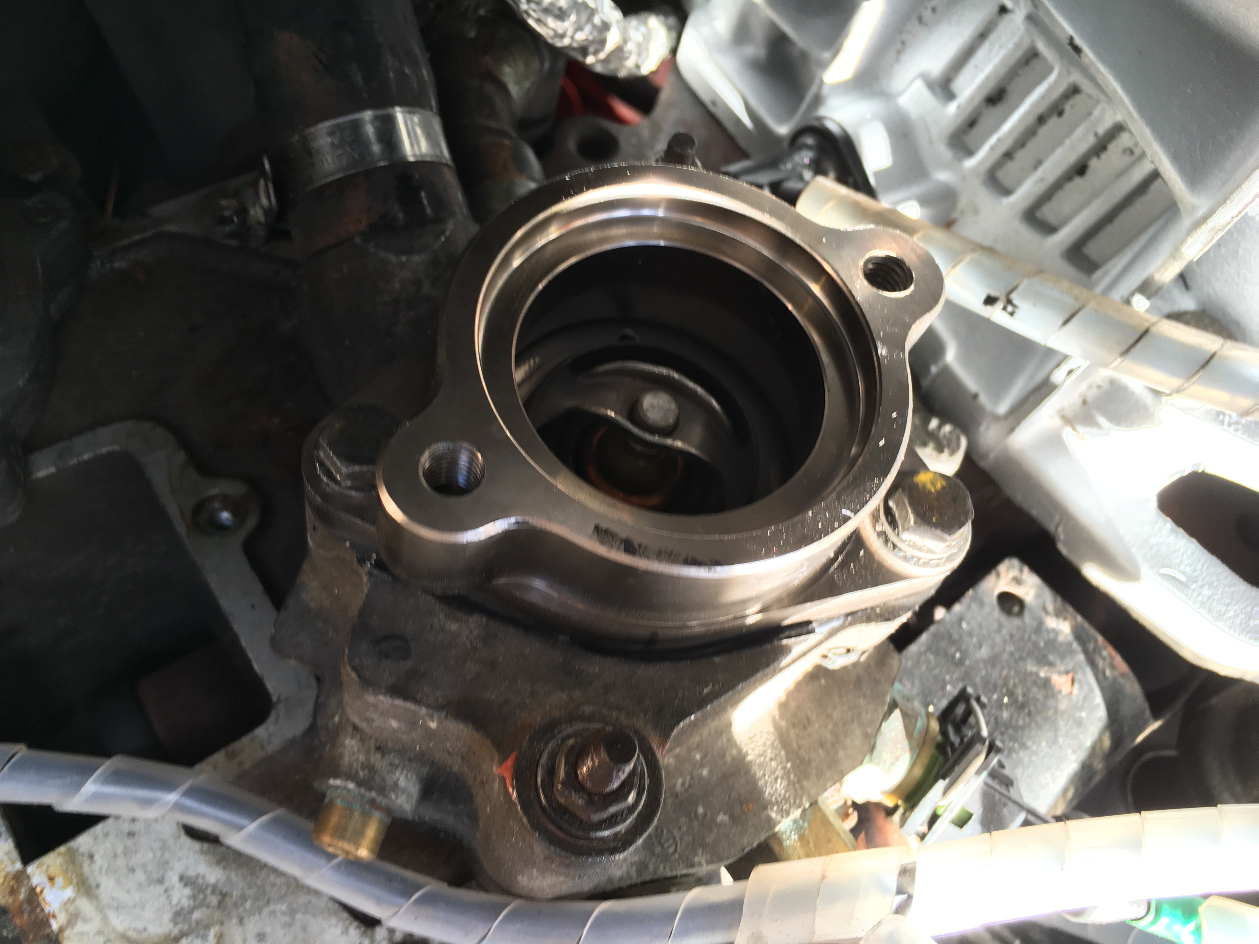

Baker BM lower fork bush fitted ..already have Vibratechnics hard solid rubber on other end

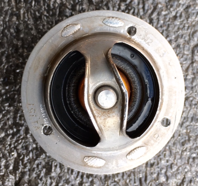

Welshpug Mei said to drill x3 -3mm hole in the Thermostate to aid bleeding & said its a Peogeot sport trick ...who am I to argue with Mei ..
Baker BM housing fitted picture is upside down sadly
205 Nickle plated hose housing fitted

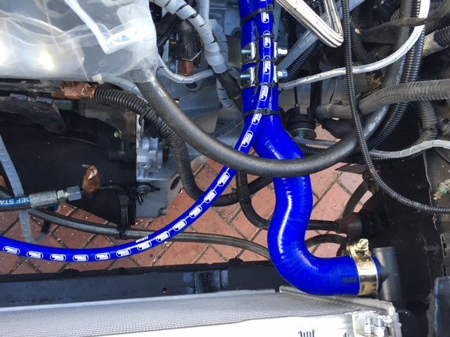

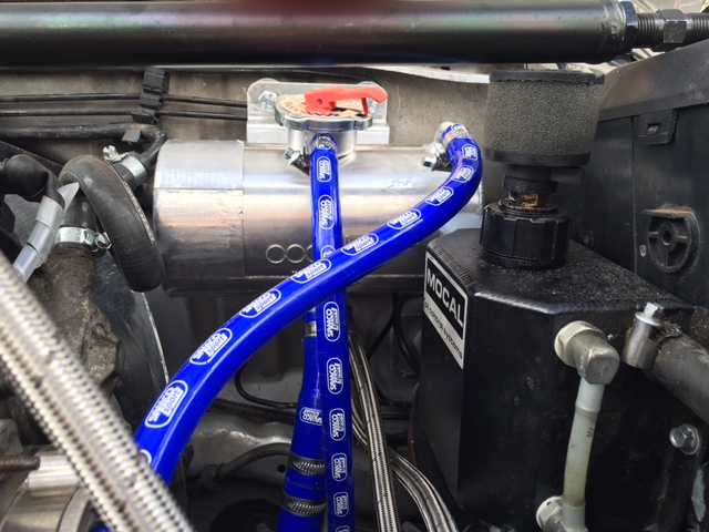

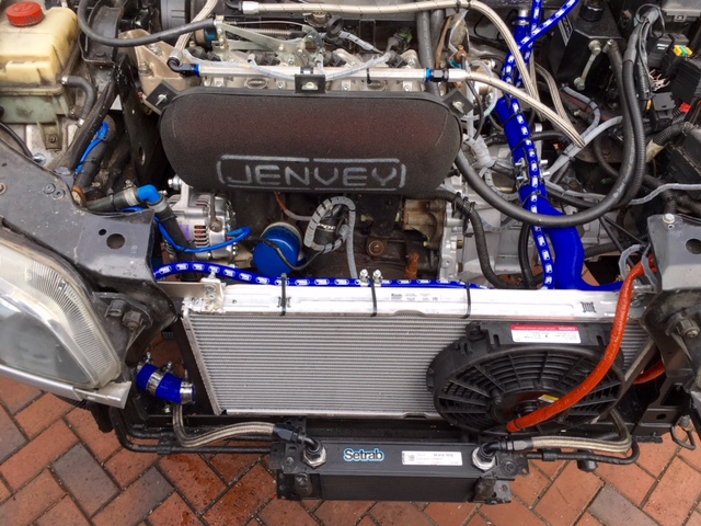

I don't run a heater so Old top Thermostat matrix pipe blanked off with a 19mm Samco stop end & Clip
Expansion tank fitted & Samco pipes sorted and lower expansion tank goes in to old Matrix pipe behind the engine & that goes to lower Rad hose for filling up also = 19mm

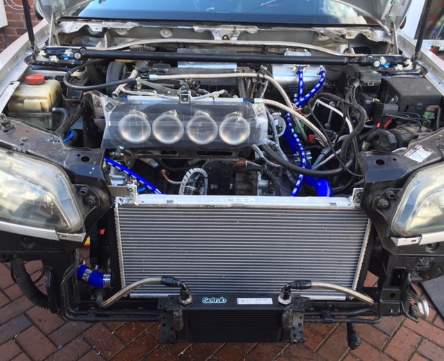

32mm new 205 housing now goes with Baker BM 32mm hose to 205 Nissens rad ....gti6 top hose was 40mm both ends ..
Had to lengthen the 205 Baker BM top hose with 32mm samco straight blue hose

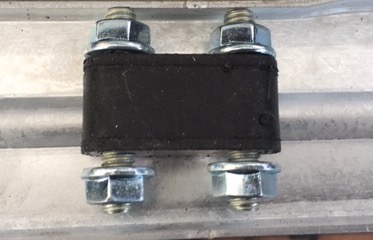

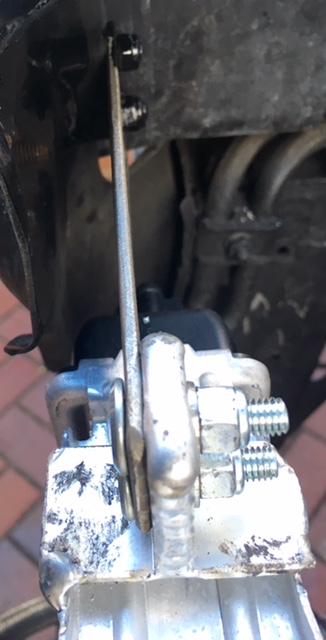

Radiator is connected at the top each side via flat stainless steel plate to two rubber bobbins
You can just see Rubber bobbins in the distance
Just Anti freeze mix & Electric fan & Relay to fit that's controlled via my DTA 40s ..then Bumper on & start finishing off inside the car / dash wiring 3/4 done ready for my full width Fibreglass dash coming later than hoped Tuesday now
Really pleased with baker BM housing  Rofl
Really pleased with baker BM housing sorry pictures upside down   Rofl
Getting there !

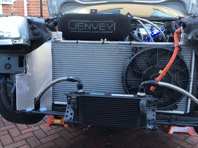

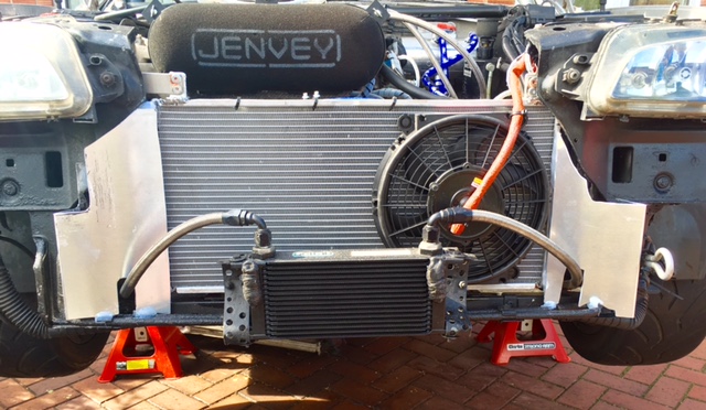

Got some alloy bent to fit on sides to stop air going past radiator
Did Drivers side ...just passenger side to do now

205 hose plus extender 32mm blue Samco hose & joiner

I just picked up some galvanised sheet yesterday funny enough to go round the radiator to try and improve air flow
I'm also going to try and mount my fmic/rad/oil cooler much closer together...read some reliable info that shows how the air stalls badly in the gaps inbetween

prob being a bit clueless, but have you actually tacked the ali sheet into place there?

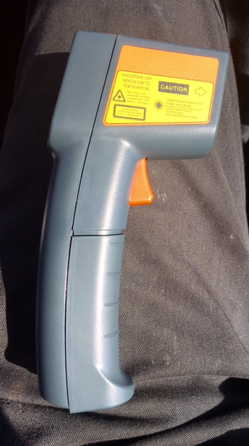

Try to set my Fan via my DTA last night but dash readings are 10 degrees lower than DTA software reading ...so I've borrowed one of these below to see which is correct & then I'm 100% sure it's safe to set the fan correct temp to come on & off .....these are not 100% I'm aware

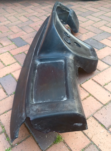

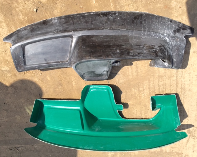

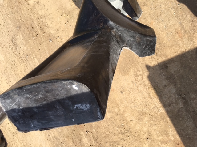

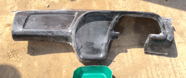

Well I've got it & its 1.3kgs in weight & stiff as hell with a little fibreglass natural flex :lol
It looks much better than the picture shows ...PS it was washed of because of dust in his workshop not had time to wipe it over yet
The black dash is the top pic & green is the mould I now have & own ...it wasn't cheap to get made & was crazy money really ...but hay ho ....

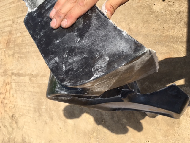

Also I got lots of extras fitted it has stop ends so you can't see behind on the ends & all sides & bottom curve under so yet again you can't see behind because Lower Glove box not copied ....also keep heater vents out & windscreen vents as if you want them you can fit them ...plus centre mid & upper glove box keep solid again if you don't want it remove it with a Dremel drill
Also it fits inside of door bars and the return stop ends make it look professional ...just got to tidy up edges & trial fit again
Picture of just the top ...just got to tidy up & trim & get Flocked

No it's all on 1inch silicon bead so lots of movement & no vibration ...
Everything has stop ends & returns
Other side & he's made all the returns up & stop ends from scratch ....Yes it's got to be tidied up & then All the hole cut out for my dials etc then off to 3gan on 6forum for dark dark flocking
Thats amazing. If you have the molds can you now sell them to us? Big Grin
(05-05-2016, 03:04 PM)Eeyore Wrote: Thats amazing. If you have the molds can you now sell them to us? Big Grin
Sadly I don't have the time ...doing two jobs to sort & I really could do with getting some cash back in ASAP ...as I'm ashamed to say how much the mould & dash was ...stupid money ...they spent 7whole days just making the mould alone ....
I put the Mould up for sale on 6forum & had a chap in 3mins say he will have it ....I'm not asking anywhere near what I paid for it ....but I need to recoup some cash back ASAP ....sadly this chap wants it for making a carbon fibre dash so he won't be making use of it other than for himself ...
Look I may keep hold of it for a month or two ....see what can be made & for what money ?.....if people paid who ever they find to make it & I make £50 per dash royalty sort of then maybe just may be something may happen ?
I really can't see any other nutters ever getting one like this made  Rofl
Remember this is a full race dash, it has no supports and is meant to bracket off the roll cage bar that goes behind the dash with a full roll cage. It doesn't bolt into the dash and under the bonnet like standard. So if anybody did want one they would have to do some modifying.

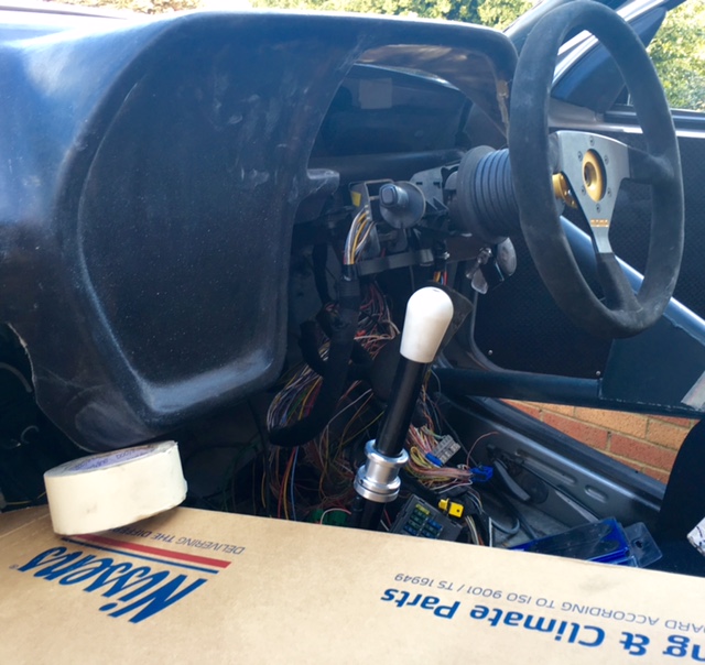

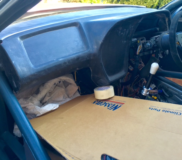

Temp fitted the new fibreglass dash & it fitted amazing thank god  Rofl
How he's made it ...you don't notice all the vents are missing ...
Best of all after trimming I weighed the dash on its end with Digital scaled & it was 0.863kgs LESS than a KG .....
They told me 1.2 kgs but when I rang them they said they guessed ...I'm really pleased & I can fix it with two clamps via my behind dash roll cage cross brace ...

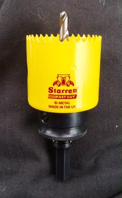

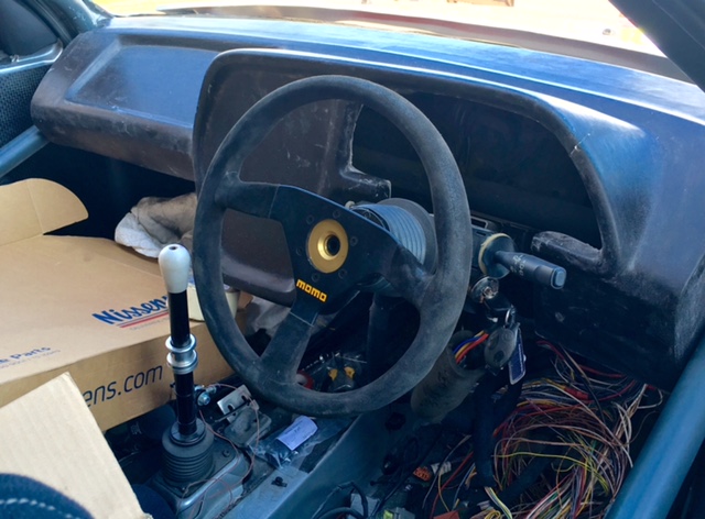

Out with the Dremel tonight on the Finteglass dash ....
Got a £5 special 51mm not 52mm hole saw Abour off Amazon

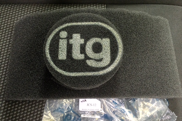

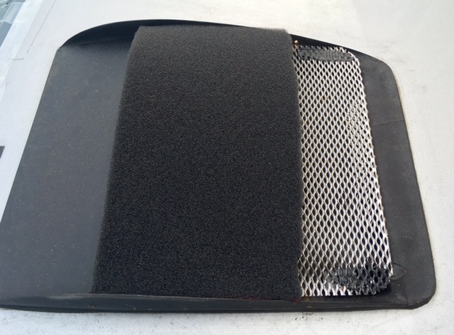

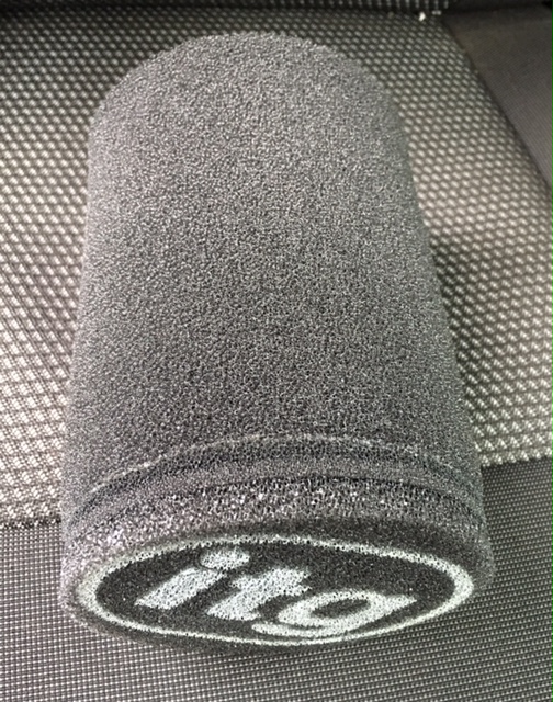

Bought a ITG filter & im cutting the end off & cutting it open to lay flat in my TRS carbon roof vent ...it stops dust & reduces Rain ...
This idea came from Twangy / Wayne on here ...clever sod  Rofl
Here's one I prepared earlier ...
Filter layed out inside TRS & it doesn't need to go to the back as it seal 1/2 way down as the back by right hand side with visible mess slopes down to seal

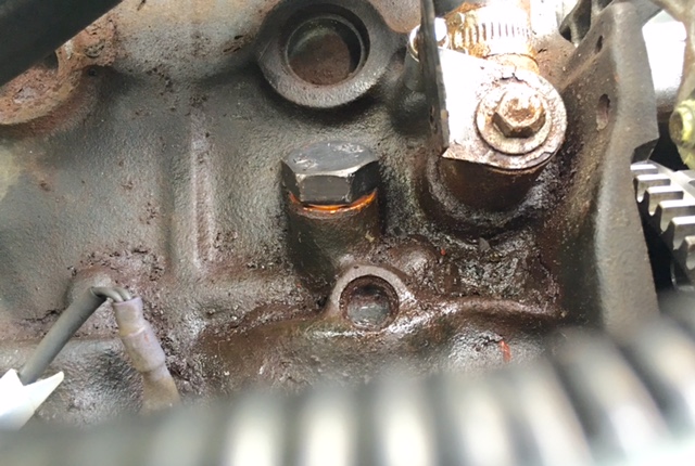

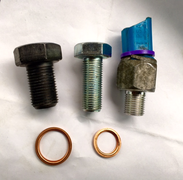

Had a couple of leaks ...one from power steering sensor plug that's no longer used & has been hit at some stage ...blue plug in picture below ....leaks around by blue plastic where it's crimped ...it's m12x1.25 abit of a odd one ...bolt I need to cut down & fit Copper washer to is on left of blue plug in picture

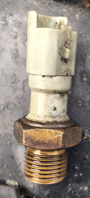

Then another leak found by mistake old Oil pressure sensor above Starter motor no longer used so a M16x1.5 bolt cut down & cooper compression washer used to seal
M16x1.5 bolt fitted
Power steering bolt M12x1.25 fitted....

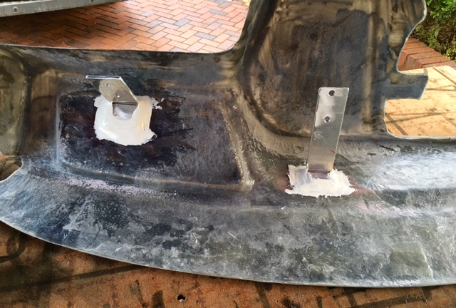

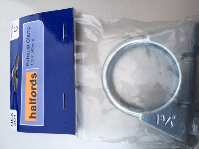

X3 Exhaust Clamps that bolt to my roll cage behind the dash & keep the fibreglass dash in place ...
Alloy angled plate bent & bonded with a new Polymor 24hr cure adhesive that's vibration / semi flexible / waterproof & 100 degrees heat resistant ....used x3 plates one at each end & one in the middle ...it you look closely you cau see the two holes in each plate that exhaust clamps bolt onto

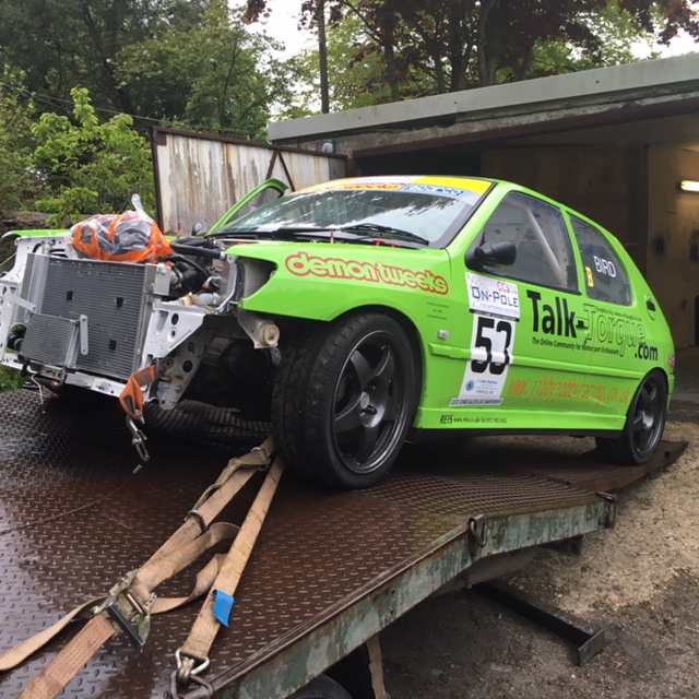

Here we go yet again .....went to look at a car 4 miles away from me for someone else & ended up gazumping him & buying it myself to strip & sell off all the bits apart from a Sandy Brown full £13k race engine that's only been Bench dynod at 280bhp at the flywheel & 196 torque
It's got Colin Satchel cage & F&R Satchel Suspension
I'm putting just the engine into mine ...using my 6 speed box as this engine revs to 9000rpm...
It's got Jenvey 48s on & a Accusump ...selling most of the car & loads off mine ....a lot of stuff is gone below

(18-05-2016, 05:33 PM)Day666 Wrote: Here we go yet again .....went to look at a car 4 miles away from me for someone else & ended up gazumping him & buying it myself to strip & sell off all the bits apart from a Sandy Brown full £13k race engine that's only been Bench dynod at 280bhp at the flywheel & 196 torque
Plate diff
Wilwoods
4.4 5speed box
Loads
