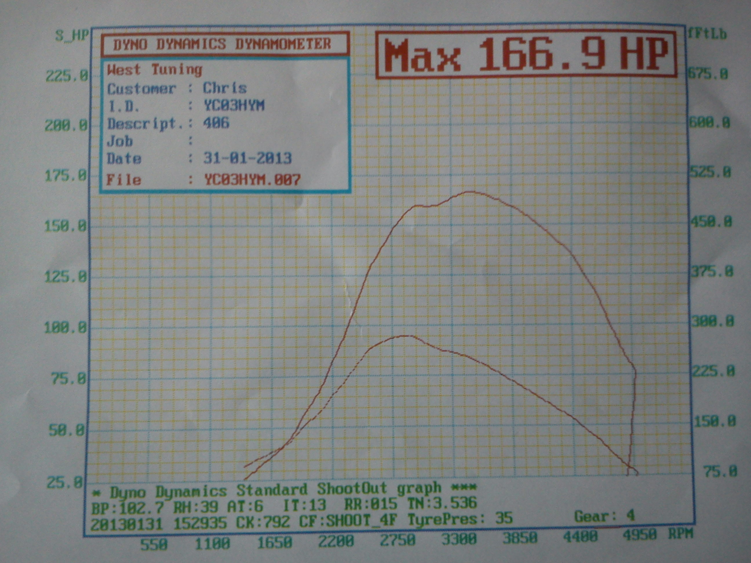

My graph. They wouldnt give me the 168bhp one because this one is the better curve.
