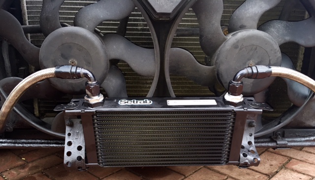

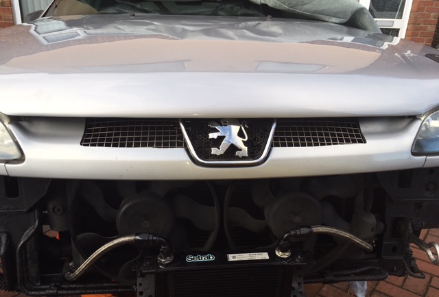

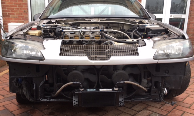

Well I fitted a new 16row Setrab after my Mocal was leaking & a open circuit (Non) Thermostat sandwich plate ..

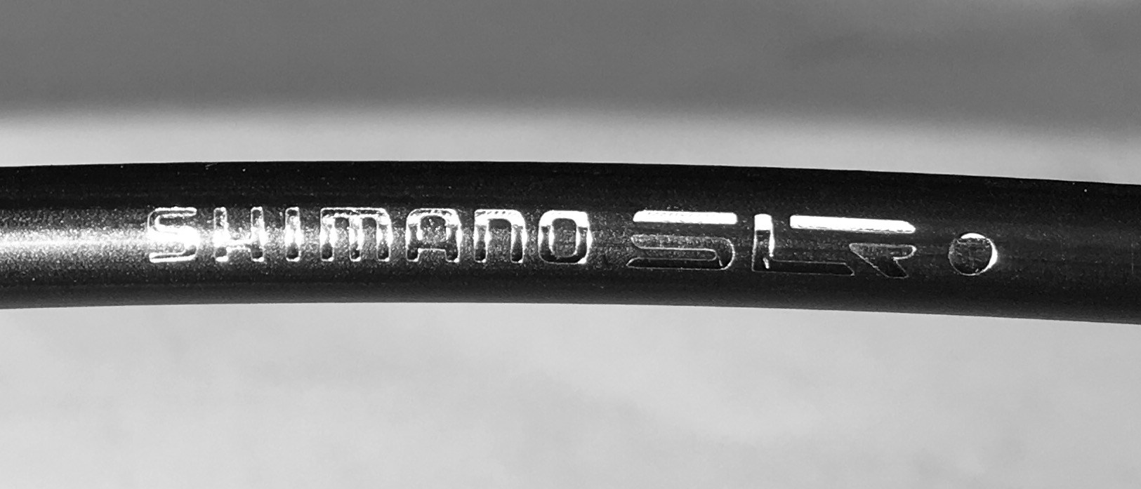

Sorted my Jenvey linkage out & fitted a new throttle cable from a MTB bike thank you Shimano ....
Found a crack in my Carbon Fibre Air intake box I'll have to repair
Not a cheap hobby
Happier with the throttle now ...so smooth & easy to press
Works better & new buy Mocal again

Looks epic chap!
I know this is an older photo as you've moved the throttle cable, a silly question from me; how come you run the original fuel-rail and injectors?
#95
(22-03-2016, 10:06 PM)mackat Wrote: Looks epic chap!
I run 8 injectors m8

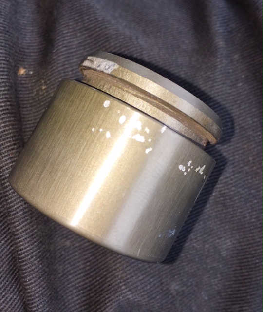

Little update ...Brembos totally refurbed & both back from Godspeed who do amazing brake work ...big thank you to Ben & his dad Ian...
Had one of the hard Alloy Anodized Pistons replaced as it was lazy & turned out to be pitted....
Pitted

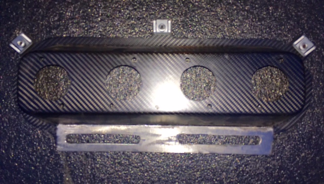

Carbon fibre Airfilter housing mended with 1.2mm Stainless & bonded & clamped onto the Carbon Fibre

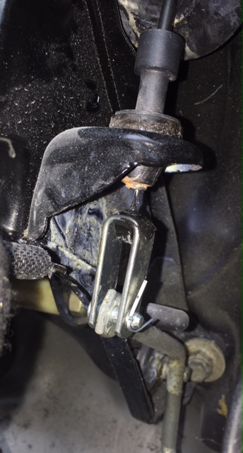

Throttle cable linkage to pedal now has metal end ...getting rid of those plastic breakable things ...
Also used a MTB top end Brake cable with PTFE liner & used stupid price Nano Polymer white cable grease to make extra smooth.
Feels Soo light & frictionless now ....shortened the cable also by 18inch & turned the Jenvey linkage around to correct side

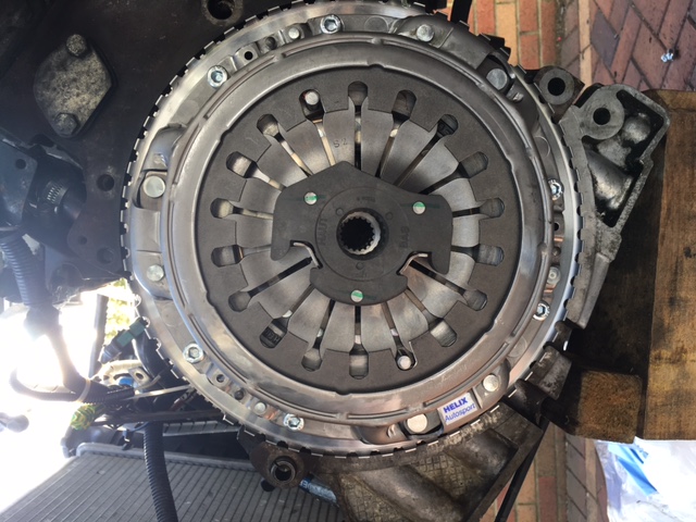

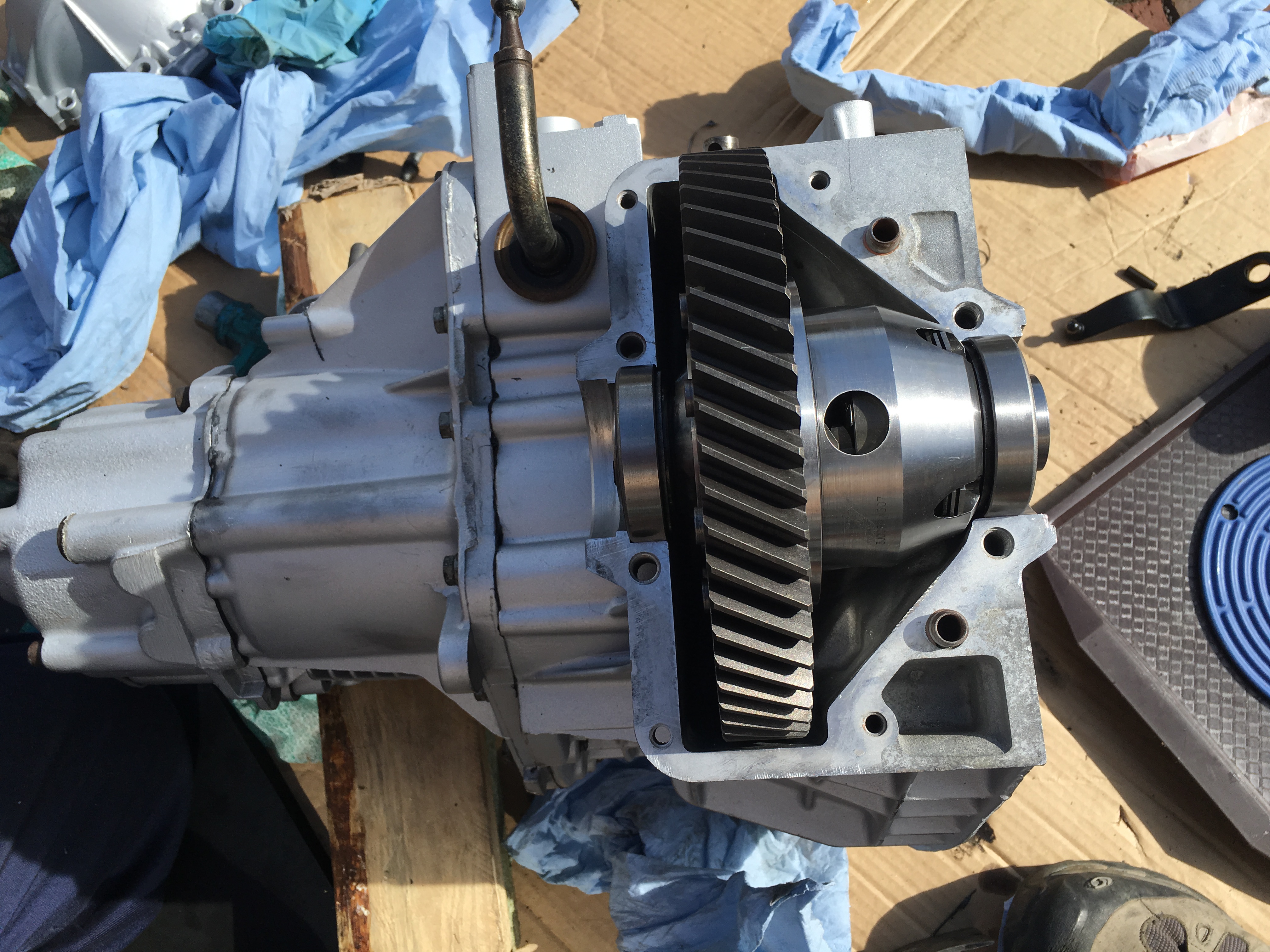

Well yesterday my mechanic m8 Martin came to help me fit my new (Miles) refurbed 6speed box with New 4.75 Bacci gear-set
Had to remove 3j plate diff & replace Crownwheel for the one in my box that matches ...

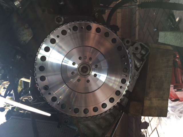

Then fit new Crank seal & RichW Lighened flywheel with new GEN bolts all torqued up
Helix Sprung 4paddle clutch & Helix Pressure plate

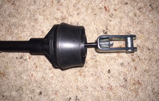

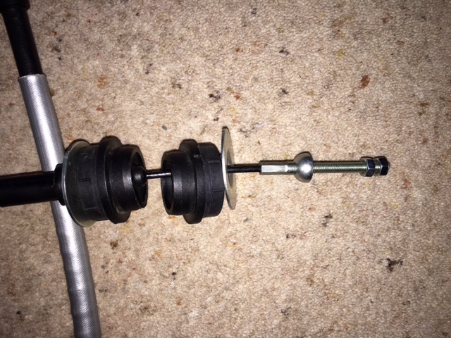

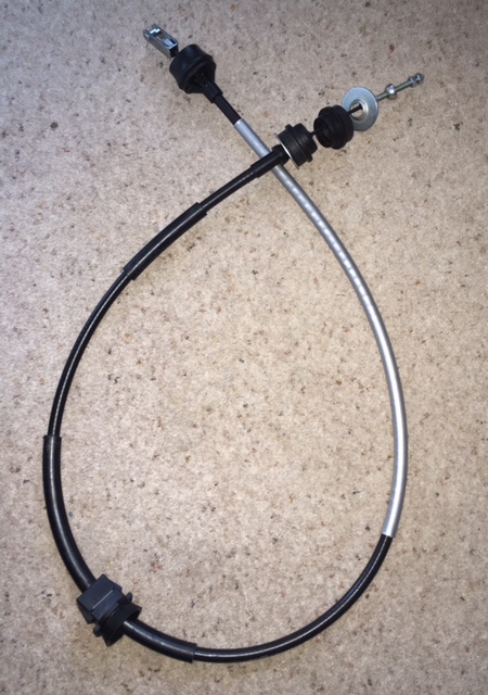

Fitted new (non) ajustable clutch cable ...made by Speedy cables in wales ..it has self ajustable end & all plastic ends are metal
Pedal end
RichW roller bottom arms with new ball joints fitted also & Greased with Graphite sticky as hell ultra high pressure grease ....
New Drive shaft seals both sides fitted ...

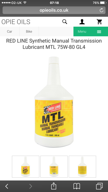

Redline 75/80 MTL gearbox oil used ...bloody Royal Purple prices as needed 2 as sold in US measures short of litres ..
Fitted Bosch oil filter & Millers Race Nanodrive 10w/50 oil ...came out best in two recent tests ...they don't make 10w/40 sadly .

That clutch cable is perfect - do you know if they're willing to do.make/sell anymore?
I've got a metal fitting on the pedal end of an original cable, but it has meant shortening the cable to get it on = high clutch pedal.
<3 the flywheel too, shame it has to be covered up

(26-03-2016, 10:28 AM)zx_volcane Wrote: That clutch cable is perfect -  do you know if they're willing to do.make/sell anymore?
Yes they have keep the design on file ....all you need to do is give them your old cable or broken cable  so they can use all the other bits off them ...they put new outer & inner & both metal ends on including threaded ajustable end for £55 ....it's smooth as silk even with the Helix & helix pressure plate ...I think that's really good for a one off ?
Yes agree the RichW flywheels are a work of art ...I'm aware he just buys them in .....
Massive difference in feel with that horrible self ajuster gone Rofl

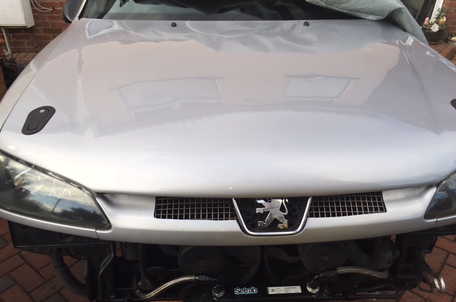

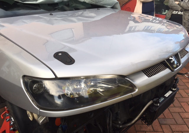

These pictures are for Piggy ...not fitted my Bumper yet but this is my Twin skin fibreglass bonnet sprayed & I want a badge ...so I sunk it into the grill
No bumper yet
They did an amazing job of the bonnet & you wouldn't know it was Fibreglass even 6 inches away
Well done Piggy for getting them m8 .... Inlove
You can't see it in the picture but the Honeycomb badge is all drilled out apart from the Emblem

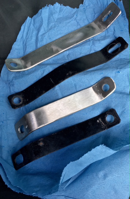

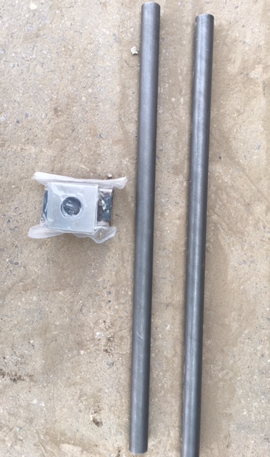

As you can see by Photos before ...I replaced my box & Clutch etc & Noticed my Satchel shift main supporter post had come loose...should of Lock tightened it ...that then put loads of pressure on both Angled supports it slightly bent the thin 1.2mm angled drilled flat plate...it's the black second from top in picture ...
So I got my friend to cut out some Stainless Steel 3mm flat plate & I drilled it & hand bent it in a vice ....don't think that will happen again .. Rofl
