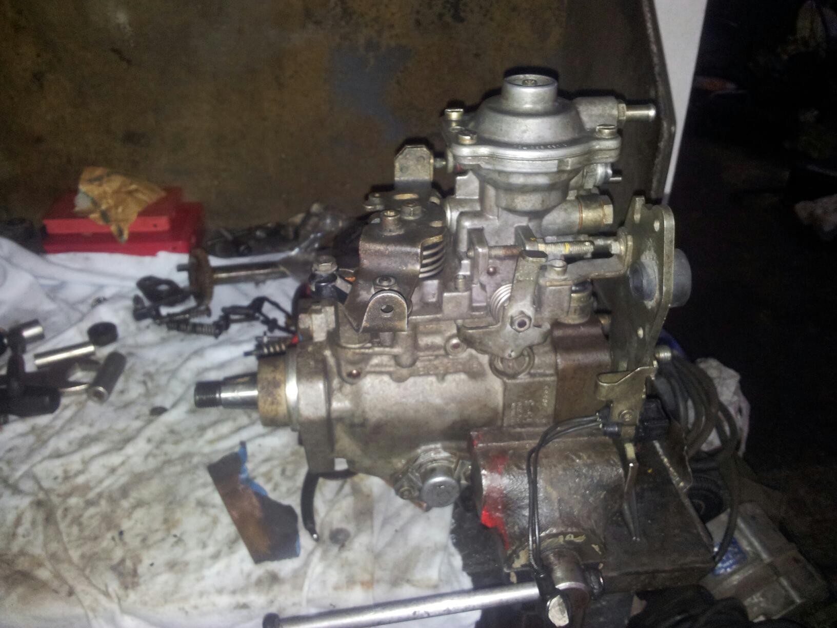

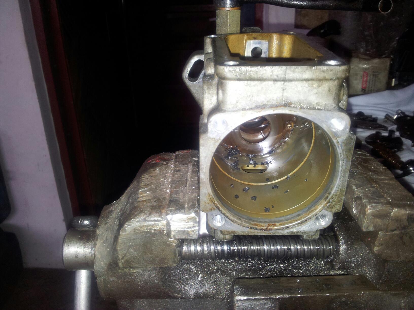

#92

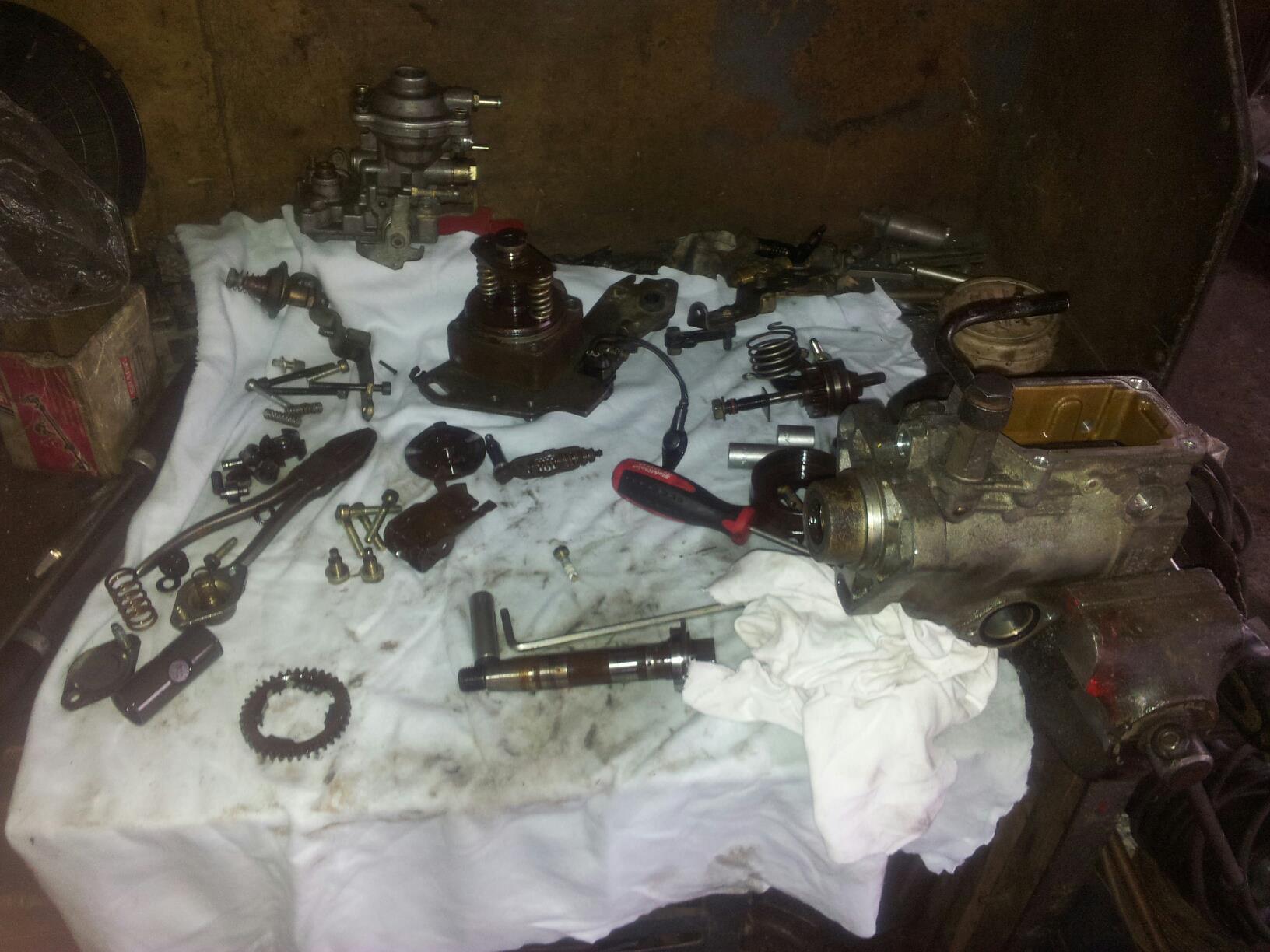

This is what we found in my pump thanks to runing with no fuel filter. Have to go for new seals, new plunger, gov mod and lda pin.
Soooo curent configuration:
XUD7 with tmic
xud9 gearbox
bosch pump with gov mod and grinded lda pin
new 9mm head
k14 @ at 15psi - soon will go to 22psi.
#93
Gov Mod. And done.

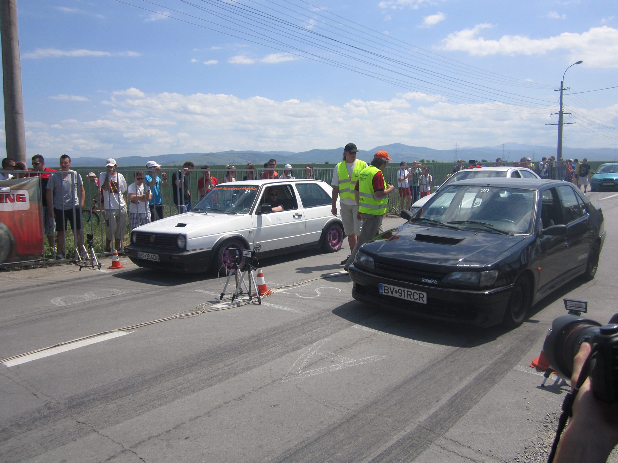

Haven't written for some time around here.
Not too many updates. Some stickers, 3rd place 201m drag race, k14 @ around 1.5bars, still on steelies. Soon some Audi 80 15'' Speedlines painted red.
PS. In that last picture there is a 406 1.9 d-turbo t25 at 150 HP.

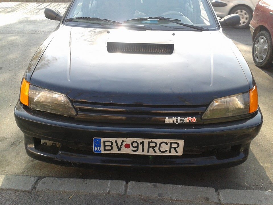

Not so many updates... Just some orange indicators.
Liking the indicators, how did you do them?
Bye Bye D-Turbo
Oracal 8300 translucent film.
