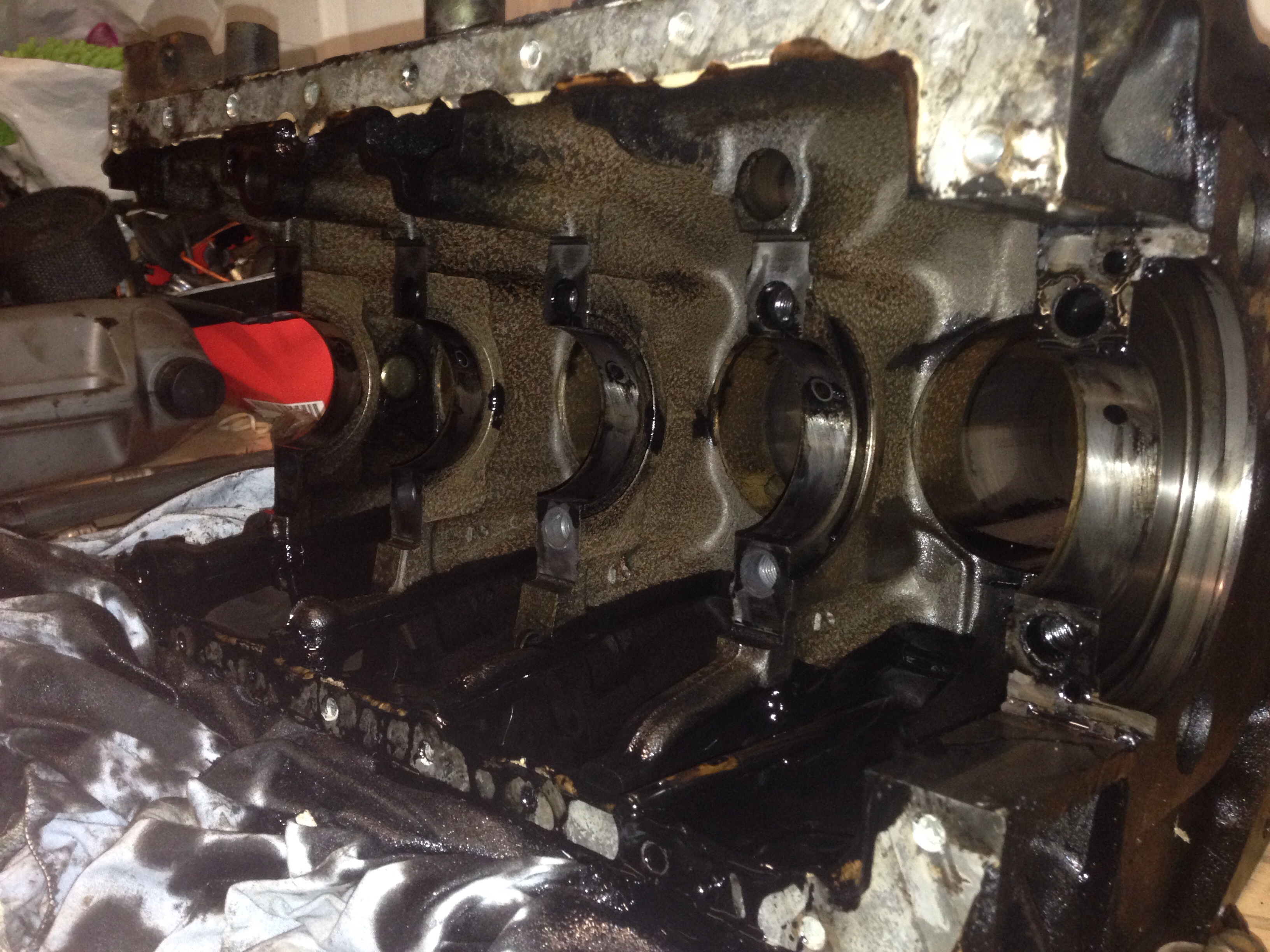

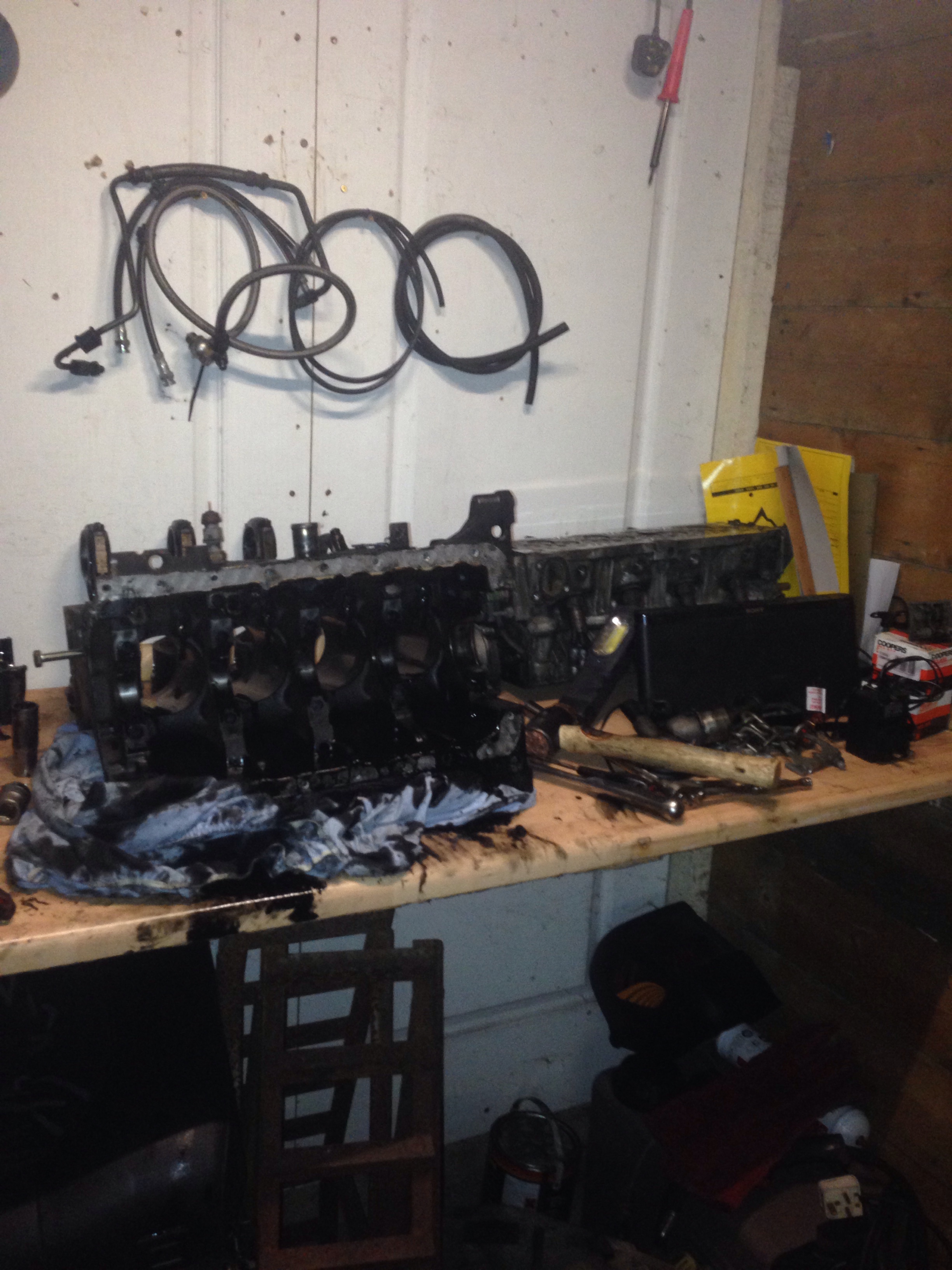

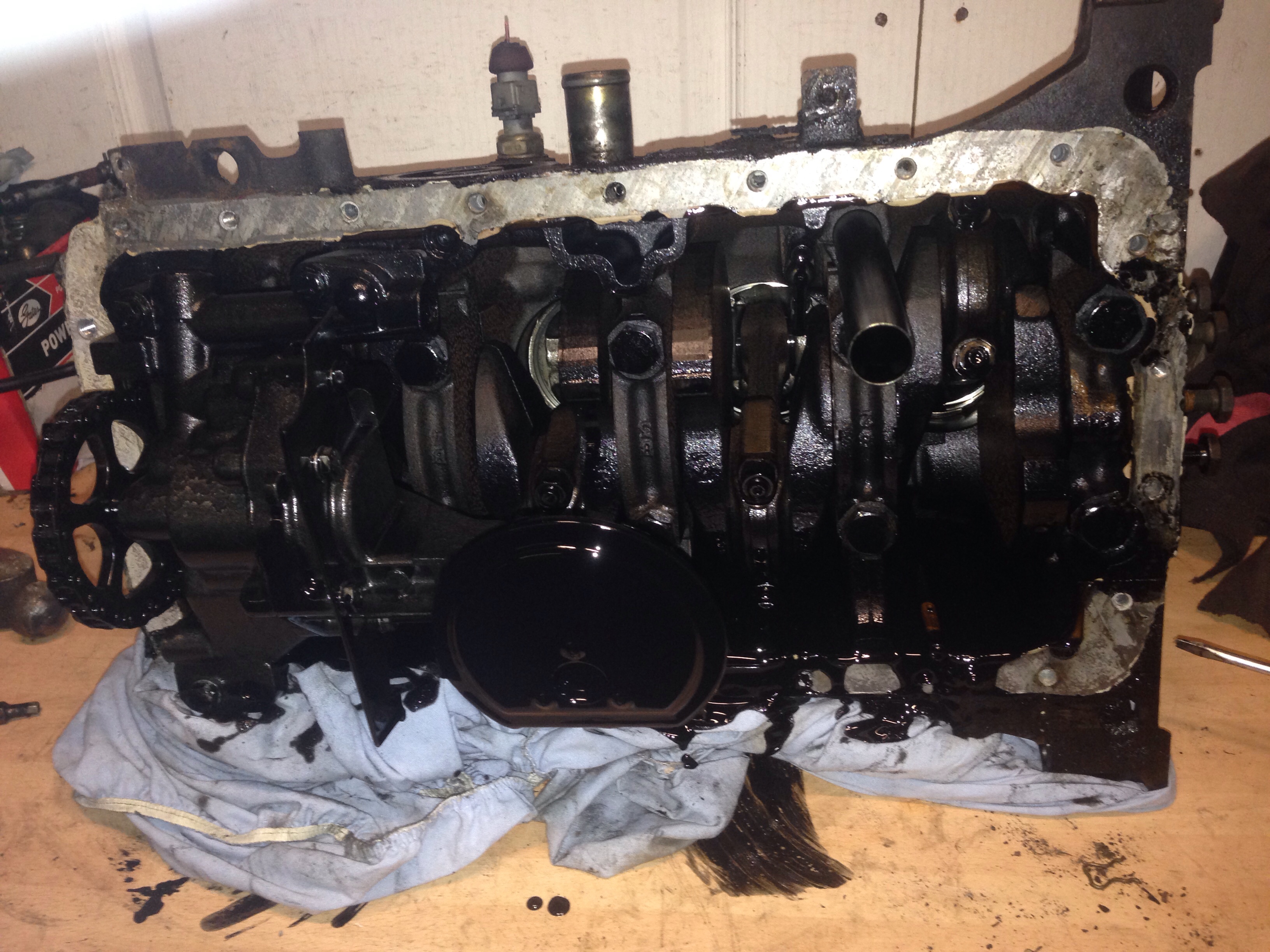

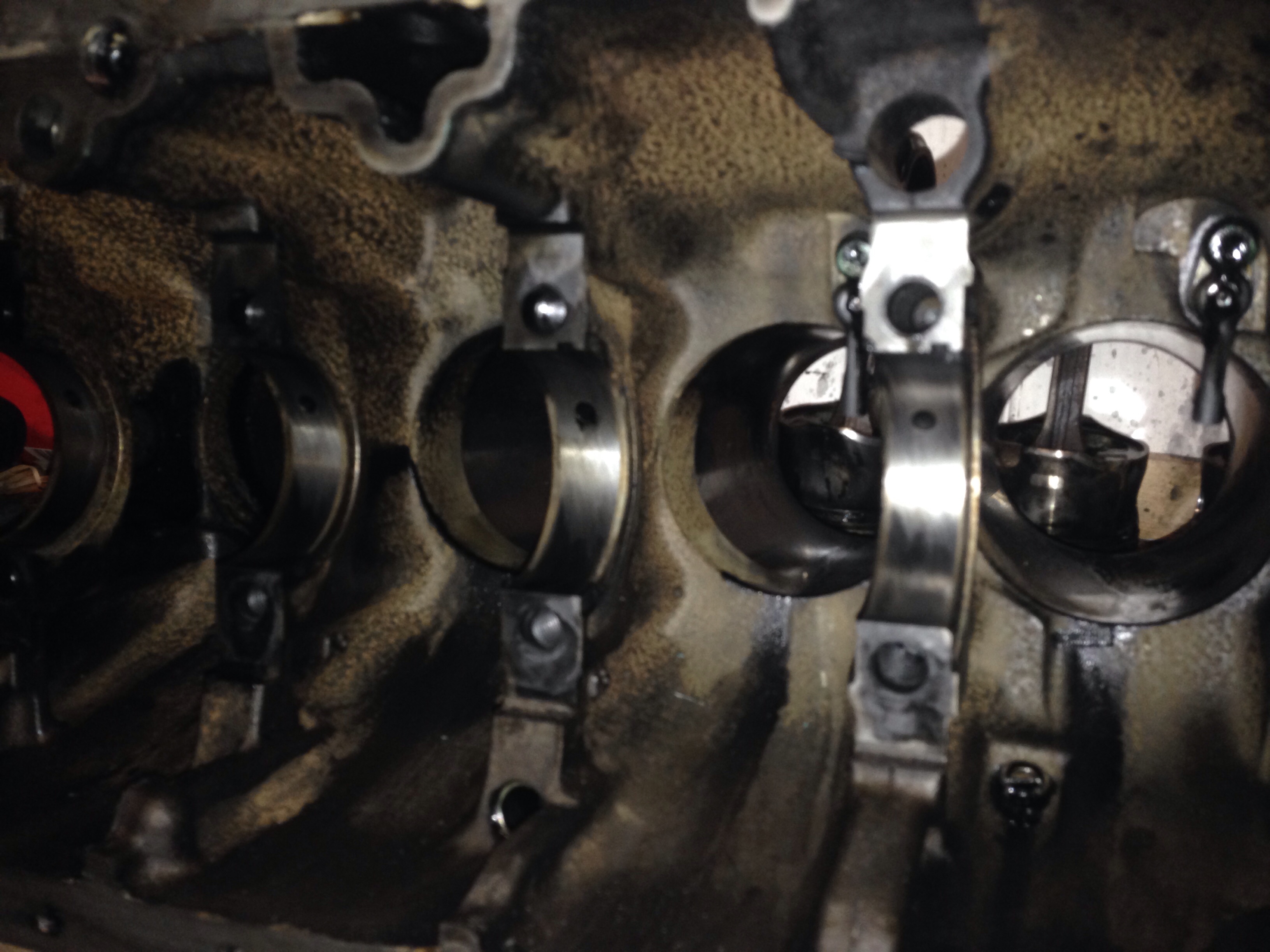

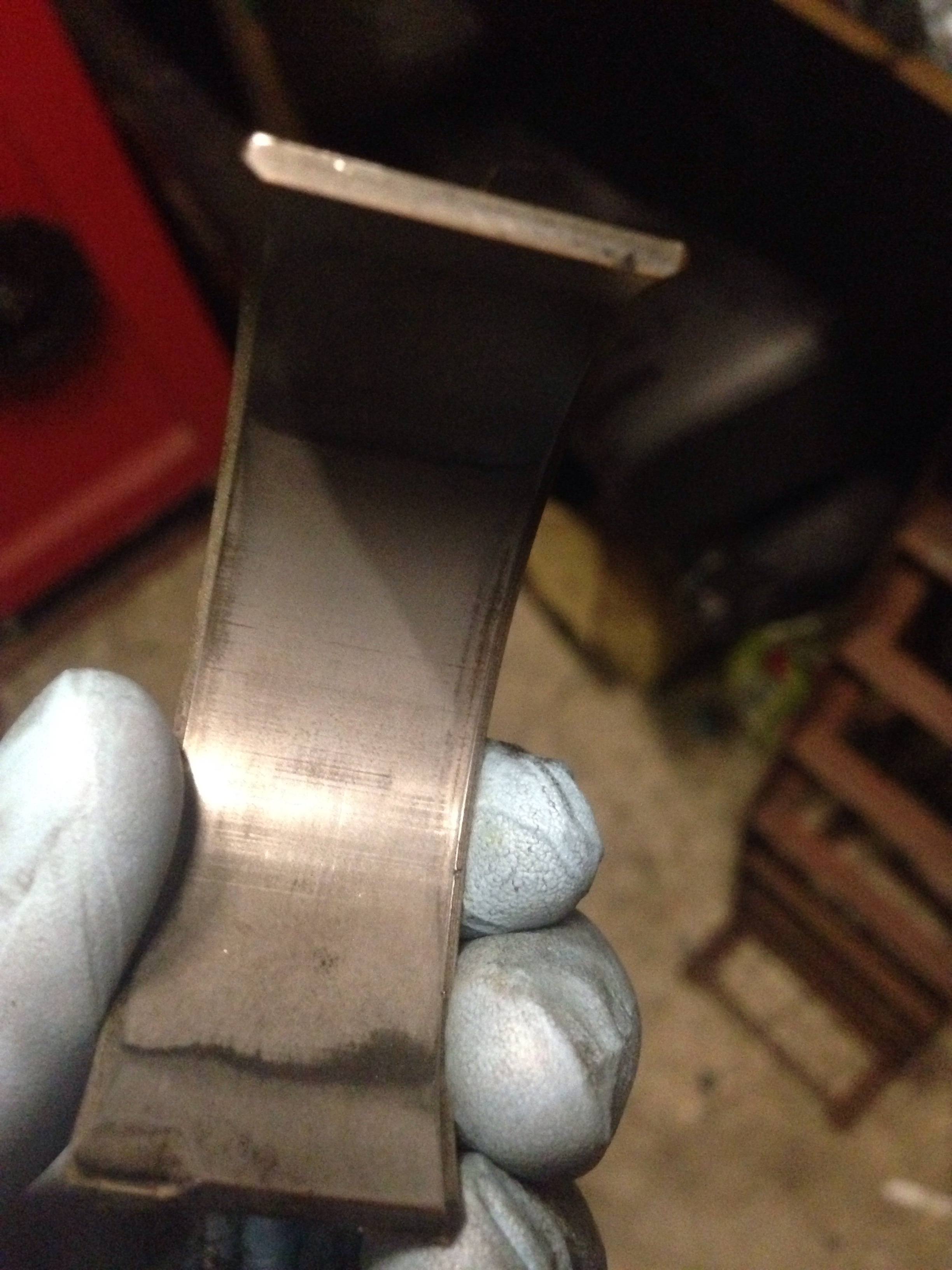

So in order to get some interesting posts up for a change as ive noticed the forum has gona a little quiet as it does time to time. I got into the workshop and began working on this engine. It wont be my usual quick lash together im afraid so bare with.
I stripped down the block today to nothing. Everything apart crank out pistons rods etc to inspect everything. The big ends look a little worn but the mains seem ok to be fair. Plan is to take this to where i used to work and clean it all in the parts cleaner so i can have a nice clean engine to re assemble for a change.
Questions and comments always welcome.

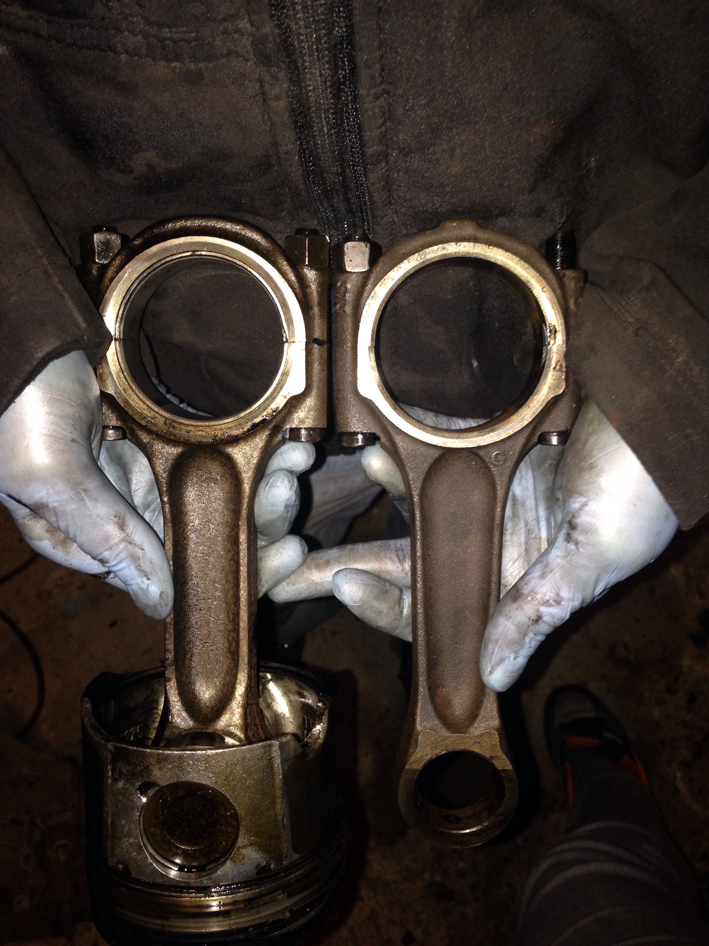

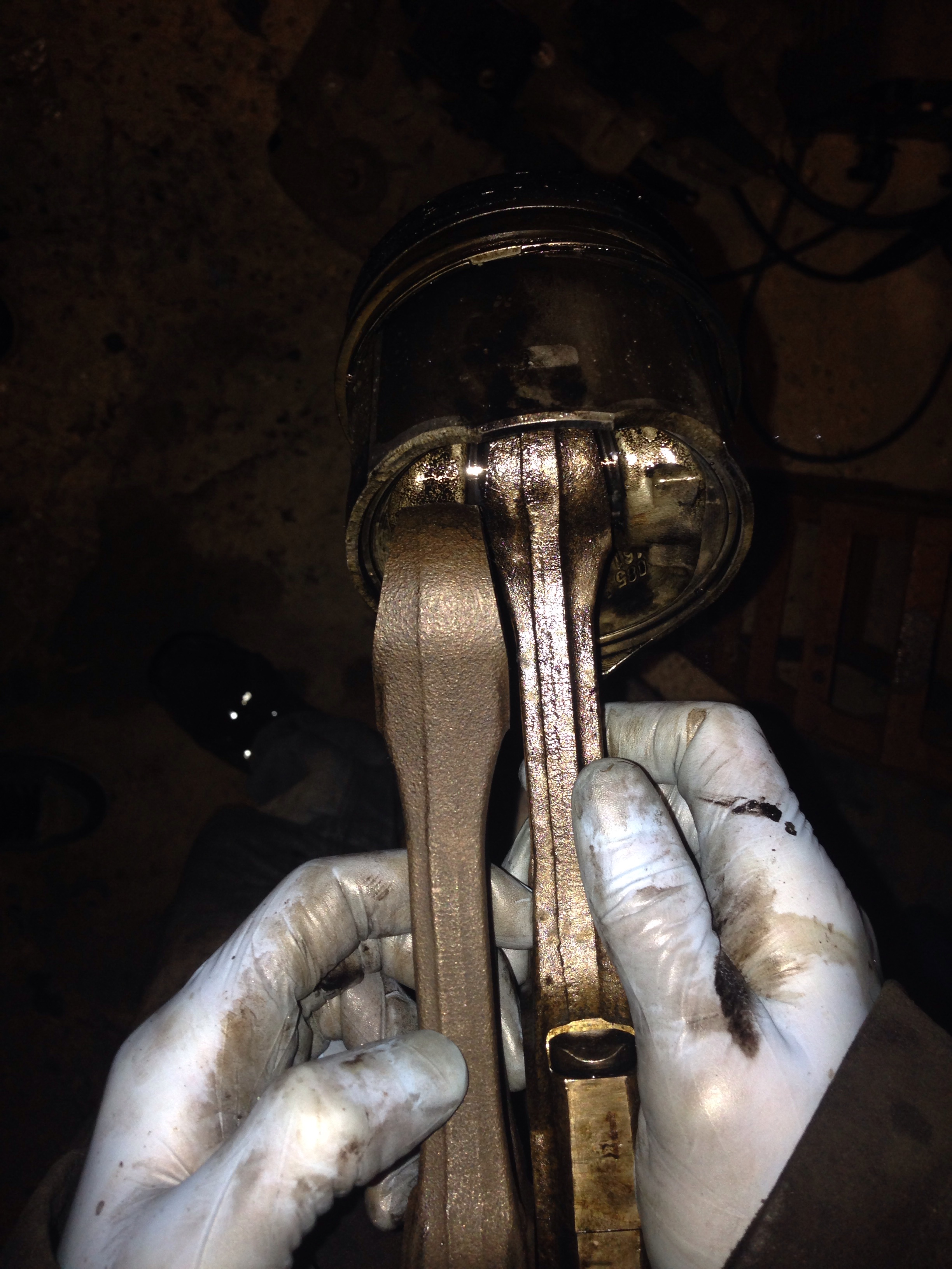

So i cleaned stuff tonight
On another note this is a hdi rod vs the 2.1 rod. Lok around the same apart from 2.1 rod is thicker. Not got any precise measuring equipment to check but you know. Possibility.
also if somebody know a good place to get big end bearing from that would be great
#83
I got mine from my local engine shop, much cheaper than i could find them myself.
#84
Wrist pin fitment is different matey. Plus 16v hdi rods are a direct fit for xud9/dw10 and are thicker than the xud11 and dw12 rods
