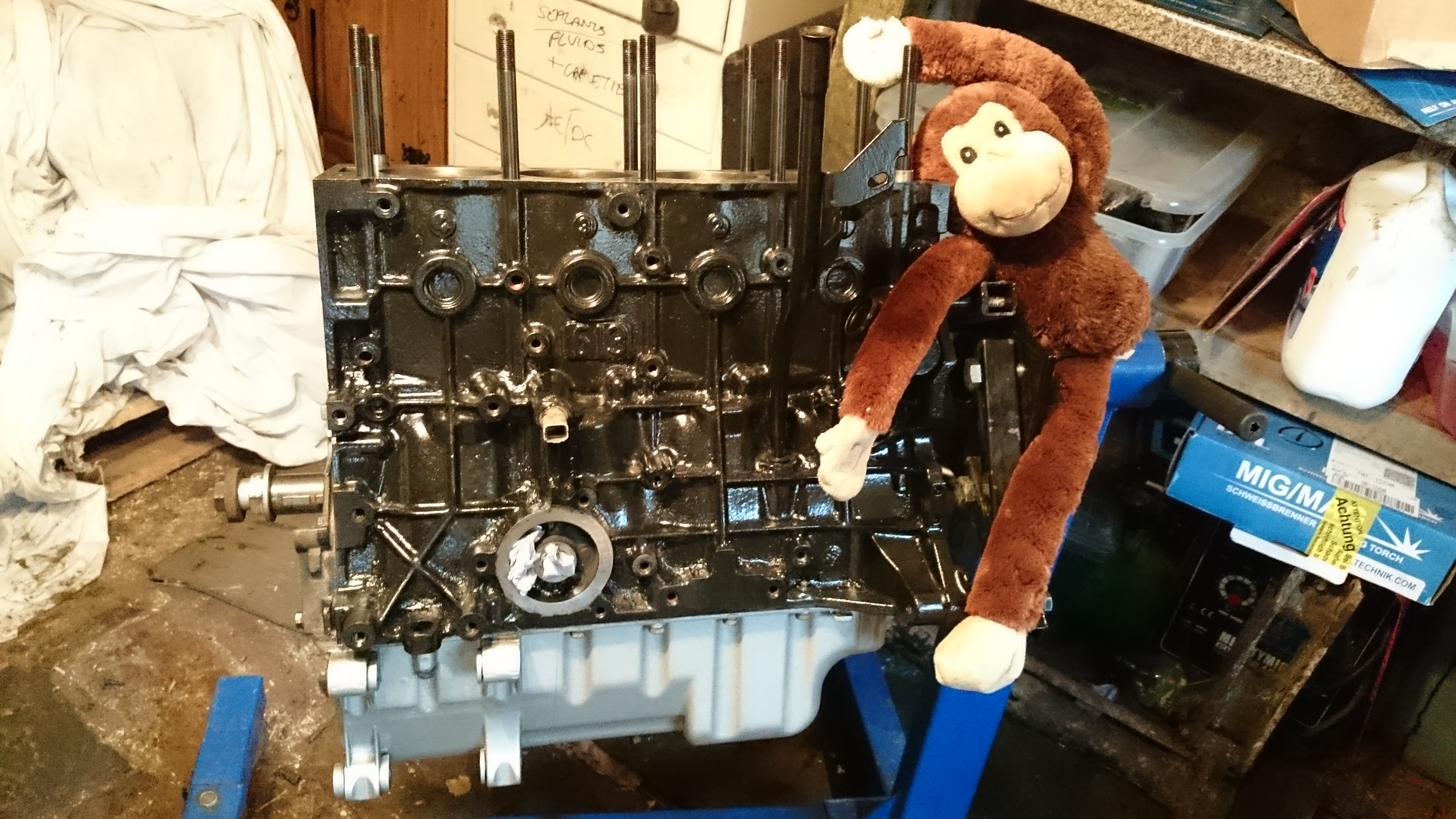

Best get on with this really... Just lack of time.
But got in the shed and took the sheet off it the block.
Honed the bores lightly, didnt need much. Also cleaned the deck and all the flange faces and put a thread die through all the threads. Washed down with cleaner.
Need to clean the headbolt threads out and then can start reassembly finally... Maybe it will get moving then

Crank may go in tomorrow. Valves need lapping...16 of them...keep putting it off
Gotta get it done. Need 16v done... So can do Kev...

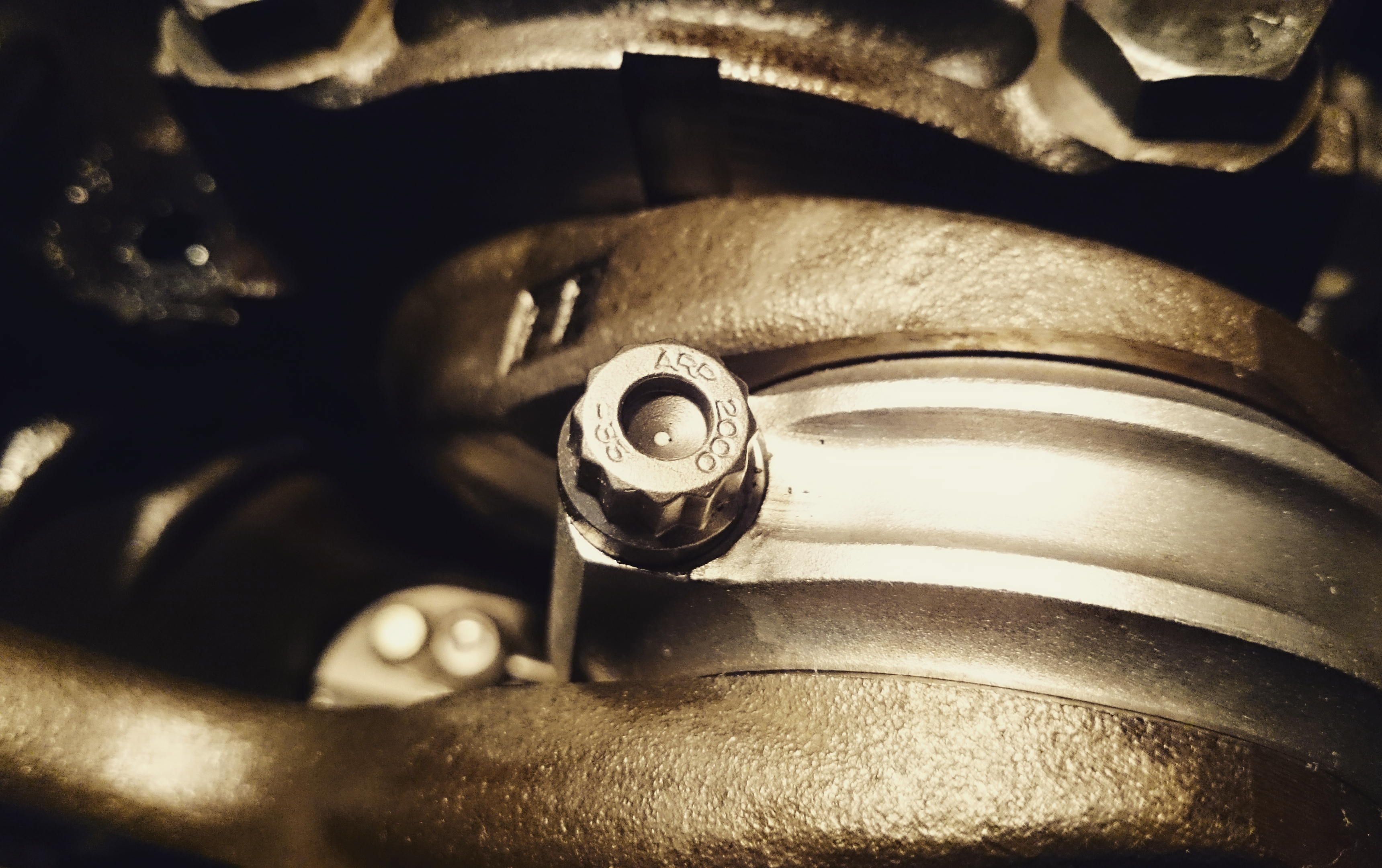

16v pistons, cleaned. New rings. Win rods. Arp bolts. Bearings. Ready to be inserted.

Did those bolts come with the rods?
Posts: 20,092
Threads: 591
Joined: Nov 2012
Reputation:
54
Location: Cotswolds
Thanks: 22
(26-09-2016, 12:00 AM)deggerz Wrote: Did those bolts come with the rods?
Indeedamundo
