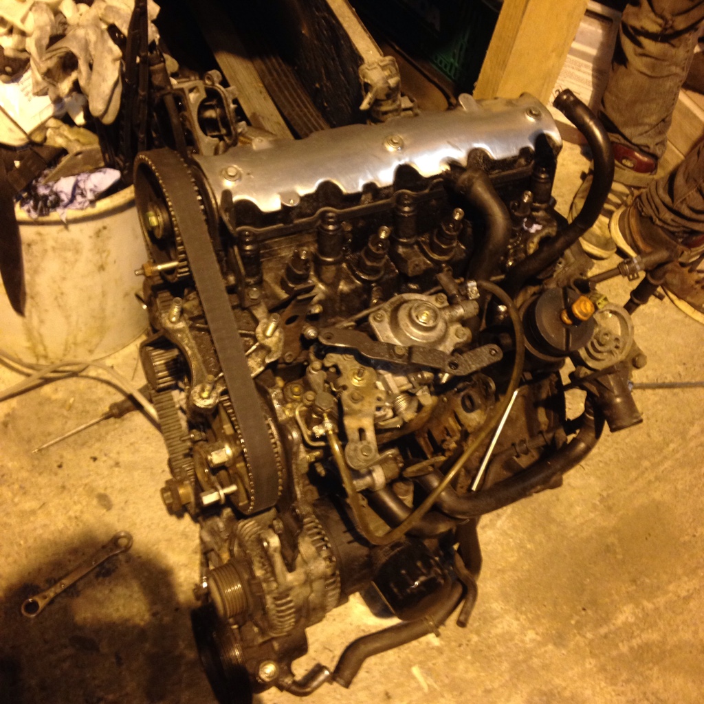

    turbo fitting commencing. Raer mounted not box mounted this time

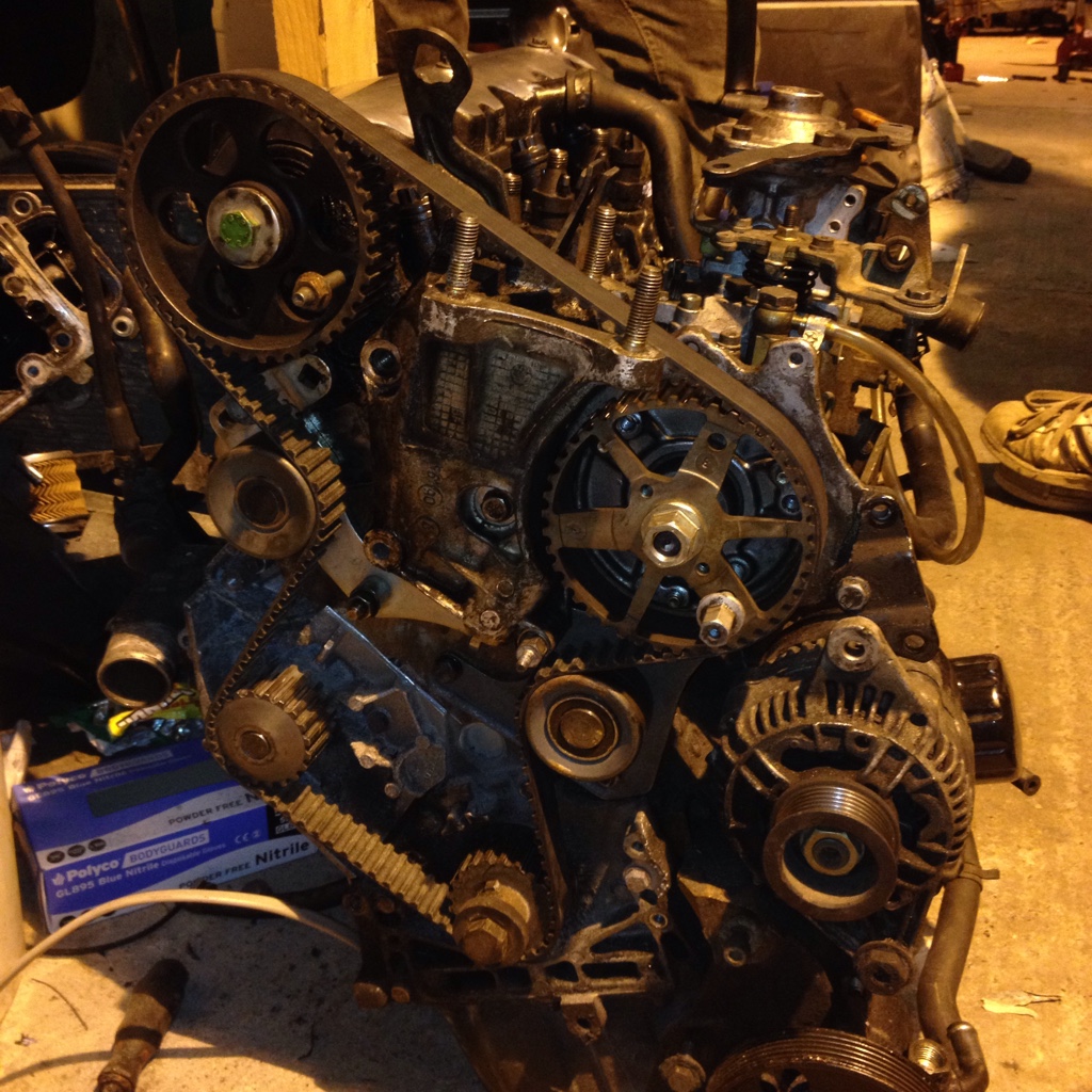

Engines timed up with the 8v head. Have to "modify" the water pump but thats about it. Got the arps in with a mls headgasket. Timed up with a 141 tooth hdi cambelt and xud9 tensioners and engine mount. Heres some pics. Bitches love pics

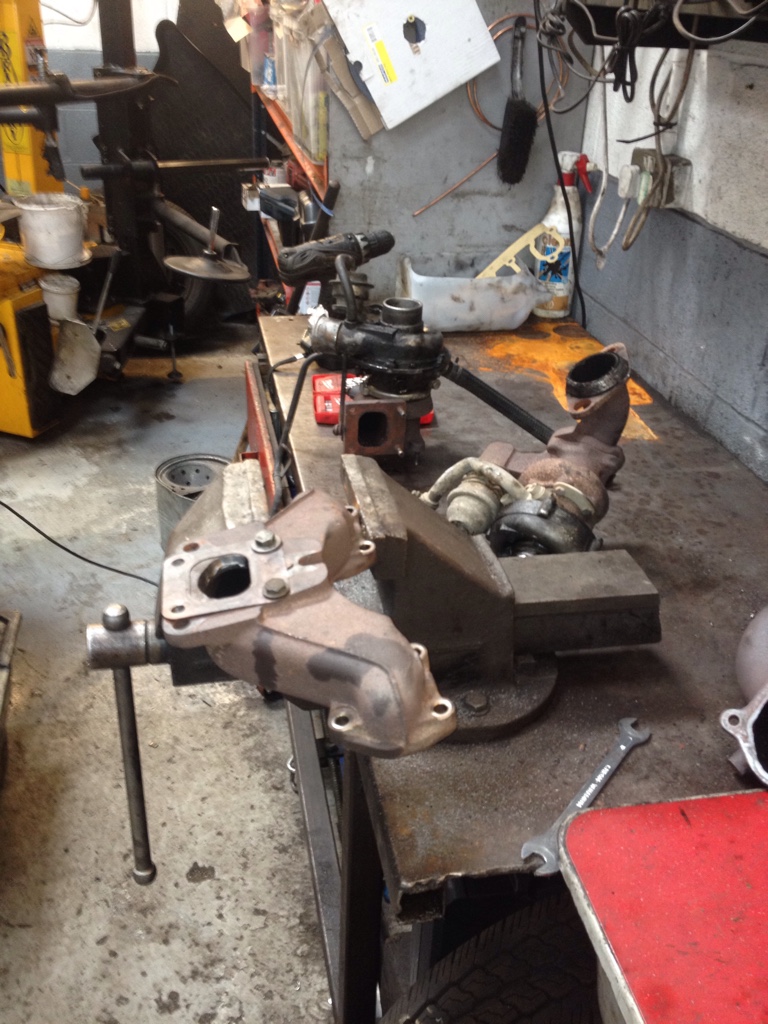

So i mounted my turbo on the manifold at work with no idea if it was gonna fit down the back of this. It just fits! I had to cut a bit off the top of the water housing. I have two. Have chemical metalled the hole for now, the other will get tig welded when i get chance. Wouldve been rude not to stop of at the workshop for 10 mins to see if it fitted though.
Thanks for all the good comments guys Smile hopefully we can push a bot harder and get a first start video on thursday evening.

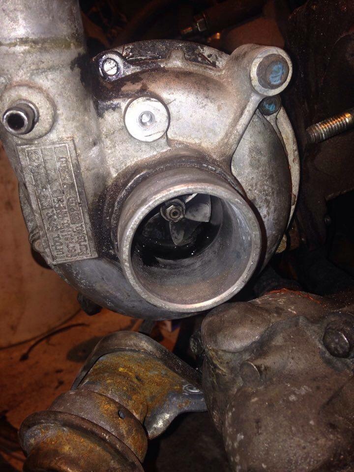

Today i spent a bit of time down the workshop. Fitted the turbo and clocked it to fit a bit better. Will attempt to make the actuator fit when engines in for its teat fit. Times it up with a nice new cambelt. Fitted a new valeo clutch. Fitted injector lines that i had to bend 2 as the 2.1 fill up is slightly different to the 1.9. Not a lot of progress today would've liked the engine in really but hey ho. Ill be up there again Tuesday night i think.

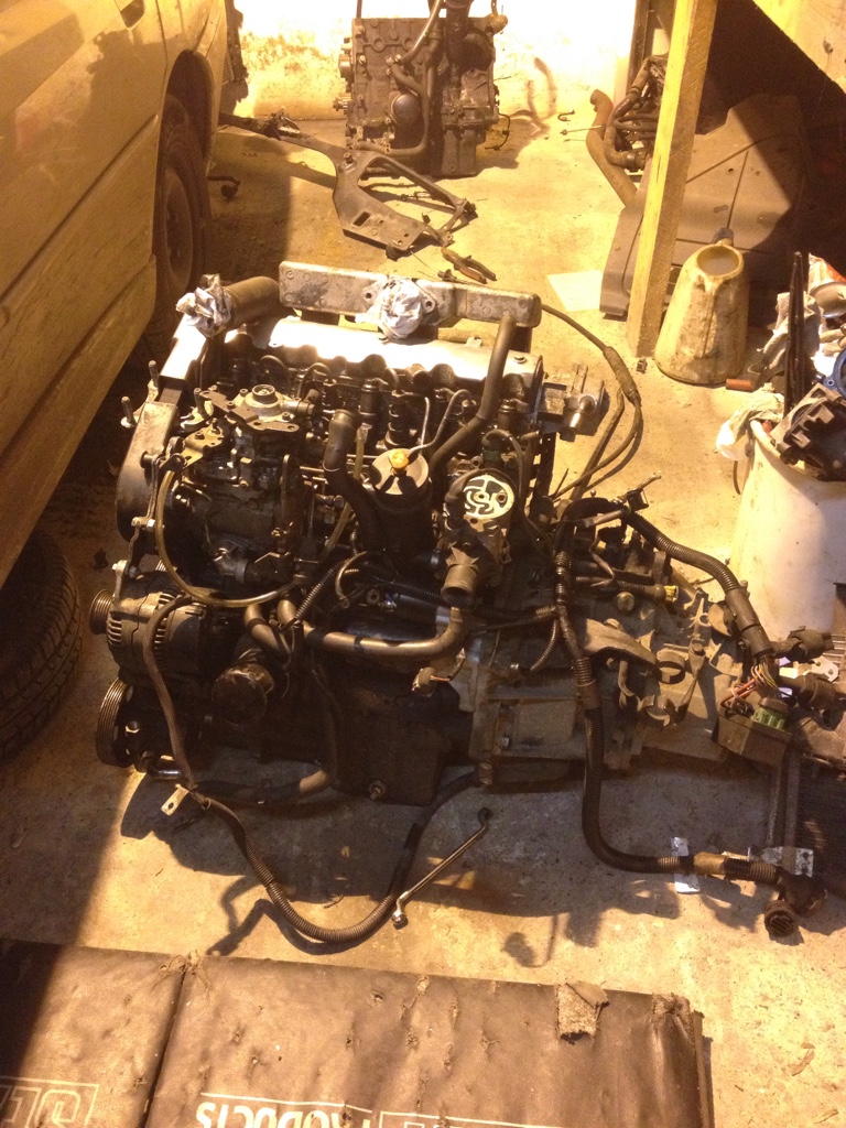

Another push tonight. Ready to drop on its mounts and test fire thursday night. Pick my oil feed up tomorrow as well.

So its running!! Toms306 has the first start video on his phone his going to email it to me to put up. Just got to line the exhaust up tack it into place remove engine. Line up actuator. Put engine back in and build up!! All of the BOOST. Hopefully two weeks from now itll be on the road!!
